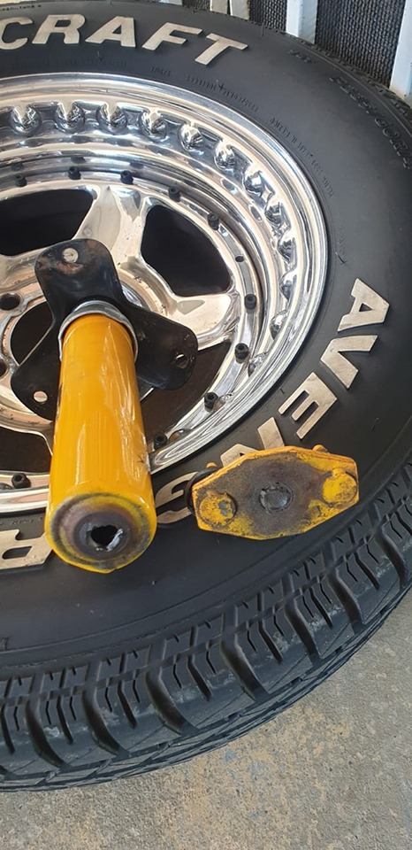

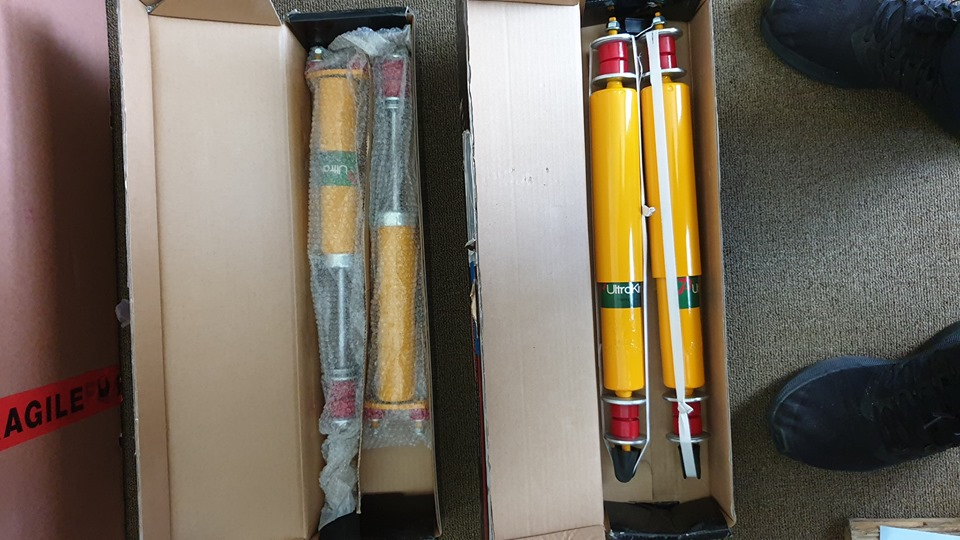

SPArKy_Dave 9,344 Posted October 19, 2019 Beware of the Ultra King brand shock absorber's for our x-series falcons. There are multiple reports, of them randomly shearing off the lower mounting plate - (dodgy manufacturing?) 2 1 CHESTNUTXE, scottly and OLM8 reacted to this Share this post Link to post Share on other sites

2redrovers 21,929 Posted October 19, 2019 Looked like a handful of tack welds holding the top in, caused uneven stresses and the tube fatigued.. Failure. Share this post Link to post Share on other sites

SPArKy_Dave 9,344 Posted October 19, 2019 51 minutes ago, Mr Polson said: Another good reason to shop local and support brick and motor stores... For anyone who might not know, Repco shocks are made by Monroe just with a Repco sticker and better shelf price I wonder how their x-series valving, compares to others? Are they gas or hydraulic? What colour are they painted? From my research, here are some brands which do x-series front shocks - Monroe (Repco?) Koni Bilstein Pedders Gabriel Sachs KYB UltraKing Ultima (same as ultraking?) The following brands, do proper actual shortened/short-stroke x-series front shocks - Koni Gabriel Pedders If anyone has others, please add to the list. 1 gerg reacted to this Share this post Link to post Share on other sites
Crazy2287 1,889 Posted October 19, 2019 Have had an ultra king do this, and the shock oil went all over the spring saddle and away bar bushes and they fell to bits too. An XF ghia had these fitted when I got it. I found the valving the ultra king quite firm, and I like a firm shock. Just this happened. I'm pretty sure Ultima are not ultra king. Ultima come with a very good warranty. Have em in my 4x4 and in the Elgrand. No issues here. And my local suspension mob gave em a solid plug. 2 steve mcqueen and SPArKy_Dave reacted to this Share this post Link to post Share on other sites

broken-wheel 659 Posted January 21, 2020 on the X series the shock/damper is not a stress member so if it fails it's OK, you will know but it won't do anything bad on the E series the shock/damper IS A STRESS MEMBER and if they fail depending on your speed you're fucked but I like the process of natural selection 1 bear351c reacted to this Share this post Link to post Share on other sites
