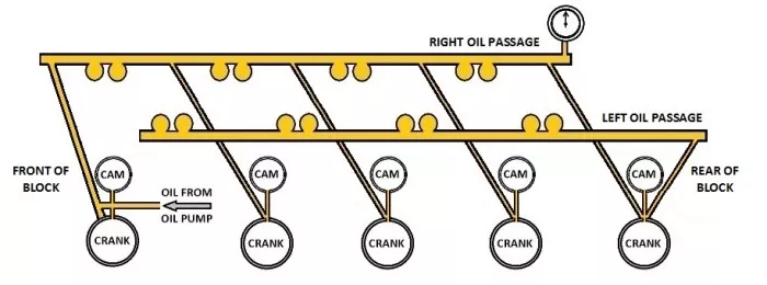

SPArKy_Dave 9,344 Posted August 23, 2020 Make sure you have the correct small-hole lifters for a Cleveland, too. Windsor V8's have priority mains oiling, thus are not fussy with lifters. Clevelands however (and crossflows to my knowledge) are not priority mains oiled from factory, thus require small-hole lifters, to provide correct oil pressure to the main bearings. Windsor lifters will cause a slow internal destruction of bearings in a stock-oiled Cleveland. Windsor/Cleveland lifters are usually all the same HT900 part number. However the Windsor lifters, have a larger oil hole in the side. Be aware!... Design and Performance Issues Every way in which the 351C design deviated from the design of the SBF was to make an improvement, with one exception ... the lubrication system. The SBF utilized three lubrication passages; oil was supplied to the crankshaft main bearings first via a dedicated passage, then at the rear of the block the oil supply was split into two additional passages to supply the two banks of tappets; this is referred to as a main priority system. To save money the 351C was designed with only two lubrication passages, one for each bank of tappets. Lubrication for the crankshaft’s 3 central main bearings was supplied by branches intersecting the same oil passage shared by the right hand bank of tappets. Ford found it necessary to redesign the tappets installed in the 351C due to the large port in the wall of each tappet bore, a result of the way in which the tappet bores intersect the oil passages. Tappets designed for the SBF and 351W allowed too much oil to flow to the 351C valve train. When a 351C equipped with the "wrong" tappets is operated at higher rpm the rocker covers flood with oil while the oil pan is slowly pumped dry at the same time. Thus the 351C has compatibility issues with tappets having certain types of oil metering designs; this also illustrates the importance of limiting the amount of oil flowing to the 351C valve train. Share this post Link to post Share on other sites

dex 2,066 Posted August 24, 2020 3 hours ago, bear351c said: Yeah, basically... think they also had screw in studs for the rocker gear, and screw in welsh plugs (core plugs) on the blocks. Was looking into the oiling system differences ,,, windsors had the oiling system ,, Clevo’s had the breathing with the heads ,, what lifter design /type would be the go ,? 1 CHESTNUTXE reacted to this Share this post Link to post Share on other sites
SPArKy_Dave 9,344 Posted August 24, 2020 17 minutes ago, dex said: Was looking into the oiling system differences ,,, windsors had the oiling system ,, Clevo’s had the breathing with the heads ,, what lifter design /type would be the go ,? Windsor block/rotating assembly = any old Ford D9HZ-6500-A lifters (or HT900 aftermarket equivalent), should work. Share this post Link to post Share on other sites
gerg 10,875 Posted August 24, 2020 Was looking into the oiling system differences ,,, windsors had the oiling system ,, Clevo’s had the breathing with the heads ,, what lifter design /type would be the go ,? Clevos onwards cheaped out with the oiling system. They ran the whole motor on 2 oil galleries that fed the left side of the lifters with one plus the mains and cam, the other crossing over and feeding the right lifter bank. 302 and 351Ws have 3, which by many accounts have been more than adequate. The problem is, the crank oiling requirements are actually greater with clevos, having 2.75" mains vs 2.25" for 302Ws, making the oil feed problem worse. The final contributor to this is that Clevos breathe well, meaning they like a rev. So crank journal surface speed is higher, rpm is higher, and oil is less plentiful. They also have a pissy sump capacity: 4.5 lites, meaning if a lot of oil gets to the top of the motor, the oil pump gets starved. Many modern 4 cylinders take as much oil as clevos used to.So they apparently spin #4 or 5 bearing when having a good go.There are ways of restricting the oil to one of the lifter galleries, which diverts more to the mains. It involves drilling and tapping a screw-in orifice up inside one of the oil feeds to the galleries.Another less-involved mod was to run an external line from the blanked-off oil port just near the fuel pump (oil comes straight out of the oil pump there) around to the oil pressure sender port at the back of the valley, to feed oil straight to the back of the motor.So... A Windsor bottom end would be better-oiled, lighter, smaller, have more parts readily available and be less costly, and if you get an earlier block, will be stronger in the bores than a Clevo. It's tempting to go and bolt on a set of Clevo heads but the reality is that there is a ridiculous amount of Windsor heads out there now that will flow and perform as good as a set of clevos for much less outlay, with all the other bolt-ons and valvetrain components being cheaper as well. Heads are also smaller and more compact than those on a Clevo.The boss heads would look tops, but you don't drive down the road with your head under the bonnet admiring your mad engine bits. Sent from my CPH1920 using Tapatalk Share this post Link to post Share on other sites
bear351c 10,433 Posted August 24, 2020 Or you could install the lifter bore bush kit in the Clevo. Involves machine work, but, should fix the problem for good. Wonder how much the TMeyer blocks are going for.. They apparently solved all of this with a new casting. 1 CHESTNUTXE reacted to this Share this post Link to post Share on other sites
