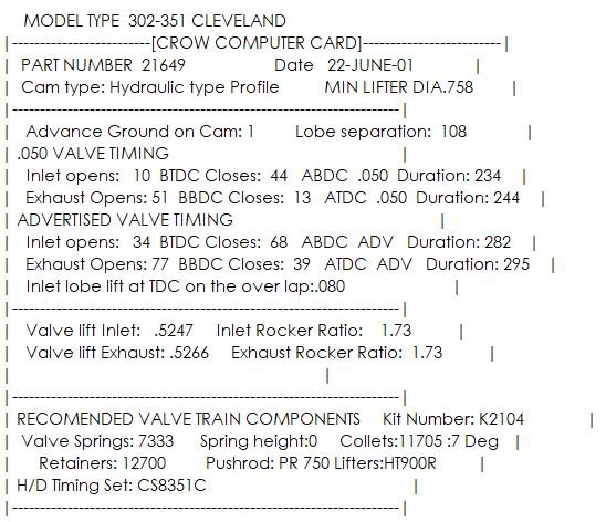

howard2121 9 Posted December 17, 2021 Thanks Greg, Appreciate your input. Regarding Compression I have read your previous posts on this but lack the confidence too say my working-out is correct. I have contacted crow cams with some figures and they recommended Crow Cam - 21649 Hydraulic (see attachment) What is the "magic" compression number...and how does one achieve it.. I have read a common mod for the 2V CC head is to fit 4V exhaust valves obviously this is to increase flow. Is it a value added mod? At this stage my block is at the machine shop and has been bored to 4.030 (block from an XD Ghia). I will also fit MSD (or similar) ignition and I have a Edelbrock 2V performer manifold on the way (a lot of parts are in low supply atm). 1 bear351c reacted to this Share this post Link to post Share on other sites

howard2121 9 Posted December 17, 2021 Hi Bear, Thanks for your input as well, Sorry about the message and then the addition of the topic, Greg doesn't accept direct messages lol, added the topic hoping he would answer. Greg, 3500rpm on the highway no thanks. I will need to revisit the cam. Great input, I really appreciate it. 3 3 bear351c, scottly, gregaust and 3 others reacted to this Share this post Link to post Share on other sites
deankxf 21,117 Posted December 17, 2021 22 minutes ago, howard2121 said: 3500rpm on the highway no thanks. I will need to revisit the cam. diff ratio dictates the revs at 100kmh see below. 7 hours ago, howard2121 said: Car will be 4 speed toploader and 9 inch diff 3:75 ratio is it a 3.75 ratio diff ? 2.75 is the highway standard standard gears most LTDs etc got, they'd have you doing about 2250rpm at 100kmh. (make sure the cam choice is ok to cruise on that if so) 3.7 (not 3.75) would be doing about 3000ish from My calculations at 100kmh. your 3.75 number doesn't sound anything i've heard before. so probably should confirm what it is. 1 gerg reacted to this Share this post Link to post Share on other sites

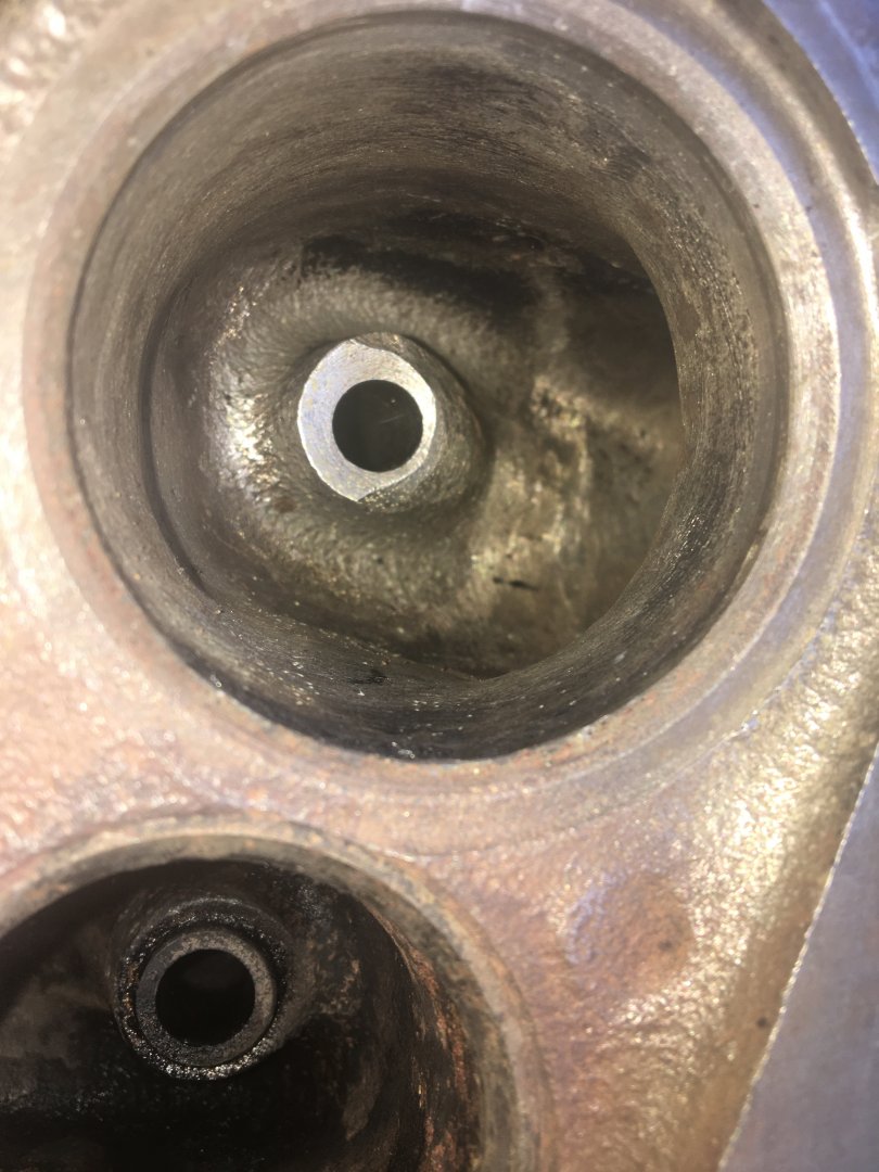

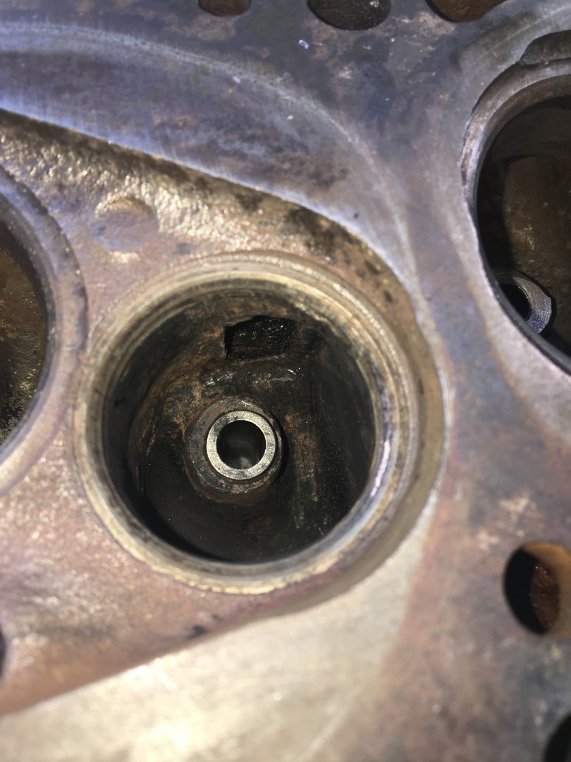

howard2121 9 Posted December 19, 2021 So.. I got my heads out and pulled them apart. good news is they have already been ported. Regarding the photo of the exhaust bowl is the hole supposed to be there? Share this post Link to post Share on other sites
Thom 6,710 Posted December 19, 2021 So.. I got my heads out and pulled them apart. good news is they have already been ported. Regarding the photo of the exhaust bowl is the hole supposed to be there?That hole is for the exhaust srossover that runs under a stock intake for manifold heating/egr valve, if you're using an aftermarket intake they will be blocked off 1 Outback Jack reacted to this Share this post Link to post Share on other sites
gerg 10,875 Posted December 19, 2021 So.. I got my heads out and pulled them apart. good news is they have already been ported. Regarding the photo of the exhaust bowl is the hole supposed to be there?Looks like a very light tidy up, only taking off sharp edges around the bowl, short turn and guide. Still, an improvement on stock for sure. Sent from my CPH1920 using Tapatalk 1 Outback Jack reacted to this Share this post Link to post Share on other sites
