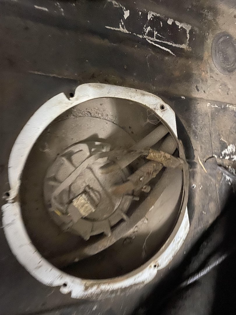

fotz 25 Posted August 17, 2021 Hi all, was having a look at my fuel tank today and I am a little confused... To be honest, first time mucking around with this. The tank looks very similar to EFI. Does anyone know the differences? Could I not just get an EFI fuel pump and cradle from another XF or wont it fit? Or can I modify the existing one and turn it into an electic pump? Is it already an electric pump? Note, this is a XF 87 falcon. Assume this is not an electric pump, and the wiring is just for the sender? Share this post Link to post Share on other sites
deankxf 21,128 Posted August 17, 2021 3 hours ago, fotz said: Hi all, was having a look at my fuel tank today and I am a little confused... To be honest, first time mucking around with this. The tank looks very similar to EFI. Does anyone know the differences? Could I not just get an EFI fuel pump and cradle from another XF or wont it fit? Or can I modify the existing one and turn it into an electic pump? Is it already an electric pump? Note, this is a XF 87 falcon. Assume this is not an electric pump, and the wiring is just for the sender? the HOLE for the pump/sender assy is smaller on the carby tank so the swirl pot from EFI won't fit in there. you could strap an efi pump to what's there but it won't have the swirl pot, also the EFI tank is bigger (wider) holds more fuel, (unless the carby one is from a carby fairlane/s pack, ghia etc. ) Share this post Link to post Share on other sites
fotz 25 Posted August 18, 2021 18 hours ago, deankdx said: the HOLE for the pump/sender assy is smaller on the carby tank so the swirl pot from EFI won't fit in there. you could strap an efi pump to what's there but it won't have the swirl pot, also the EFI tank is bigger (wider) holds more fuel, (unless the carby one is from a carby fairlane/s pack, ghia etc. ) Thanks @deankdx Its an XF Spack. Does this mean I can just use the carby tank - and just use an EFI pump with cradle? Or are you saying the tank is just bigger in capacity and thats it? I an trying to source an EFI tank. I think I have found one. It comes with the cradle, but its missing the sender. Apparently these are hard to come by. Any ideas around this or alternatives? I am looking at changing the gauges anyway, to saas gauges, I was thinking I could fit an saas sender to the cradle? Share this post Link to post Share on other sites
deankxf 21,128 Posted August 18, 2021 27 minutes ago, fotz said: Thanks @deankdx Its an XF Spack. Does this mean I can just use the carby tank - and just use an EFI pump with cradle? Or are you saying the tank is just bigger in capacity and thats it? I an trying to source an EFI tank. I think I have found one. It comes with the cradle, but its missing the sender. Apparently these are hard to come by. Any ideas around this or alternatives? I am looking at changing the gauges anyway, to saas gauges, I was thinking I could fit an saas sender to the cradle? S pack carby tank is same size as the efi tanks(68litres i think) (the base model was closer to 50L) if you remove the current fuel tank sender unit you'll see it has a pick up screen on a pipe where fuel gets sucked from. you could possibly fit a small efi pump on that sender unit and run it as it is, it would be very tight to fit a universal fuel gauge sender in there ALSO . ** the EFI tank has a bigger opening, with a swirl pot built into the fuel pump holder, it's probably not essential, but it would be better. due to the bigger opening, it makes it easier to add a universal sender for aftermarket gauge also.. i'll draw you a pic 1 fotz reacted to this Share this post Link to post Share on other sites
fotz 25 Posted August 18, 2021 Thanks @deankdx - your a legend mate. So useful Ive just tracked down an EFI tank, and I have got the pump as well Looks like the much cleaner option. Should i upgrade the pump for the AU, while its out, if so what do you guys recommend as easy replacement? For the fuel lines I was thinking of using the existing feed line pipe as the return, and creating a new feed line. Not sure exactly what size, and also what's the best product to use yet. 1 deankxf reacted to this Share this post Link to post Share on other sites
deankxf 21,128 Posted August 18, 2021 10 minutes ago, fotz said: Thanks @deankdx - your a legend mate. So useful Ive just tracked down an EFI tank, and I have got the pump as well Looks like the much cleaner option. Should i upgrade the pump for the AU, while its out, if so what do you guys recommend as easy replacement? For the fuel lines I was thinking of using the existing feed line pipe as the return, and creating a new feed line. Not sure exactly what size, and also what's the best product to use yet. when i did the lexus V8(180kw ish) into XE i used both existing lines fuel and return, and the XF efi fuel pump (new though) was put on the dyno to make sure it kept up and was confirmed fine (approx 140rwkw) i would assume a windsor from AU would be fine with both, but you probably should check it(i used to have a good dyno tuner i could ask to verify, but no idea these days) Share this post Link to post Share on other sites

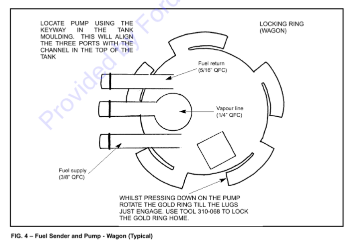

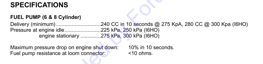

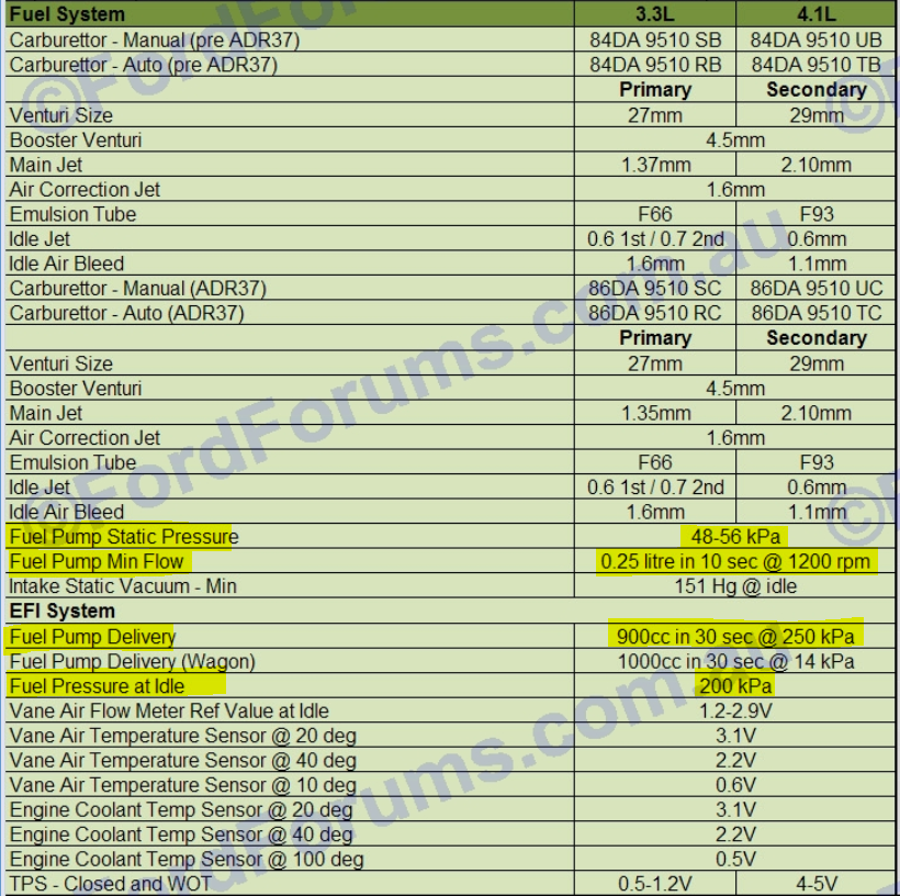

fotz 25 Posted August 19, 2021 Ok I got my hands on an AU workshop manual - it shows the pump sizes fittings, I would presume the hose would be the same: I cant locate an XF manual to see what Carby has - but I know mine has a return line, which is good. Just not sure of the sizes exactly. In regards to fuel pressures, I did find the following for the XF: And the AU falcon pump specs: So if i read this correctly. There are very close, but AU pump looks slightly stronger. Not sure what what (I6HO) is? So to be safe it might be better to go with a stonger pump. Share this post Link to post Share on other sites
deankxf 21,128 Posted August 19, 2021 33 minutes ago, fotz said: Ok I got my hands on an AU workshop manual - it shows the pump sizes fittings, I would presume the hose would be the same: I cant locate an XF manual to see what Carby has - but I know mine has a return line, which is good. Just not sure of the sizes exactly. In regards to fuel pressures, I did find the following for the XF: So if i read this correctly. There are very close, but AU pump looks slightly stronger. Not sure what what (I6HO) is? So to be safe it might be better to go with a stonger pump. i'd use the pump designed for the engine if i was choosing. so AU engine with AU fuel regulator. i'd use an AU fuel pump. 1 fotz reacted to this Share this post Link to post Share on other sites
fotz 25 Posted September 6, 2021 Hi All Just providing some updates below for anyone interested in. Fuel I got an EFI tank including pump and cradle. This currenlty has 5\16" connections for fuel and return. As the AU falcon has a 3\8" I am going to move to this, will need some of 5\16" to 3\8" adaptor from pump to line. Also need to sort out quick connections on the motor. Will get this from TI performance as thats where I am getting the pump from. Diff I also sourced a diff from an EF falcon XR6. 3.45 lsd. So I will be doing a conversion to this. Have got the brake line adaptor. I have found few places that will do the handbrake cable for me as well, will share details when I get this done. I know I have to sort out the bushes on the arms as well for this, so will let you all know what the best solution was for this as well. ECU\Harness I am going to run the stock AU ECU with the ECU Harness. I went with the rod shop, who can modify the AU harness to fit the XF and provide step by step intructions for the install. Also getting a J3 chip from TI performance as well. So waiting for this to come in. Gearbox This one is hard. The v8 box is impossible to find and really expensive. So I currently have an XF falcon 5 speed, which I believe are pretty weak. The rod shop currently have bellhousing that can adapt the shorter input shaft of a 6cyl gearbox to the windsor motor. I am thinking of going with an E series manual t5 gearbox. Anyone done this before and is it reliable? I know the ratios are different in the box as well, but keen to get some feedback around this? Also does anyone know if the XH ute gearbox is the stronger e-series box, or is the same t5 from the XF? Also is the steel tailshaft from a ute the same as the sedan? Will keep you all posted on all of the above as I get more updates 1 motoSycho reacted to this Share this post Link to post Share on other sites
