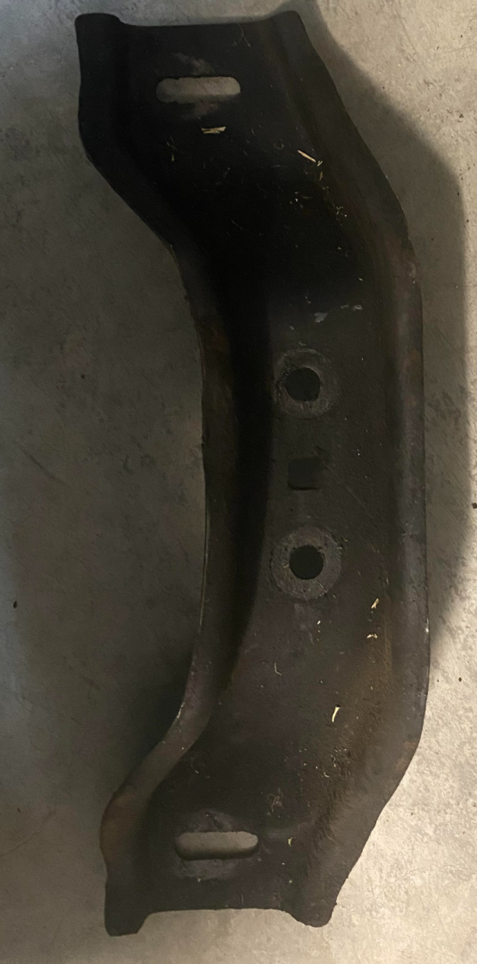

fotz 25 Posted October 19, 2021 Thanks @deankdx I had a very quick skim through those previous posts and I believe these related to modifying existing housings and also relate to Clevo not windsort. Just noting, I currently have an XF T5 gearbox at the moment, so I have the bellhousing for 4.1, tailshaft and cross member. See photo below of crossmember. It should match exactly what you have said above. It would match the CRS one a well right? I guess my question is with the Ford AU Windsor motor, if I go with the CRS bell housing are you saying I could then run the tailshaft from an XA-XE V8 ? Existing cross member from XF will fit, and I wont have issues with the shifter either? OR is it better to go with the V8 bellhousing from a XH or e-series (will step gearbox further back 26mm) and add a longer input shaft to the t5 - or does this not work either? I guess the big question is what is the impact of the 26mm difference in the input shaft and what role does this play on the XF? Is the back of the windsor motor in the same place as the back of 4.1 crossflow? If so, then the CRS bell housing is the way to go. If not then I am seeing issues with the shifter maybe (26mm off or viceversa) I dont believe the clevo and windsor is mounted in the same spot. As we know that if you try to mount a clevo in the XF, the heater pipes get in the way. But I could be wrong. I am probably overthinking this.. so please let me know if I am crazy here. Share this post Link to post Share on other sites
deankxf 21,128 Posted October 19, 2021 47 minutes ago, fotz said: I dont believe the clevo and windsor is mounted in the same spot. As we know that if you try to mount a clevo in the XF, the heater pipes get in the way. But I could be wrong. I am probably overthinking this.. so please let me know if I am crazy here. @Thom can you read the post above and see what pops out...or tag anyone who might know the difference between clevo an windsor flywheel, and where the engine sits in the bay related to the heater pipes(dictated by the engine mounts) is the left bank staggered forward on the windsor and vice versa on the clevo? what makes them not fit usually? i don't know. @fotz i'll reply in each of the above separately. 51 minutes ago, fotz said: I had a very quick skim through those previous posts and I believe these related to modifying existing housings and also relate to Clevo not windsort. yes, the windsor is rarely chosen into X series. i just remembered @ashXFute has the windsor in XF but auto though, might be able to share some more answers related to firewall position/heater hose clearance.. thread here 55 minutes ago, fotz said: Just noting, I currently have an XF T5 gearbox at the moment, so I have the bellhousing for 4.1, tailshaft and cross member. See photo below of crossmember. It should match exactly what you have said above. It would match the CRS one a well right? yes the XF T5 mount should mount the 6cyT5 in the right spot on a clevo/CRS bell housing into XE XF .. i don't know about the EB to XH bell housing/V8 box though. have you tried contacting CRS? they may have these answers. they may not also. 57 minutes ago, fotz said: I guess my question is with the Ford AU Windsor motor, if I go with the CRS bell housing are you saying I could then run the tailshaft from an XA-XE V8 ? Existing cross member from XF will fit, and I wont have issues with the shifter either? in My opinion, (not sure) the windsor should put the gear stick in the same spot as a clevo. (if so, then XF 6cyl tail shaft will work etc on a CRS bell housing) CRS may know the answer, try calling them. 59 minutes ago, fotz said: OR is it better to go with the V8 bellhousing from a XH or e-series (will step gearbox further back 26mm) and add a longer input shaft to the t5 - or does this not work either? see above reply, 26mm further back if it ends up there is right in the brace for the bucket seat reinforcing .. so you don't want to be there unless the windsor actually does mount further forward? something to confirm/check with CRS etc or AshXFute may be able to check? 1 hour ago, fotz said: I guess the big question is what is the impact of the 26mm difference in the input shaft and what role does this play on the XF? also see previous answer, if it does put the stick further back, thats into the seat brace reinforcing. i'm sure an engineer would want some reinforcing if it was cut into.. and then you'd need a shorter tail shaft if so i would think(assuming the mounting face to extension housing of a V8 T5 is otherwise identical, then also the T5 cross member may not reach this far back(there's some adjustment, not as much as the Mal Wood one above.. perhaps call Mal Wood also. (i Hear he's a busy man, so try to get your questions simple for a short call) 1 hour ago, fotz said: Is the back of the windsor motor in the same place as the back of 4.1 crossflow? If so, then the CRS bell housing is the way to go. If not then I am seeing issues with the shifter maybe (26mm off or viceversa) I dont believe the clevo and windsor is mounted in the same spot. As we know that if you try to mount a clevo in the XF, the heater pipes get in the way. But I could be wrong. I am probably overthinking this.. so please let me know if I am crazy here. this i don't know. if the difference Clevo to Windsor is how the left bank cylinders are staged, then the bell housing face and engine mounts could be identical? i thought this was the reason the windsor heads cleared the heater. can't confirm sorry, i'd call CRS first, if they are unhelpful i'd be surprised. you could mention if they don't mind you can put the info into the Ozfalcon.com.au forum with a mention of their advice (for future enquiries/sales) they may spend more time thinking about it than otherwise. (the last time i rang CRS, Rod Hadfield was still there, that was long ago. ) 2 ashXFute and fotz reacted to this Share this post Link to post Share on other sites
