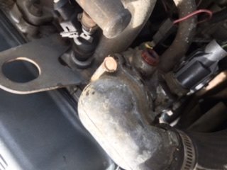

Jay Baby 21 Posted March 29, 2020 Iv been reading up and I think you’ve got it... the thermostat must be stuck open as the car never gets hot. It literally never even makes it very much passed the start line of the “normal” part of the temp gauge. If it has a thermostat? I’m just trying to find it now. If it does and it’s stuck open is that a WD-40 kind of thing or should I replace it? First I need to find it I guess Share this post Link to post Share on other sites

Jay Baby 21 Posted March 29, 2020 Found a few thermostats on eBay and they pretty cheap, I might just change it anyway. At least if I do that I know it’s sweet and not stuck open as I’m more worried about that now than fuel consumption but if it helps with fuel that’s a bonus. But yeah the Ute never gets hot at all and I’m actually thinking you must be right about it being stuck open Share this post Link to post Share on other sites
Jay Baby 21 Posted March 29, 2020 Sorry to keep bothering you deankdx but if my thermostat is actually stuck open what problems can this cause? Apart from fuel economy? I will definitely replace but probably can’t do it straight away. Obviously it’s not as bad underheating my car than overheating but can I cause more damage with a stuck open thermostat? Share this post Link to post Share on other sites
Jay Baby 21 Posted March 29, 2020 Either that or the previous owner has had it stuck shut and just removed it? As the gasket glue looks pretty crappy and home job done. I think I’m just going to replace it... 2 Outback Jack and gerg reacted to this Share this post Link to post Share on other sites

bear351c 10,433 Posted March 29, 2020 1 hour ago, Jay Baby said: Sorry to keep bothering you deankdx but if my thermostat is actually stuck open what problems can this cause? Apart from fuel economy? I will definitely replace but probably can’t do it straight away. Obviously it’s not as bad underheating my car than overheating but can I cause more damage with a stuck open thermostat? No mate. Not really an issue. You may find your oil is sludgy, under the rocker cover, when you pull it down, as the oil is designed to run at high temp. Change your oil and filter when you get a spare $50. You computer will try to compensate, as Dean said, by thinking the engine is cold, and adding more fuel to richen it up. Temp gauge should be a third to half way up when fully warmed up. If you run without a thermostat, you may actually 'overheat' your engine. (coolant travels too quickly through the radiator, and doesn't have time to cool down, basically) 2 gerg and Outback Jack reacted to this Share this post Link to post Share on other sites
Jay Baby 21 Posted March 29, 2020 3 minutes ago, bear351c said: No mate. Not really an issue. You may find your oil is sludgy, under the rocker cover, when you pull it down, as the oil is designed to run at high temp. Change your oil and filter when you get a spare $50. You computer will try to compensate, as Dean said, by thinking the engine is cold, and adding more fuel to richen it up. Temp gauge should be a third to half way up when fully warmed up. If you run without a thermostat, you may actually 'overheat' your engine. (coolant travels too quickly through the radiator, and doesn't have time to cool down, basically) No worries Rocker cover gasket needs replacing anyway so when I do that I’ll do thermostat, oil and filter too. Cheers bud 1 Outback Jack reacted to this Share this post Link to post Share on other sites
deankxf 21,128 Posted March 29, 2020 2 hours ago, Jay Baby said: No worries Rocker cover gasket needs replacing anyway so when I do that I’ll do thermostat, oil and filter too. Cheers bud sorry for slow reply, was out doing stuff.. i agree with what the others above have said, running too cool, won't cause many issues, heater being crap would be one in winter.. it's not ideal for oil, i read a few times that with short trips(oil not up to temp) you should change the oil more often. i wouldn't worry too much about doing it ASAP.. but i would buy the Thermostat from Ford, it's probably $35 or so if price hasn't changed. has a kind of Oring around it. @Mr Polson may know if REPCO sell the Correct one? not a universal spec one. i don't think i'd buy from ebay due to it's likely just a universal one unless you buy from a ford dealer on ebay(there are a few on there) 1 Outback Jack reacted to this Share this post Link to post Share on other sites
Mr Polson 10,214 Posted March 29, 2020 It's a pretty universal thermostat to be honest (most are) but it includes the right seal for E series. I'd have to double check the temp rating at work and see what it is, Dayco are shocking for recommending a temp range cooler than OEM, but it's easy enough to get the right one if you know what range you need. https://www.repco.com.au/en/parts-service/cooling/thermostats-housings/dayco-thermostat-includes-seal/p/A7634420 2 deankxf and Outback Jack reacted to this Share this post Link to post Share on other sites

Jay Baby 21 Posted April 12, 2020 Just thought I’d close this post out, changed out thermostat and thermostat housing. Still uses same amount of fuel and stats really cool on temp gauge. So I’m guessing these are just pigs on fuel and she stays cool . Anyway cheers guys 1 Outback Jack reacted to this Share this post Link to post Share on other sites

Mr Polson 10,214 Posted April 12, 2020 Just thought I’d close this post out, changed out thermostat and thermostat housing. Still uses same amount of fuel and stats really cool on temp gauge. So I’m guessing these are just pigs on fuel and she stays cool . Anyway cheers guys What thermostat did you use? Share this post Link to post Share on other sites

Jay Baby 21 Posted April 19, 2020 I ended up running a “dayco” thermostat and a new housing from ebay. 1 Outback Jack reacted to this Share this post Link to post Share on other sites

SPArKy_Dave 9,344 Posted April 22, 2020 On 4/19/2020 at 1:16 PM, Jay Baby said: I ended up running a “dayco” thermostat The thermostat could be faulty? @CHESTNUTXE, got a faulty Dayco thermostat just recently. Share this post Link to post Share on other sites
Jay Baby 21 Posted April 22, 2020 10 minutes ago, SPArKy_Dave said: The thermostat could be faulty? @CHESTNUTXE, got a faulty Dayco thermostat just recently. that would be just my luck... brand new and still F*%@+D Share this post Link to post Share on other sites
Mr Polson 10,214 Posted April 22, 2020 I ended up running a “dayco” thermostat and a new housing from ebay. Do you know what part number?Should be DT22B-BP for example.My experience with Dayco thermostats is they tend to recommend lower temp ones than the car had OE, so it might be listed for the car but be wrong temp still. Share this post Link to post Share on other sites
