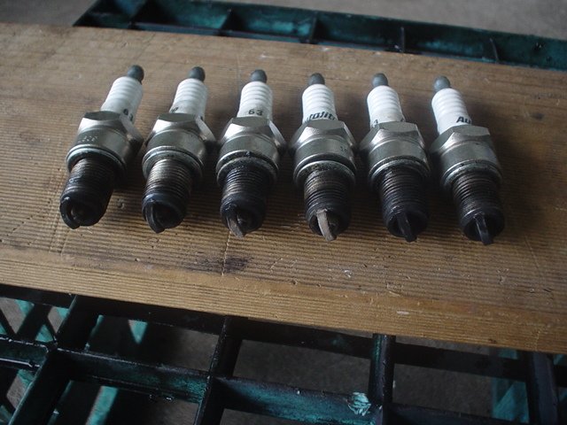

jg33replica 4 Posted September 18, 2019 Hi, been playing around and no luck yet. I am going to play with plugs , I ran the engine to running temp and put an infra red heat gun on each extractor pipe and discovered a big difference in temp on 3 and 4 they were much hotter. 3 especialy about 70 deg c higher than 1 2 5 and 6. I put a picture on here of the plugs to show number 3 is clearly very grey/whit coloured and 4 is not quite as bad but all the rest are black. Would a lean condition cause it to break down at just 3500 or is this a separate problem. I will check for a leak but has just in past couple days had new intake and carb gaskets fitted. I might try changing primary jets in carb up a few sizes. would this be how these intake run ? these two lean cyl are the 2 shortest runners on the intake. Its an Aussie speed intake. Share this post Link to post Share on other sites

ando76 4,354 Posted September 26, 2019 Sounds remarkably like the engine someone messaged my business page about the other day. To answer some questions; . yes 3&4 will run hotter (leaner) than the other cylinders due to their location. We have played with the plenum to address this issue and had some success. . As you've tried everything from the ignition side of things and most other mechanical things I'd be looking at tune, especially looking at those plugs. As I told the bloke that messaged me - get a $200 o2 sensor and gauge from Just Race Parts and then you'll have half a chance of getting the tune close. . If the carb is east/wested it's not uncommon to have to pull fuel out of the primaries and a good amount, as your miss is occurring early on I'd say your lucky to be cracking the secondaries so it may well be that. But without an o2 sensor - your in guess land. Oh and usually the fuel you take out of the primaries ends up going back into the secondaries. . I agree with gerg- the best money you ever will spend on your car is on a dyno session with a competent operator who knows carbs. . You mention that your running the Hall effect dizzy (which is good). Have you tried another dizzy? I have had Hall effect sensor go walk about and cause this condition. . Has coil condition been checked? Not "it's brand new" - has primary and secondary resistance been confirmed as in spec. Both when the coil is cold and after being driven. Even new stuff fails - especially in the made in China era. 1 gerg reacted to this Share this post Link to post Share on other sites
jg33replica 4 Posted September 27, 2019 Hi mate, The car belongs to my son and I reckon he was talkin to you as you said. I have a new O2 sensor kit that I was going to set up on my Falcon to tune tunnel ram carbs , We intend to weld a bung onto Cortina extractors and give it a go. I have had a breakthrough with the crossflow. I decided to play around with the carb tune and change jet sizes. I went a full 5 sizes bigger on primaries to see if I could make something change. It did exactly that it made it much worse , it caused it to breakdown at 2200. Next I went back a heap of jet sizes on primaries from where I started and it improved the thing a whole heap. It is twice as responsive down low and revs straight past 4000 without a problem. it does still however play up a little higher up. Next I will fit a decent Tacho as Not sure how accurate Cortina one is , O2 sensor , and get some more jets to play with. thanks for all the good advice everyone. 3 ando76, gerg and bear351c reacted to this Share this post Link to post Share on other sites
