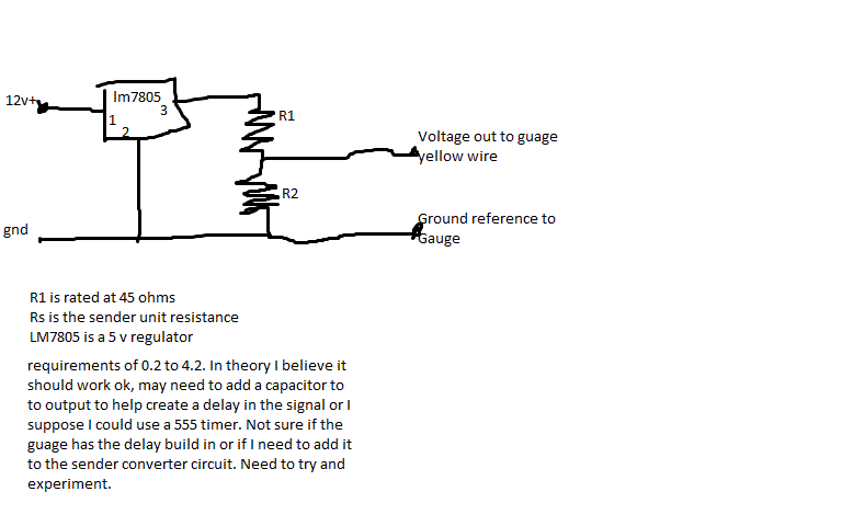

judgetread 761 Posted March 21, 2015 So firstly I'm no electrical engineer or whatever, so if anyone see's any obvious issues, problem or possible explosive results please let me know OK, so I didn't really look around so I have no idea if there is ant commercial product out there that would suit this project already, but hey electronics had been a hobby for a fair while when I was young so I thought I have a crack at this myself, keep myself active and out of trouble. So yes it could be a waste of time if something already exists but I find it interesting to play and learn (and fail often) I'm planning on adding a fuel cell to my xf ghia, getting rid of the standard tank and replacing it with a 60 or so litre fuel cell so it will suit my future plans. Problem is, most aftermarket fuel cells come with either a 0-90ohm or 7-97ohm resistance fuel sender. The problem is this will not work for the xf fuel gauge as it uses a volt system 0.2 to 4.2 volts to display the fuel level. So the project begins, make a conversion from the resistance type fuel senders for a voltage based display gauge The goals are: * Gauge requires input of Volts: [ empty = 0.2 volts, full = 4.2 volts ]* The sender, sends in ohms. [ empty = 0 ohms, full = 90 ohms ] * Any power must be from the 12 volt DC system the car current uses, no external power or crap. I drew up a schematic using a op-amp/comparator setup and a voltage divider. Added in a 5 volt regulator to the schematic from 12 volt to supply the currect volt and current needed for op-amp and resistor ratings. I also adding in a variable trim pot, so within the same ratio other senders should work as well, such as 7-97ohm sender. Using altium designer, converted the schematic to a pcb layout, adding in silk screens, overlays etc. Taking into account I didnt have any stuff available to make my own pcbs, the costs to buy all the stuff was not viable and I was planning on using SMD's, I designed to have them made. 2 nickyp00 and Gav reacted to this Share this post Link to post Share on other sites
judgetread 761 Posted March 21, 2015 After designing the boards, I searched around and found a absolute great deal to have to pcb's made for me, I sent the Gerber files ( files the pcb board making place needs) to a board manufacturer and for a massive $9.90usd including postage have 10 pcb's boards made to the designs. The only down side with getting these made so cheap, was the wait time. From sending the gerber's in to receiving the boards was just on 4 weeks wait but for $9.90 I cant complain. The boards come etched, silk screened, padded, and solder masked, really trying to do this myself would of been just a nightmare, the boards only meassure 5cm x 2.7cm to start with , then trying to etched the smd pads on the op amp would never of happened, so Im a happy chap. Now, I admit my first time using SMD's components and well it wasn't that much fun soldering them to the board, using 0805's was bad enough soldering, the stupid op-amp pin pitch was crazy to solder, but in the end I got through it Sorry about the bad pictures, camera on phone has crapped it and well these components are so friggin small. With the board together time for a test. Hooked it up to a DMM and a bread board and after playing around with the trim pot to fine tune out any tolerance in components all seems pretty good. Hooked up with 3 ohms resistance, give out a 0.2 volts result Hooked up to 90 ohms resistance puts out 4.21 volts By adjusting the trim pot, was able to get 7-97 ohms resistors working as well, so a sender with 7-97ohm should work too. Share this post Link to post Share on other sites
judgetread 761 Posted March 21, 2015 So, finally got around to making a case for it all, and a few pictures. Adding some standoffs for the pcb to sit on pcb clipped in, I also made another board this time soldering the wires directly to the board. Easier, cheaper and less stuff to go wrong. A hole on the bottom of the case, where you can adjust the trimpot. Remebering its a 90ohms difference you can set the range with it so like 0-90 or 7-97 or 8-98 etc. Finished box Just as a size comparison to a standard 9volt battery. Overall, everything worked out pretty well, except I doubt id do a SMD component project again. Well maybe for the resistors and caps, but not the IC, they are just way to small and a pain to do. I have everything to set it up done now, I just need to install the fuel cell and hook it up but that may be awhile or may not Edit: I just did a quick sticker to wrap around it. well cause I was bored 3 Outback Jack, Crazy2287 and BTS666 reacted to this Share this post Link to post Share on other sites

judgetread 761 Posted March 21, 2015 Im going out to the shed today to try it out on the xf, so we'll see if it works or not I might have to make adjustments to compensate for wiring resistance and voltage drop to the gauge, but ill find out very soon Awesome. You might find a few folks on here who would be interested in this conversion, if only for the fact that stock senders don't like modern fuels. I guess it would work for any sender that uses a resistances based system, even lpg? I never had any commercial plans, but if people are interested I could put into a case and post. Without working it out I guess it uses about 4-5$ in parts to make + the $1 board maybe less Share this post Link to post Share on other sites

judgetread 761 Posted March 23, 2015 well had some issues, couldnt get enough current through to the gauge when hooked up, or so I thought ... The 1k resistor was to high compared to the cars resistance, so bridging them pads on R2 and all seems to be working atm. But dark now to do a final test but was able get full and half tank to show at the correct ohms resistance. With many thanks to someone else for the help working that out. Ill get it all together and pics, then maybe a new electronics project?? 8 - 6 tacho convertor, and i know there are commercially available. 1 Outback Jack reacted to this Share this post Link to post Share on other sites
judgetread 761 Posted March 29, 2015 Ok, finally got time to do some more on this. Hooked it up to a fuel cell, and it is working well. Seems the xf digital dash lags by about 5-7 seconds, so i guess the dash gauge updates itself every 5-10 seconds, which seems normal and fine. Trying to get all the stuff packed into a project box all neat and secure today, but between the nrl, cricket and v8's its hard to find the time to get it all done 2 Outback Jack and deankxf reacted to this Share this post Link to post Share on other sites

nickyp00 13 Posted May 27, 2017 (edited) Hi, new here guys but this would be verry handy for my project. I have an xd falcon utility and have instaled a 5l v8 out of a eb falcon including the 4 speed btr automatic. To save clutter, mucking around and complication I have installed a fuel tank with built in pump out of a 98 xh falcon utility and of course I have the same probem as everybody else with converting the system to accept a resistance type sender unit. My sender unit measures outside the range specified in the above schematic being 2.2 ohms empty to 180 ohms full. I guess I could change the trim pot value to increase the operating range. How does the 7805 regulator go dropping the 12 - 14v down the 5v heat wize, its a fairly big drop. I had a thought to build a simple voltage divider using a 5v reg and the sender unit personally. Interesting use of the ic in the circuit. Have enjoyed electronics as a hobby for a long time but did not delve into the ic side of things that much. Not trying to steal the thunder from the previous bloes design cause it seems verry plausible solution, I have come up with my own design. Edited May 27, 2017 by nickyp00 Circuit I designed 1 judgetread reacted to this Share this post Link to post Share on other sites
