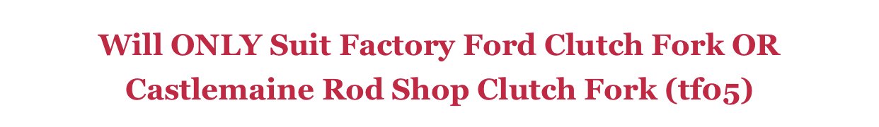

jca25 1,034 Posted October 29, 2021 It’s currently cable now. Not sure there is a proper hydraulic conversion for this setup to be honest either.Just looked at the fork they say suit it is a hydraulic fork so if are to go down the path of this bell just mod the firewall to take the master Sent from my SM-A125F using Tapatalk Share this post Link to post Share on other sites
deankxf 21,088 Posted October 29, 2021 10 minutes ago, fotz said: It’s currently cable now. Not sure there is a proper hydraulic conversion for this setup to be honest either. if you can find one, the XA to XE hydraulic pedal box is a bolt in. you then need to mount a master to the firewall which is more of a pain in an XF. 1 fotz reacted to this Share this post Link to post Share on other sites
jca25 1,034 Posted October 29, 2021 This is said fork they say to use with that bellhousing, now don't the Cleveland and Windsor use the same engine mounts?? So that would make the Windsor sit in the bay as the Cleveland, the crossflow the engine plates to the x member is different so not sure were u are going with measuring it, if need be may need to make ur own up to suit Sent from my SM-A125F using Tapatalk 1 fotz reacted to this Share this post Link to post Share on other sites
