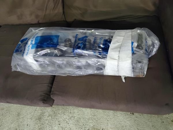

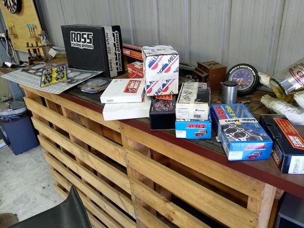

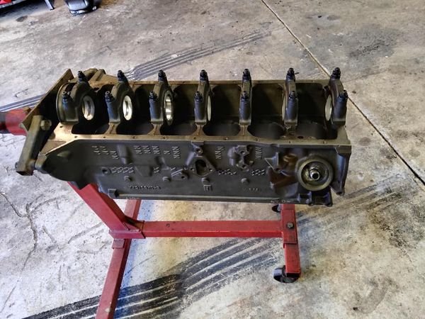

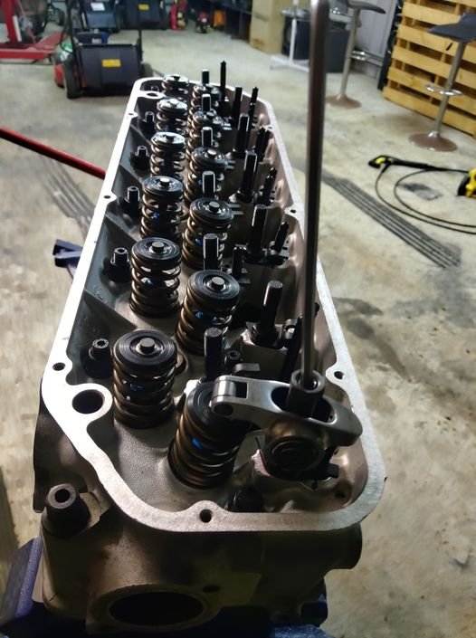

Andrew Davies 20 Posted July 31, 2021 a bit of an update my spool rods and ross forgies have turned up. have sourced another engine with a spare 4 speed cheap and stripped it down. engine was out of an xe but it has a rubber crank seal and an unmarked hf4 head with a 52cc chamber. bore is standard size, not that it matters because it will be going 40 thou over to suite the pistons. i have started porting the head so far : gasket matched intake and exhaust, blended valve seats, stream lined around the valve guide. still have to polish up the exhaust ports and unshroud the valves in the chamber. unsure what it will flow but should make a bit of difference. head will have new valve guides installed and a 3 angle valve job and a skim. i will need to talk to my machine shop to find out what m.l.s head gaskets are available so i can work out comp ratio. block will be decked to 0. still undecided on cam atm if budget allows i would like a solid roller not so i can go bigger on cam but for not having to run in the cam and swap springs out. 1 1 deankxf and Slow250XC reacted to this Share this post Link to post Share on other sites

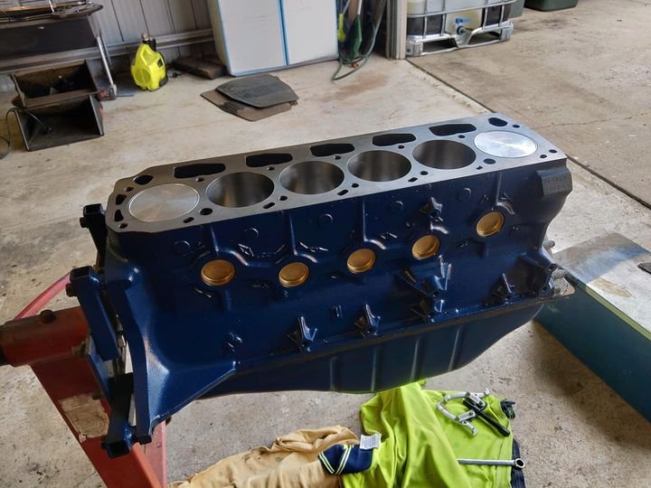

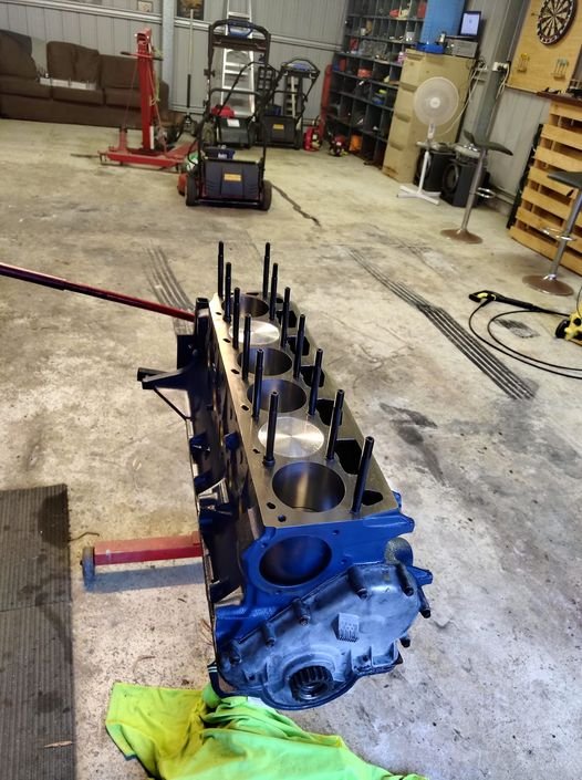

Andrew Davies 20 Posted September 28, 2021 sorry for the late update, machine shop only just returned my stuff. so they decked block to 0 then realised comp was 12.8-1 so they machined a small dish in my pistons and went with a 60thou mls head gasket. crow sent wrong cam, i ordered the 14806 and got the 14626 still have to work out my final comp with this stick to see if it will work or ping its ass off. machine shop forgot welsh plugs and fuel pump block plate (maybe more havent had a good look). still waiting for my engine paint to show up (hopefully this week so i can start assembly on the weekend). also crow didnt send a dizzy gear so that leads me to my next question : im currently running an est dizzy and im not sure if it will fit my new block (im sure its an xe block) ? not a big issue as i still have to order pushrods after i assemble and measure. slow progress is still progress ! to make things worse my old engine is now hammering oil and coolant from the head gasket so i better get a move on ! 3 Outback Jack, Slow250XC and gerg reacted to this Share this post Link to post Share on other sites
Andrew Davies 20 Posted October 12, 2021 engine mostly assembled. had to cut up some clevo guide plates and run them individually. sent pushrods back to get some stock length ones because they are a perfect fit (we knew it would be hard to guess after all the changes). left to do : install a new bush and cam gear onto dizzy waiting on pushrods so i can finish top end assembly install oil filter install water pump install rear welsh plugs install ballancer install electric fuel pump and wire into car then when i get a free weekend swap her in ! sorry for the slow progress (had a few issues with machine shop). 4 1 Slow250XC, FORD_MAN, gerg and 1 other reacted to this Share this post Link to post Share on other sites
