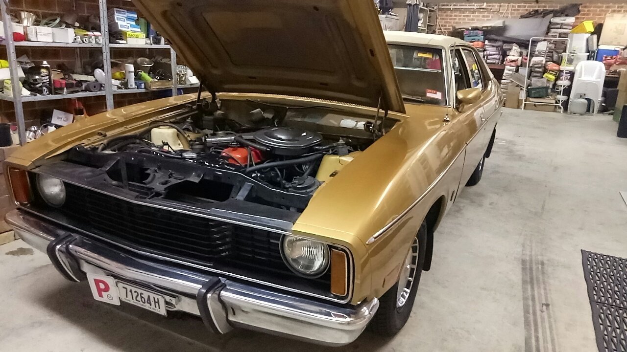

Senna117 3 Posted May 21, 2019 Hi guys I own a 76 XC, It has a stock 4.1L straight-6. Ive had it for 2 years and have enjoyed it but feel like i need a bit more noise and power now, can someone give me a point in the right direction on where to look for extractors, websites, brands, tips, really anything. Thank you 1 macman reacted to this Share this post Link to post Share on other sites

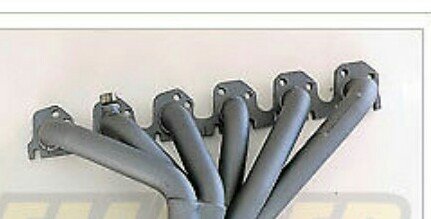

Senna117 3 Posted May 22, 2019 I just ran into a problem, my bolts dont line up with what the pacemakers ph4470 are. They say it fits XC but it doesnt look like it, is this what you purchased? 1 CHESTNUTXE reacted to this Share this post Link to post Share on other sites
CHESTNUTXE 7,694 Posted May 22, 2019 opps i forgot yee had a iron head,just go a xc set on e bay there is many that suit xc,very cheap too around $200 Share this post Link to post Share on other sites
Senna117 3 Posted May 22, 2019 Looking at it i believe it may actually fit i believe i only need the top right hole and the bottom left gap they've got open. I think having all the holes are for other models. Did you have to cut or modify yours at all? @CHESTNUTXE Share this post Link to post Share on other sites
CHESTNUTXE 7,694 Posted May 22, 2019 Looking at it i believe it may actually fit i believe i only need the top right hole and the bottom left gap they've got open. I think having all the holes are for other models. Did you have to cut or modify yours at all? [mention=7196]CHESTNUTXE[/mention]They should have 2 sets of holes on the header flange why not just ring and find out but no no mods just bolt on and lay down a rubber roadSent from my SM-G570Y using Tapatalk 1 1 gerg and Senna117 reacted to this Share this post Link to post Share on other sites

macman 774 Posted May 22, 2019 1 hour ago, Senna117 said: Looking at it i believe it may actually fit i believe i only need the top right hole and the bottom left gap they've got open. I think having all the holes are for other models. Did you have to cut or modify yours at all? @CHESTNUTXE That's how mine look on my iron head crossflow too, just some of those bolt holes don't get used. Looks crap IMO but I believe that's just how they are. Extractors and larger exhaust are the generic first upgrades and obviously will make it louder. But whether you like louder or not is a matter of personal preference. Previous owner put extractors and a single 2.5" exhaust (with a 3" tailpipe section) on my 250 and I actually almost hate it. He absolutely loved the sound, but it gives me a ringing headache. Just two opposite ends of the scale with what some people like and others don't like. 2% of the time I get a bit of enjoyment when coasting down hill in 3rd gear, it sounds alight. But otherwise it's just loud. Power-wise, I don't know what it was like before the extractors and exhaust, but it hasn't got much guts now, so I hope it wasn't worse before - my suspicion is it's the same, just louder. P.S. I love your XC, looks great! Share this post Link to post Share on other sites
Senna117 3 Posted May 22, 2019 34 minutes ago, macman said: That's how mine look on my iron head crossflow too, just some of those bolt holes don't get used. Looks crap IMO but I believe that's just how they are. Extractors and larger exhaust are the generic first upgrades and obviously will make it louder. But whether you like louder or not is a matter of personal preference. Previous owner put extractors and a single 2.5" exhaust (with a 3" tailpipe section) on my 250 and I actually almost hate it. He absolutely loved the sound, but it gives me a ringing headache. Just two opposite ends of the scale with what some people like and others don't like. 2% of the time I get a bit of enjoyment when coasting down hill in 3rd gear, it sounds alight. But otherwise it's just loud. Power-wise, I don't know what it was like before the extractors and exhaust, but it hasn't got much guts now, so I hope it wasn't worse before - my suspicion is it's the same, just louder. P.S. I love your XC, looks great! Thanks Macman i like yours too, is it a cortina? Some people enjoy the ear rape but theres an art to it, i like the sound of mine but want a BIT more noise so im hoping extractors will do it. I rang around and it will fit on but need to take it to a shop to get the 2 1/2 outlet taken down to i believe mine is around 1.8 inches. Might not follow through with the extractors as im told its a permanent modification and the old cant be put back on Share this post Link to post Share on other sites
