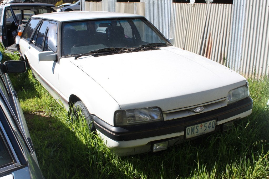

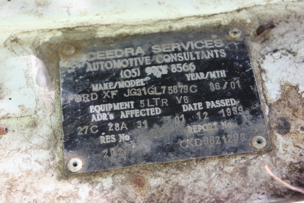

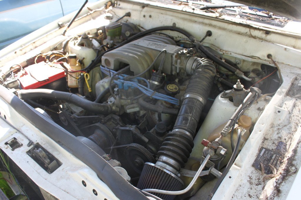

SPArKy_Dave 9,344 Posted September 20, 2019 30 minutes ago, CHESTNUTXE said: hey i might just buy that nice au ltd engine ,i no for a fact it has only done 90,000km because i saw the car it came in,a mint LTD with a prang in the left front(probly repairable but too expensive for a insurance to fix,i have pictures of it somewhere here on oz falc,only thing i am concerned about is these gt 40p heads,lets say chuck it in a xf what headers do you need ,there is differance between normal 302 and gt40 heads some spark plug angle differance,maybe there is a trick . Here's a pic of an engineered Windsor V8 conversion, in an XF - 3 FordRufus, gerg and CHESTNUTXE reacted to this Share this post Link to post Share on other sites
NZXD 2,328 Posted October 1, 2019 hey i might just buy that nice au ltd engine ,i no for a fact it has only done 90,000km because i saw the car it came in,a mint LTD with a prang in the left front(probly repairable but too expensive for a insurance to fix,i have pictures of it somewhere here on oz falc,only thing i am concerned about is these gt 40p heads,lets say chuck it in a xf what headers do you need ,there is differance between normal 302 and gt40 heads some spark plug angle differance,maybe there is a trick .The P on gt40p heads stands for plug angle, I originally had gt40p heads on my AU spec 5.0 in my XD, dummy fitted hurricane 4-1 headers and with 90 degree (from memory) spark plug boots it all cleared. Sent from my iPhone using Tapatalk 3 bear351c, CHESTNUTXE and gerg reacted to this Share this post Link to post Share on other sites
