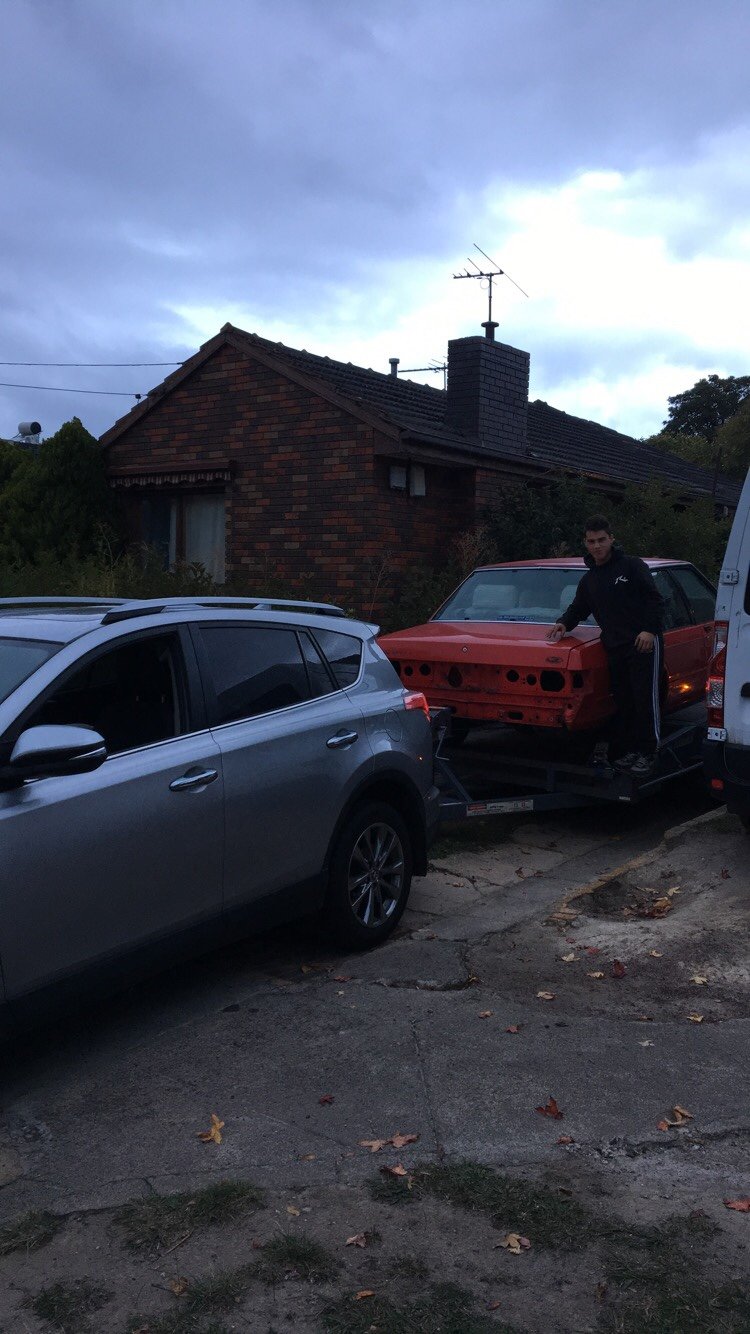

PapouGhia 33 Posted April 29, 2019 Finally the car is stripped down and going to the panel and painters my mate gave me a hand Be back in month or so. Anyone has any good parts or know where to get, Rubber sets,power window repairs,bush kits,xf efi engine loom not been butchered,badges. Just the essentials mainly so I can gather parts, I’m located in Melbourne. Cheers all Sent from my iPhone using Tapatalk 2 NZXD and deankxf reacted to this Share this post Link to post Share on other sites
