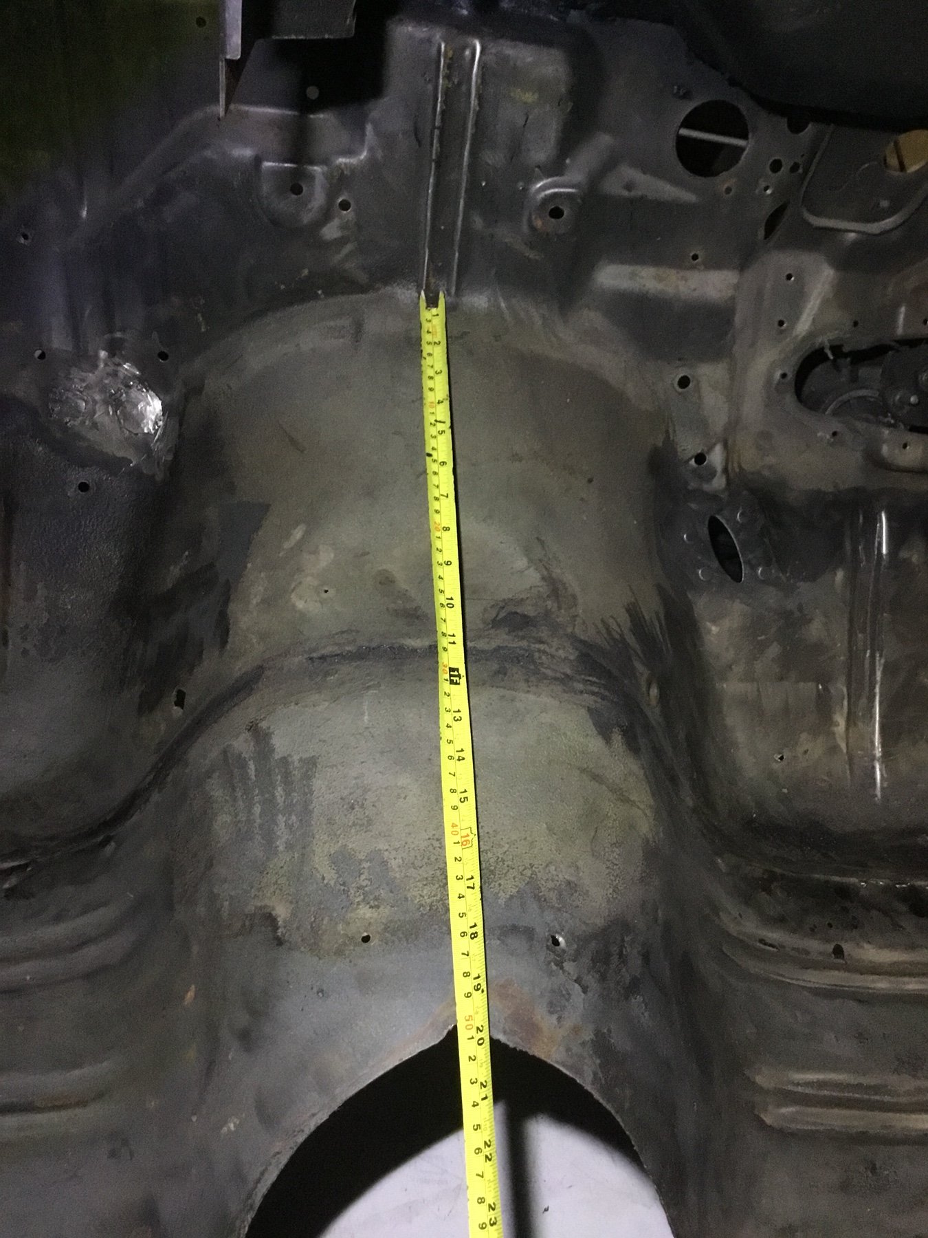

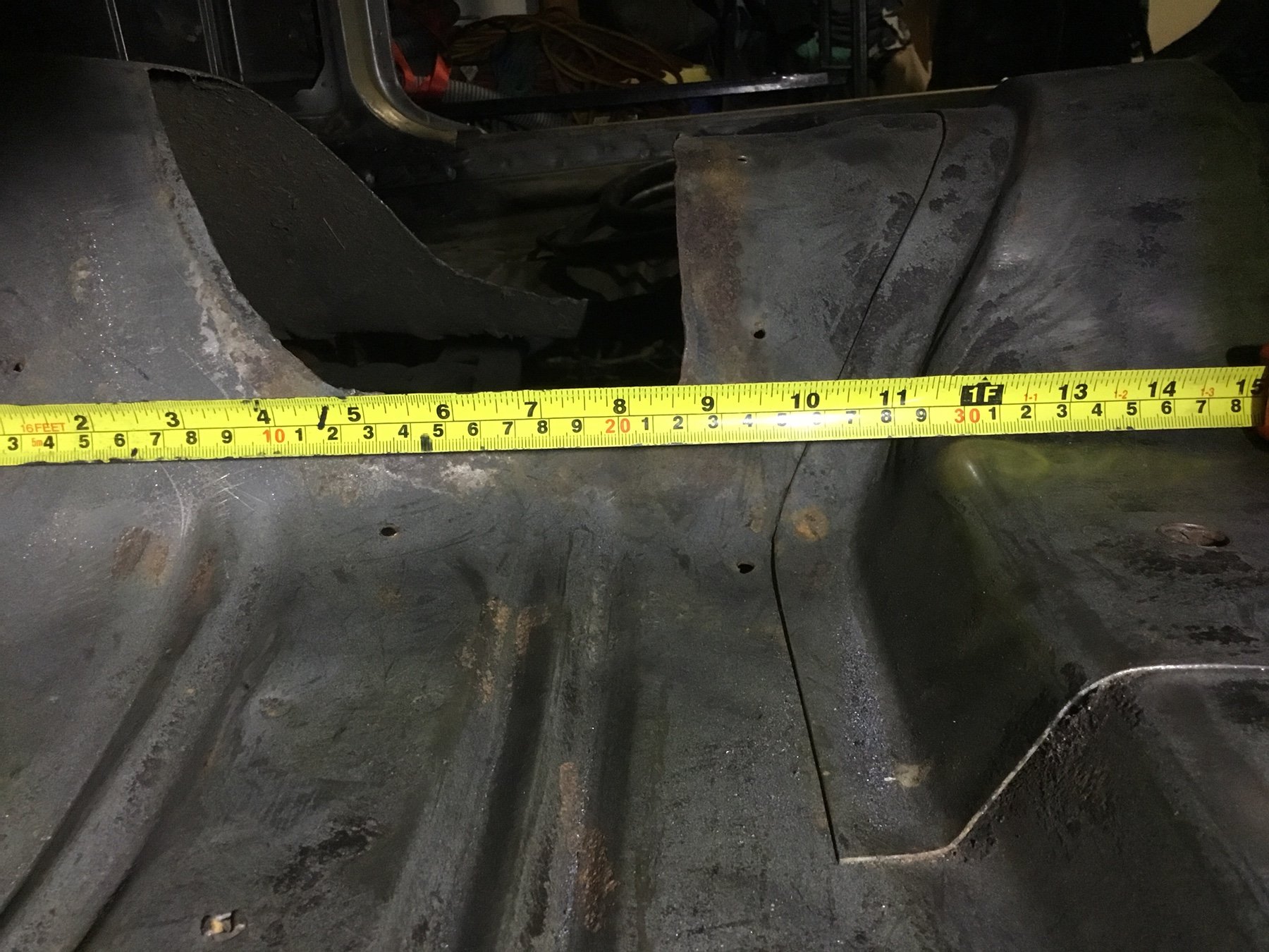

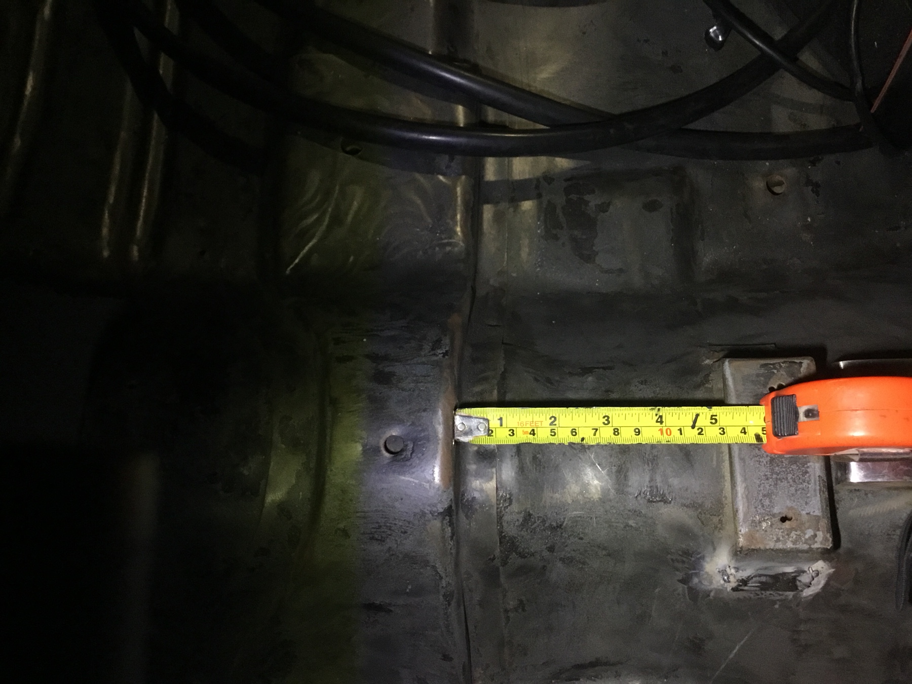

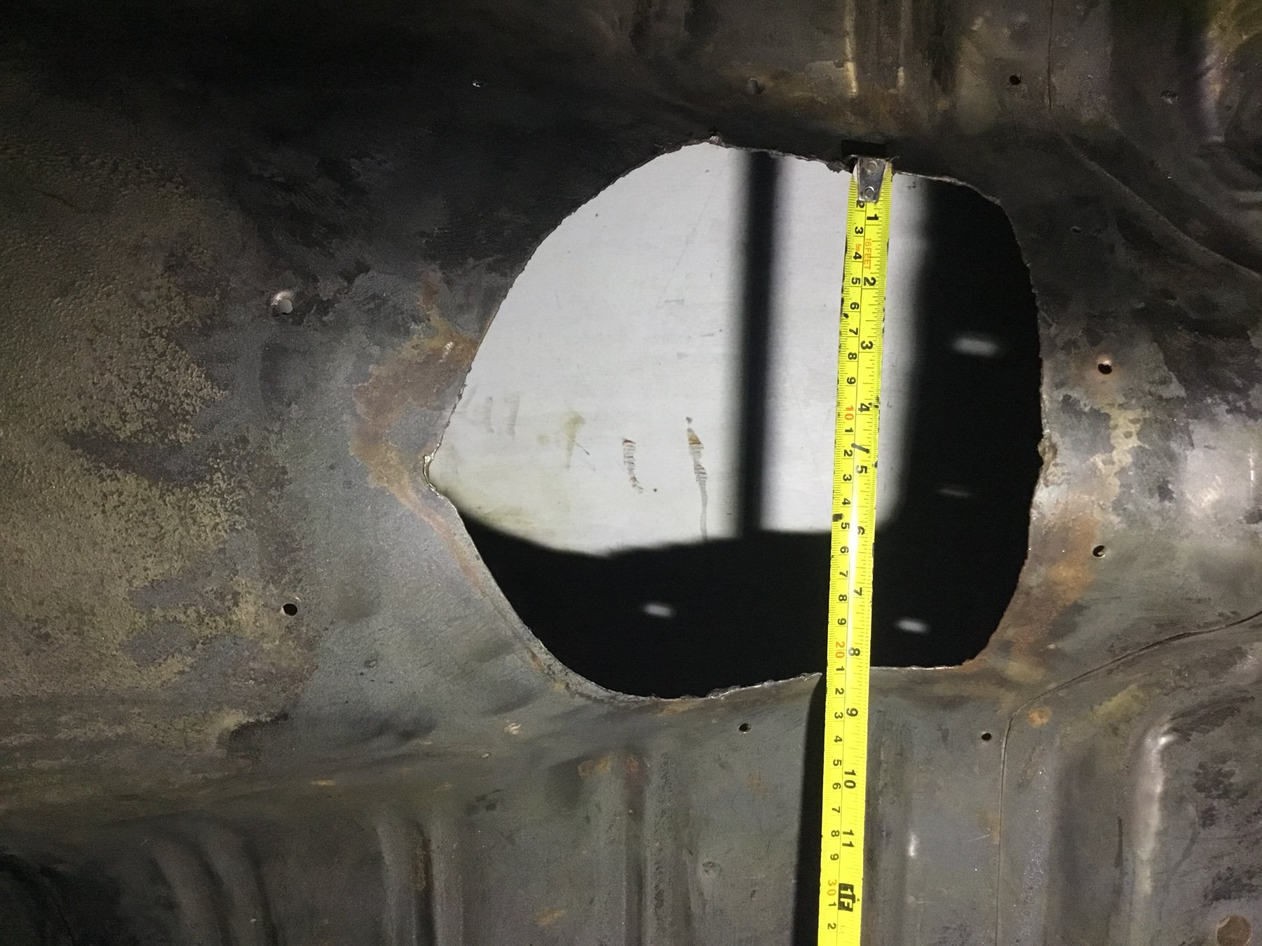

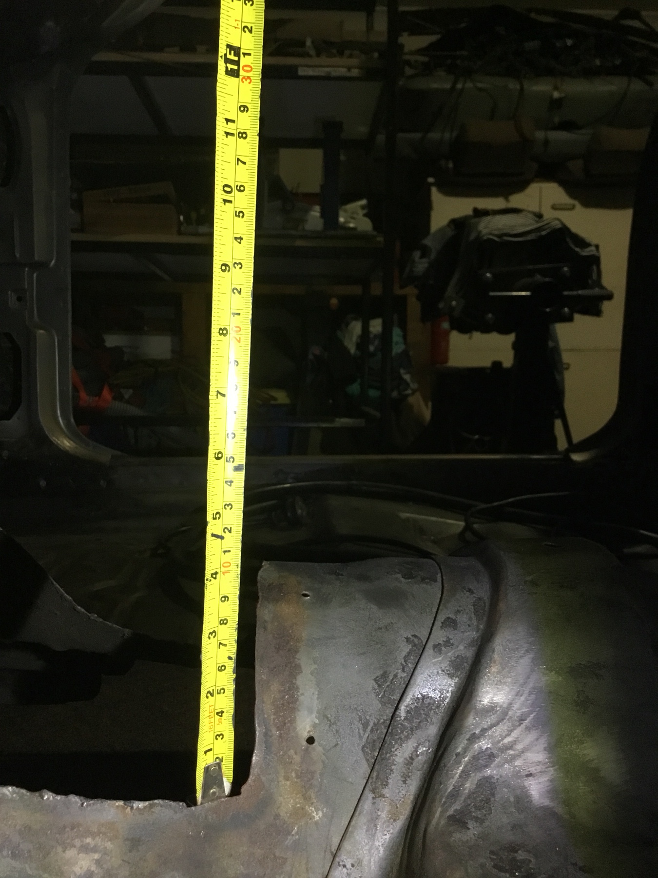

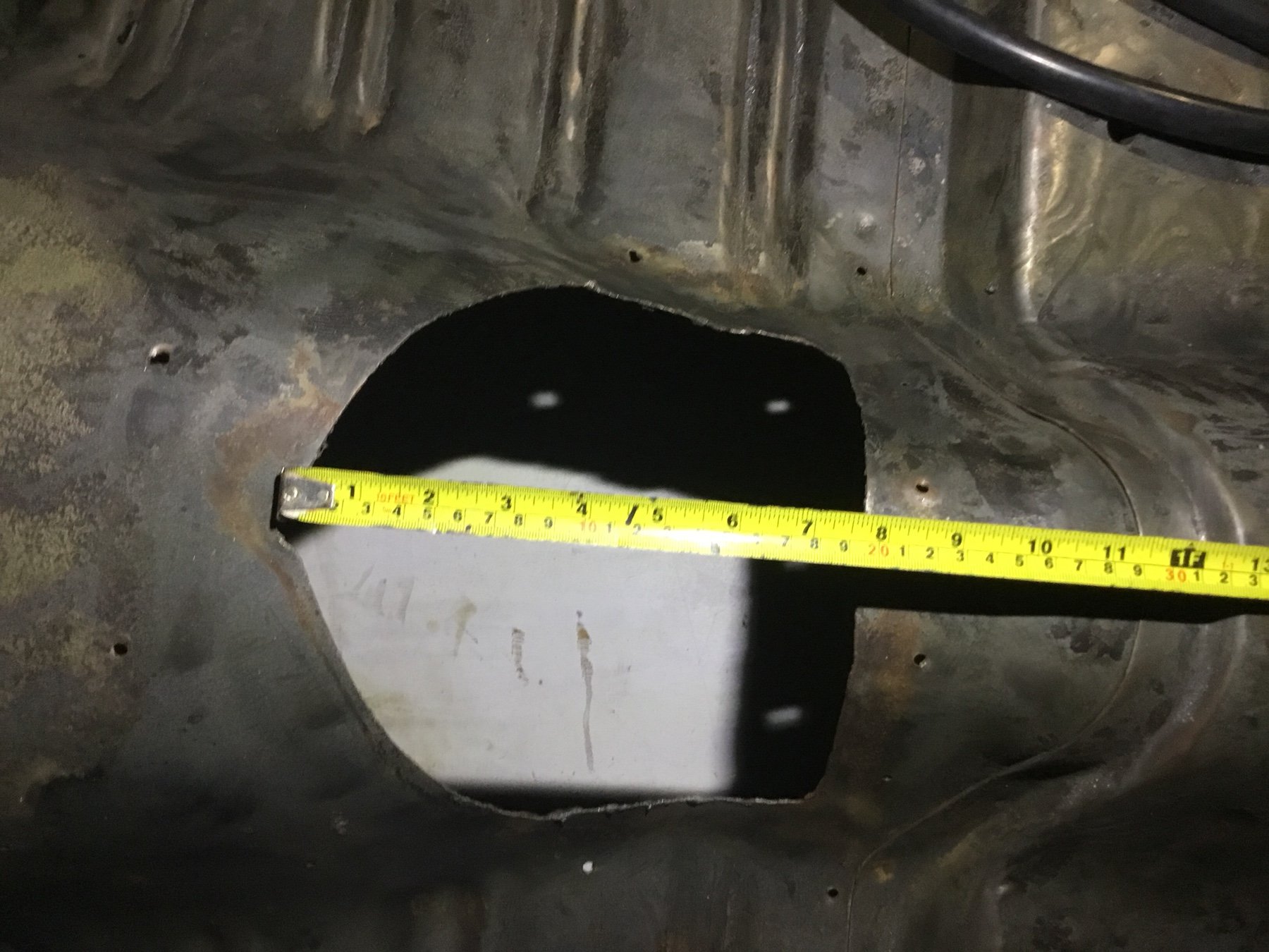

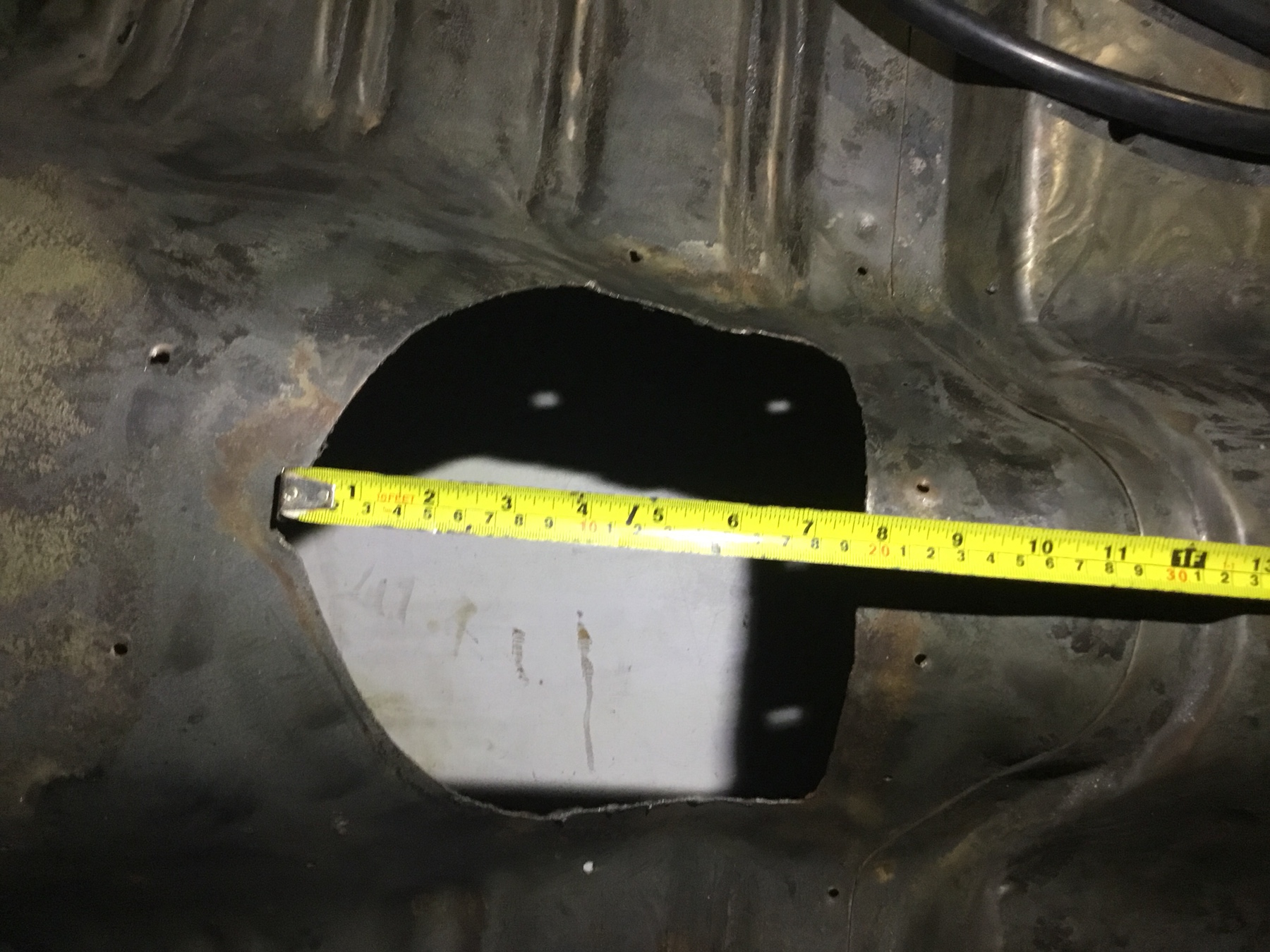

bear351c 10,433 Posted January 5, 2018 Anyone got a measurement of where the hole in the trans tunnel is for an Automatic with a floor shift in an XA, XB, XC?? I need to cut the tunnel and fit an FMX with a T-bar and console. Obviously need to cut the carpet, is there a "hole" pressed into the steel? I haven't pulled the carpet up to have a look. Will need the width and length of the hole, and distance from dash or firewall. Also need to know where the mounting plates go for the console to bolt to. Where to bolt this bit....... ....and these two. Cheers Bear. Share this post Link to post Share on other sites

77xcfalcon 177 Posted January 5, 2018 Hi bear, I hope these help. Mine is a 6 cyl c4 xc. The top of the console mount is 20 mm off the top of the tunnel. I’ll get some specific measurements if you like.Sent from my iPad using Tapatalk 2 BGDAV and bear351c reacted to this Share this post Link to post Share on other sites
77xcfalcon 177 Posted January 5, 2018 Mine only has one console mount, am I missing one ?Sent from my iPad using Tapatalk Share this post Link to post Share on other sites
bear351c 10,433 Posted January 5, 2018 8 hours ago, 77xcfalcon said: Hi bear, I hope these help. Mine is a 6 cyl c4 xc. The top of the console mount is 20 mm off the top of the tunnel. I’ll get some specific measurements if you like. Thanks for that, much appreciated. Share this post Link to post Share on other sites
