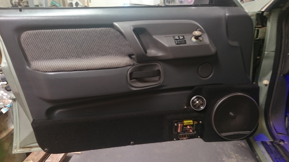

ZL. 19 Posted November 19, 2014 Heres the ones i done for theFairlane, havent got the pics from when i made it, but just bought some mdf and knocked them up, bit of black upholstery carpet and they came up pretty well 3 Outback Jack, steve mcqueen and XTREME KARTS XF reacted to this Share this post Link to post Share on other sites
