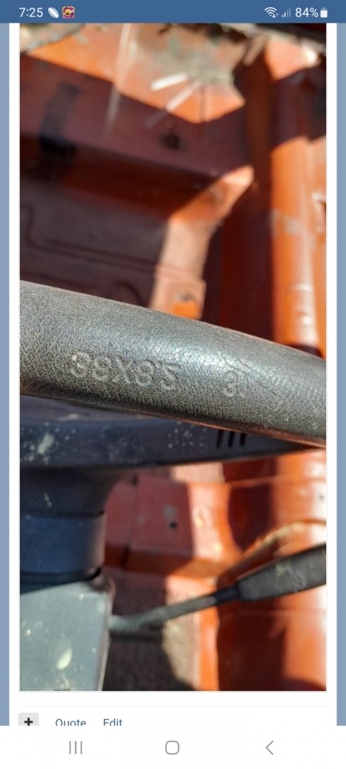

CHESTNUTXE 7,739 Posted August 26, 2023 Show something that dont make sense on your car ,like a rare option or thrown in on the assembly line,this number looks like something from the factory ,never seen this ever on a xe ,its definatly the original wheel as everything else on this car is,and being a 3/82 my guess is its a numberd prototype thrown in on the assembly line that no one knew about cause who would have seen the back of it in that 1 minute to install it,4/82 was the release date on the xe,and plenty of cars were being built in feb and march for stock to the public to snap up. 1 deankxf reacted to this Share this post Link to post Share on other sites
CHESTNUTXE 7,739 Posted August 26, 2023 pichttps://imgbox.com/hRlOukHS Share this post Link to post Share on other sites
CHESTNUTXE 7,739 Posted August 26, 2023 Pic 2 deankxf and SPArKy_Dave reacted to this Share this post Link to post Share on other sites
CHESTNUTXE 7,739 Posted August 26, 2023 Scully take a look at that 1 1 SPArKy_Dave and steve mcqueen reacted to this Share this post Link to post Share on other sites

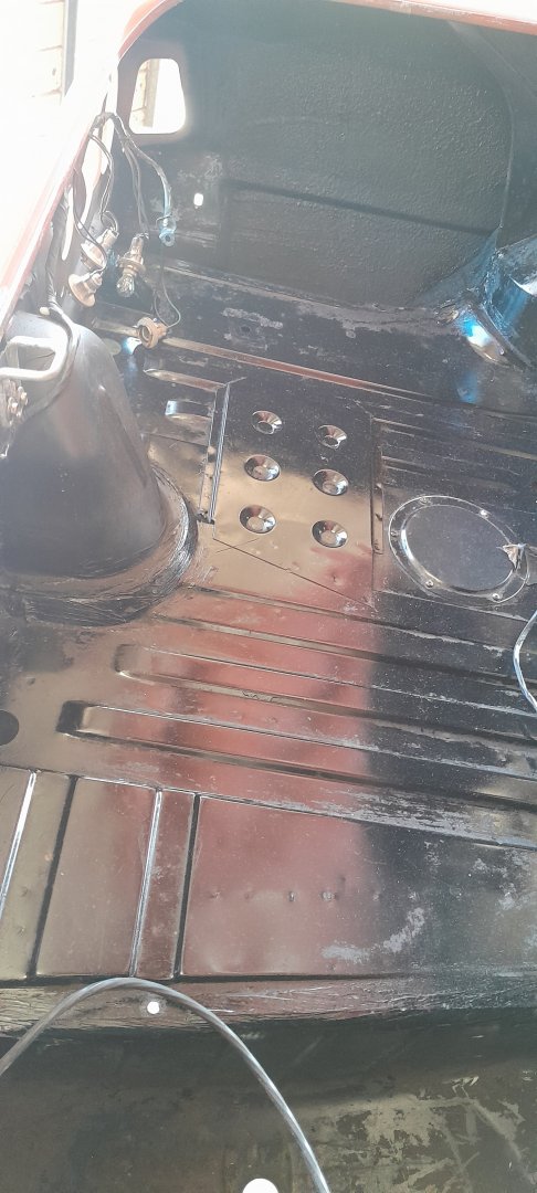

CHESTNUTXE 7,739 Posted August 30, 2023 2nd is these weird brackets I have only ever seen these on very early xe and possibly late xd. 1 SPArKy_Dave reacted to this Share this post Link to post Share on other sites
deankxf 21,710 Posted August 31, 2023 baking tray for cupcakes? 2 SPArKy_Dave and CHESTNUTXE reacted to this Share this post Link to post Share on other sites
CHESTNUTXE 7,739 Posted August 31, 2023 Hmmm 2 deankxf and steve mcqueen reacted to this Share this post Link to post Share on other sites

deankxf 21,710 Posted September 5, 2023 On 8/31/2023 at 8:40 AM, CHESTNUTXE said: 2nd is these weird brackets I have only ever seen these on very early xe and possibly late xd. peter Anderson (youtube) latest video has bought a ZK fairlane and it has this cupcake tray also 1 CHESTNUTXE reacted to this Share this post Link to post Share on other sites
SPArKy_Dave 9,483 Posted September 5, 2023 48 minutes ago, deankxf said: peter Anderson (youtube) latest video has bought a ZK fairlane and it has this cupcake tray also Lol, he has so many cars now... almost as bad as me. I can't work out, how he fits them all in. I reckon it could be something to do with harmonics dampening? Compare the flooring with later year ones, which don't have the cake tray. The design may have changed? 1 CHESTNUTXE reacted to this Share this post Link to post Share on other sites

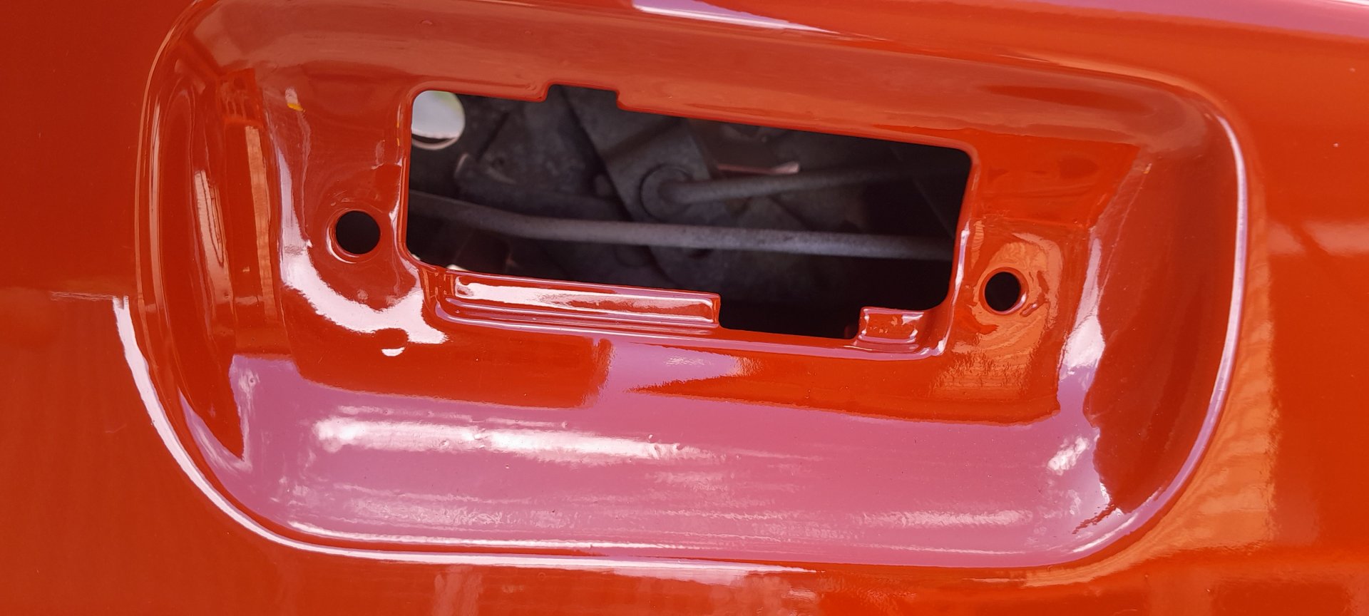

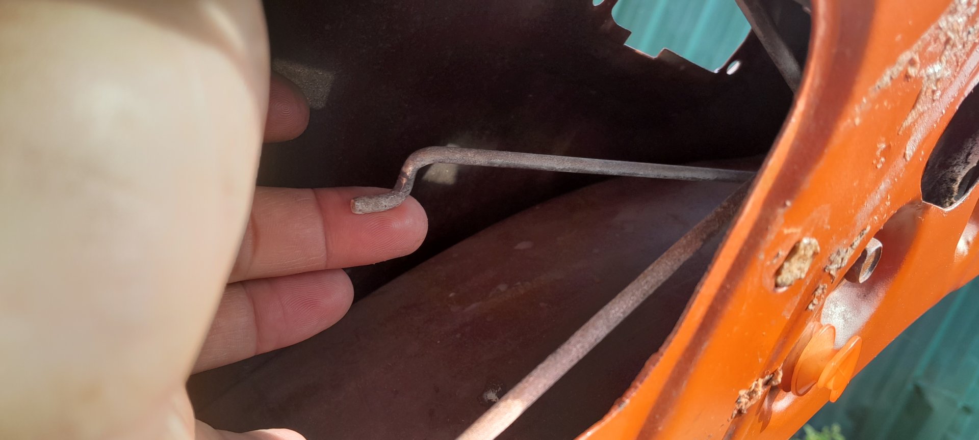

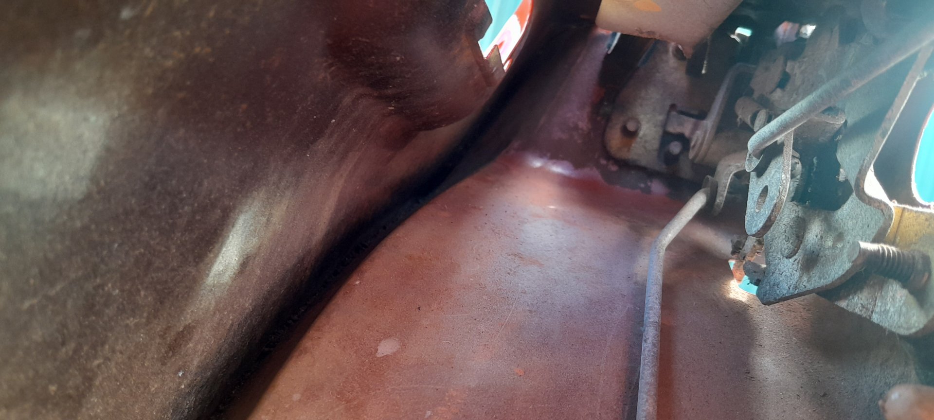

CHESTNUTXE 7,739 Posted September 22, 2023 Next is this can someone explain,the door rod is about 5 cm or more ,you can't line the handle up with it,or is this rod for something else and I'm missing the correct rod Share this post Link to post Share on other sites
deankxf 21,710 Posted September 22, 2023 30 minutes ago, CHESTNUTXE said: Next is this can someone explain,the door rod is about 5 cm or more ,you can't line the handle up with it,or is this rod for something else and I'm missing the correct rod i've moved the pivot point for the inner handle i think on rear doors twice (to take up slack) have the rods been fitted wrong? is it meant to have a kink in it? 5cm is miles out, haven't got the left handle in the right door etc? 1 CHESTNUTXE reacted to this Share this post Link to post Share on other sites
CHESTNUTXE 7,739 Posted September 22, 2023 i looked on the other rear door and that rod goes to that white plastic turning thing,but something aint right ,in that plastic thing the handle rod is meant to be on notch 2 and that one in the pictures goes on notch 1,so ? 1 deankxf reacted to this Share this post Link to post Share on other sites
deankxf 21,710 Posted September 22, 2023 40 minutes ago, CHESTNUTXE said: i looked on the other rear door and that rod goes to that white plastic turning thing,but something aint right ,in that plastic thing the handle rod is meant to be on notch 2 and that one in the pictures goes on notch 1,so ? copy the side that works i guess 1 CHESTNUTXE reacted to this Share this post Link to post Share on other sites
CHESTNUTXE 7,739 Posted September 22, 2023 there is a xf rear drivers door on market place complete for $50 i might go buy it for parts,and see wtf id going on. 1 deankxf reacted to this Share this post Link to post Share on other sites

dvfalcon 397 Posted October 22, 2023 On 9/22/2023 at 5:14 PM, CHESTNUTXE said: i looked on the other rear door and that rod goes to that white plastic turning thing,but something aint right ,in that plastic thing the handle rod is meant to be on notch 2 and that one in the pictures goes on notch 1,so ? it is all a compromise with the length of the rods and travel you require . get one handle working and then introduce the second handle the rods may need to be shorten, I normally bend them to and put a small S shape in it if it has not not got enough travel take some of the kink out to lengthen it. make shore the kiddy lock is not on and the rods don't fight each other and lockup i have access to a right rear door I will check when I get home if it helps 2 deankxf and CHESTNUTXE reacted to this Share this post Link to post Share on other sites
