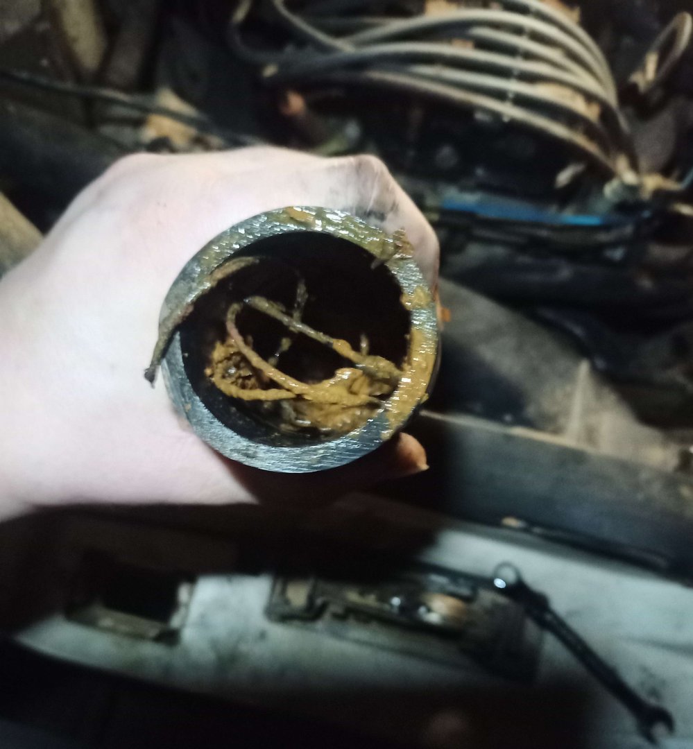

Nato of Falcons 23 Posted April 26, 2023 So I had to hook the bottle back up and it had to feed down toward the engine, the fuel pump cant suck up enough if I sit the bottle underneath it. Im thinking its the fuel pump hey? I have to fix up a coolant line because it busted itself while I was testing. Share this post Link to post Share on other sites
deankxf 20,294 Posted April 26, 2023 26 minutes ago, Nato of Falcons said: So I had to hook the bottle back up and it had to feed down toward the engine, the fuel pump cant suck up enough if I sit the bottle underneath it. Im thinking its the fuel pump hey? I have to fix up a coolant line because it busted itself while I was testing. better the coolant issue now than cooking an engine later. this is why i recommend changing all hoses on a "barn find" the cast alloy fittings in the manifold can go crusty is this what broke? i bypassed the manifold coolant flow on one of my cars for this reason, but also another car due to a welsh plug rusted out on the back side of one. sounds like the pump is weak, it could be full of crud. i'd be inclined to run the engine wherever the bottle works for a bit and see if fresh fuel cleans up that issue. 1 omgwizards reacted to this Share this post Link to post Share on other sites
Nato of Falcons 23 Posted April 26, 2023 Huston... we have a problem... At this rate all the bolt ons and the radiator & Fuel pump are going to have to be scratched and new ones done. I like learning and experiencing this engine but damn ive opened up a can of worms on this one fella's. 1 omgwizards reacted to this Share this post Link to post Share on other sites
