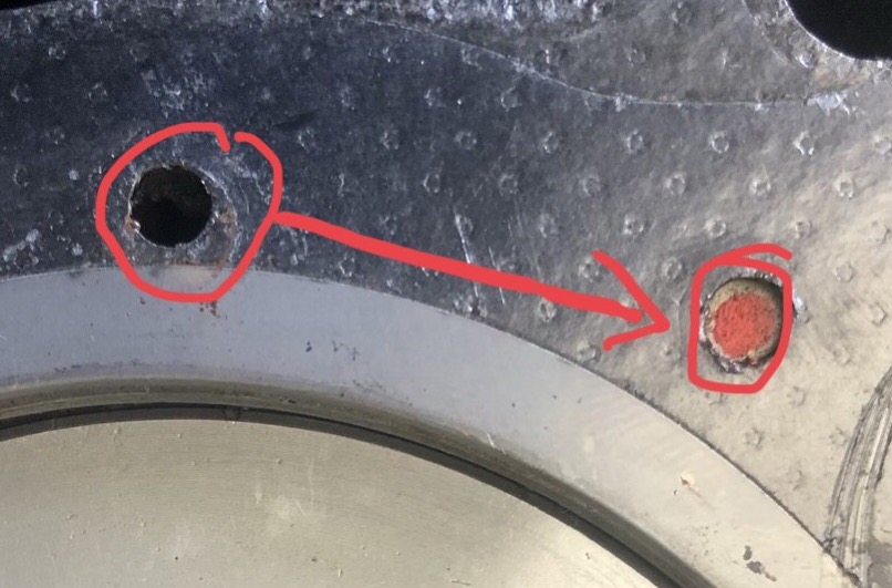

stibbsXR8 0 Posted January 26, 2019 I’ve got a 289 Windsor block that I’m putting edelbrock 5023 heads on. The instructions say to drill a 1/8” hole into the block for steam holes as they are in a different location on the new heads. Is this something that I can do myself or is it a job for a machine shop? Share this post Link to post Share on other sites
judgetread 761 Posted January 26, 2019 Steam hole is a misleading name tbh, its more like a vent hole to let trapped air out. You can do it yourself, just gotta be careful its 1/2inch thick there and can snap a drill quite easily... 2 deankxf and gerg reacted to this Share this post Link to post Share on other sites
gerg 10,875 Posted January 26, 2019 It's iron, so go slow with no lube (that's what she said) Sent from my CPH1607 using Tapatalk 3 winton, bear351c and judgetread reacted to this Share this post Link to post Share on other sites
