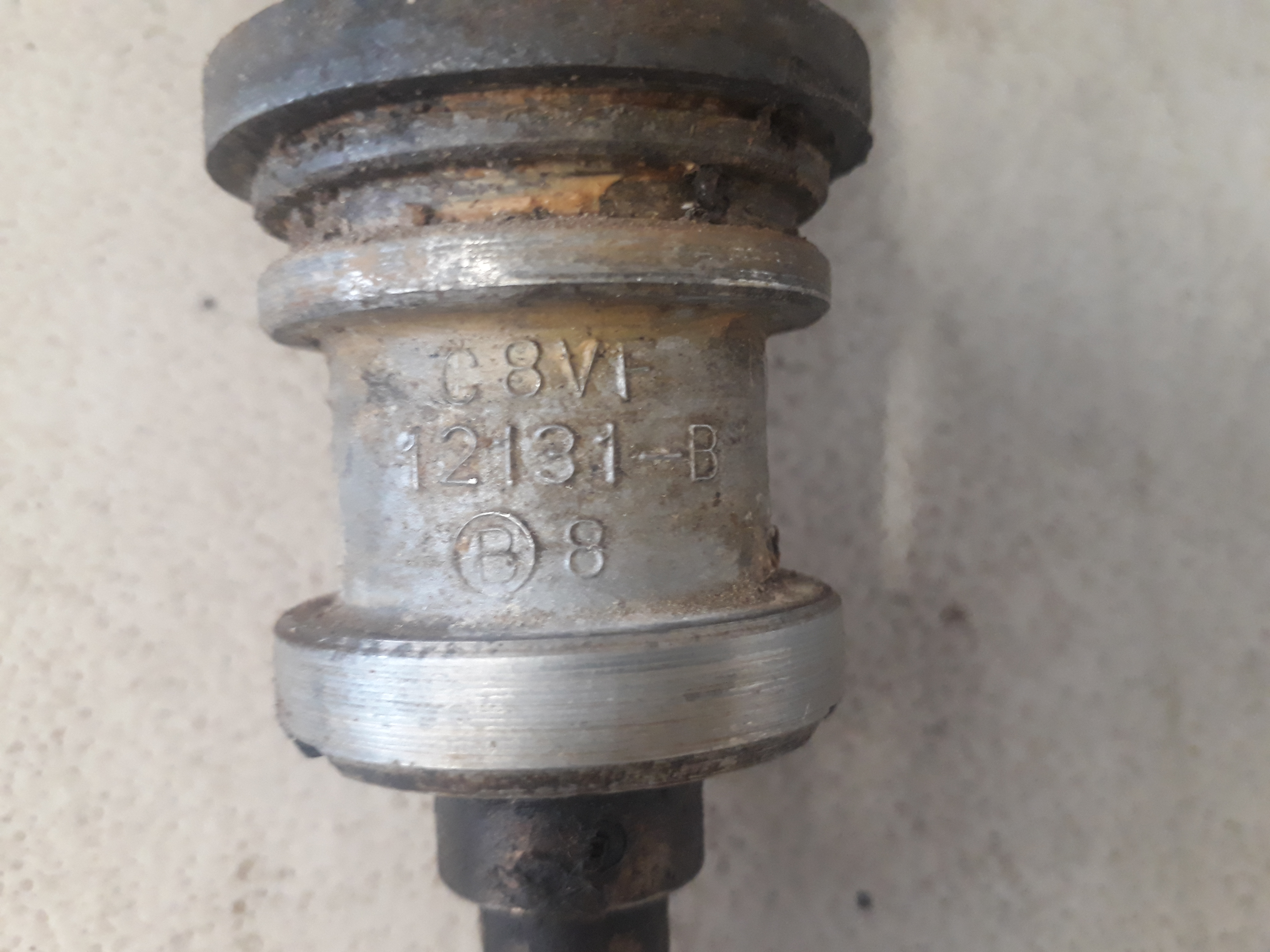

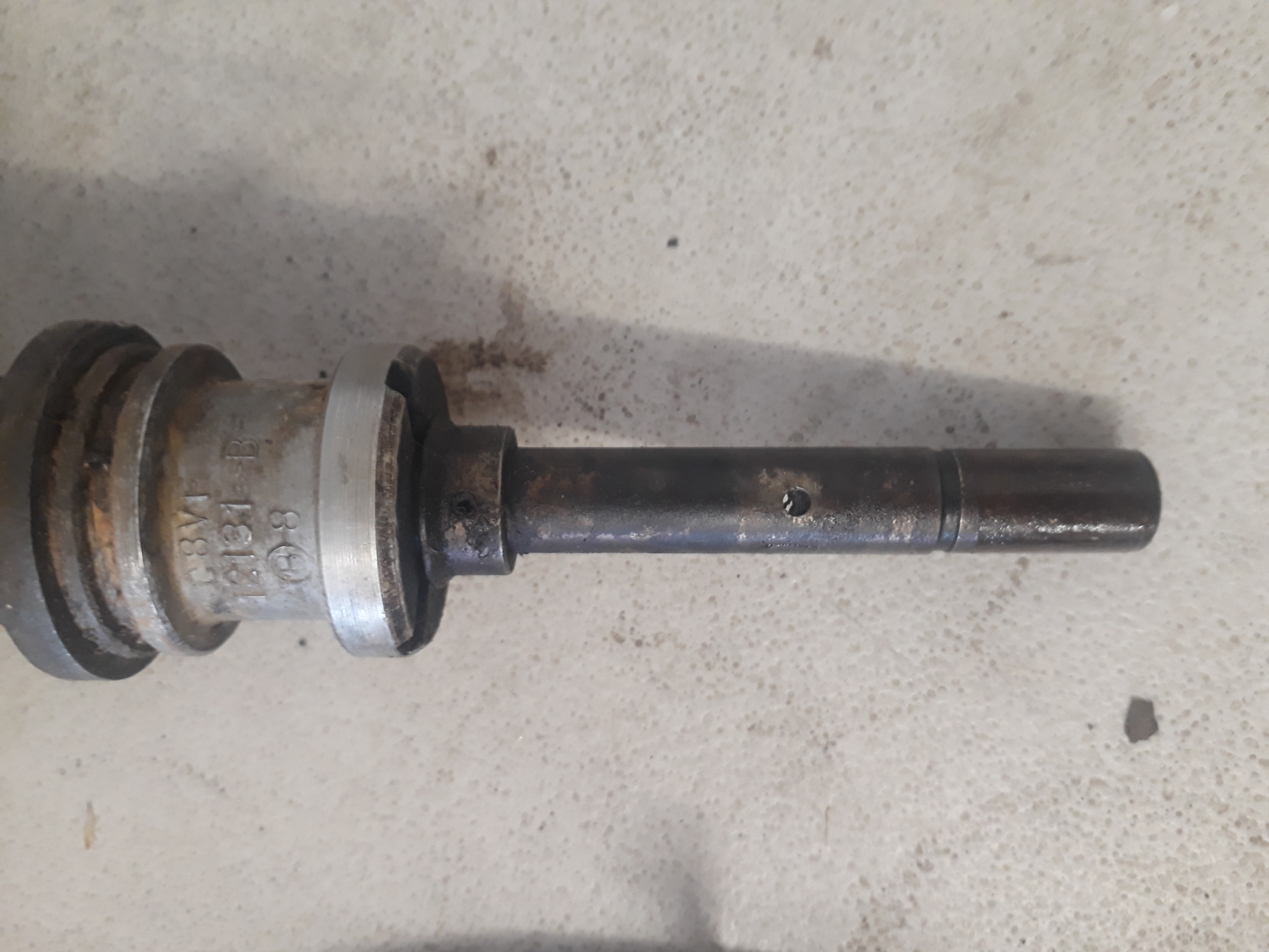

CHESTNUTXE 7,694 Posted January 16, 2020 yup thats it i have this idea of putting the 400 in the back of a xc wagon with a concord front end with the scott injector hat just protruding thru the crome roof racks,with the number plate 2VMAX,just an idea i had a dream about,anyway action man this afternoon spent a few hours striping the engine down and i will go thru the pictures to give all of us an idea about this very rare and important piece of history,i wont get to the juicy bit yet but lets go thru the picks as i started to unbolt things,the 1st snag was yee cant undo 1 manifold bolt cause the stove heater thing was in the way ,so i gently undid everything with the midas touch and yes it came out,2nd picture is hmmm well there is no gear on the dizzy so i guess something has broken off maybe ,3rd picture is the genuine dizzy part number. Share this post Link to post Share on other sites

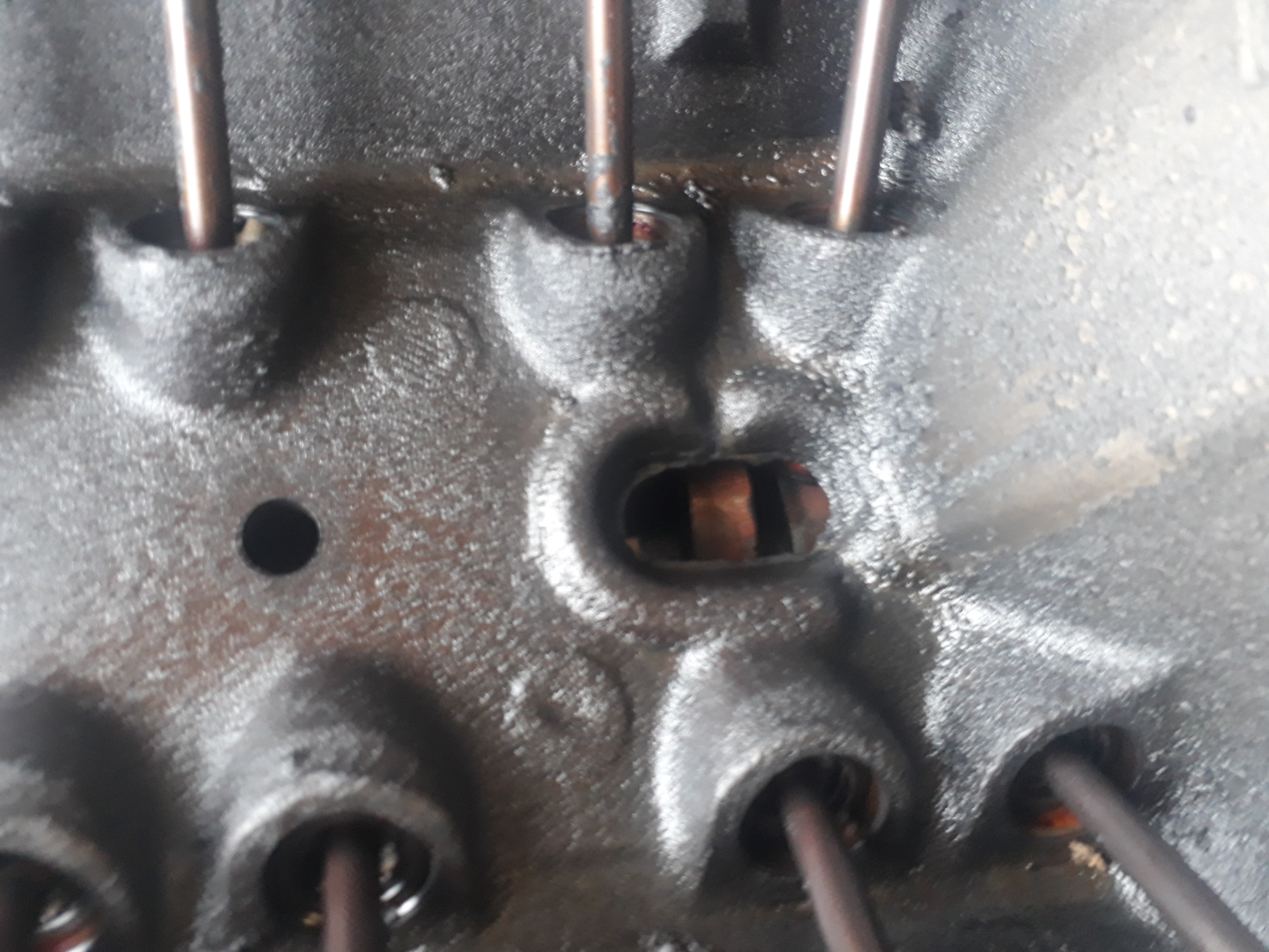

CHESTNUTXE 7,694 Posted January 16, 2020 next picture is the genuine usa fitted fuel pump,then i gently popped the manifold off and still has its factory tub,note very large port openings for a 2v ???,next picture is the camshaft lobes have not been turned for a very long time but still looks all good at this stage. Share this post Link to post Share on other sites

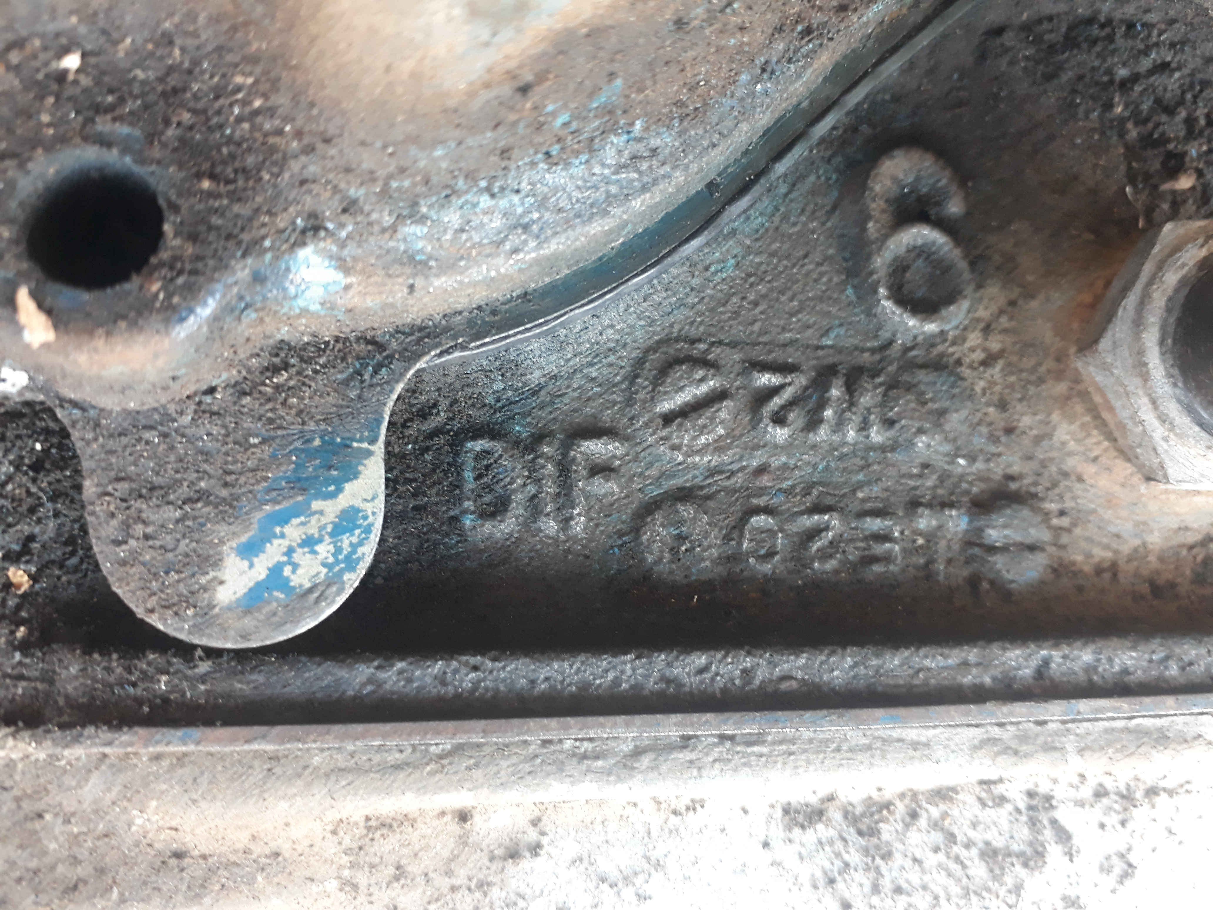

CHESTNUTXE 7,694 Posted January 16, 2020 ok off comes the head and all looks pretty much as expected,i would say these are the 76cc chamber heads,next picture is the left bank with plenty of crusty pistons but with a slight clean all looks good,3rd picture is what i thought this motor was all along its the RED DEVIL LEADED FUEL 400 with flat top pistons and tiny 8cc dish one of the first 400's ever made ,a holy grail engine,8cc dish was rated at somewhere between 9.2.1 and 10.2.1 depending on how it was rated at the time of 71 and 72 changeover ,gerg was talking about this before, 1 gerg reacted to this Share this post Link to post Share on other sites
