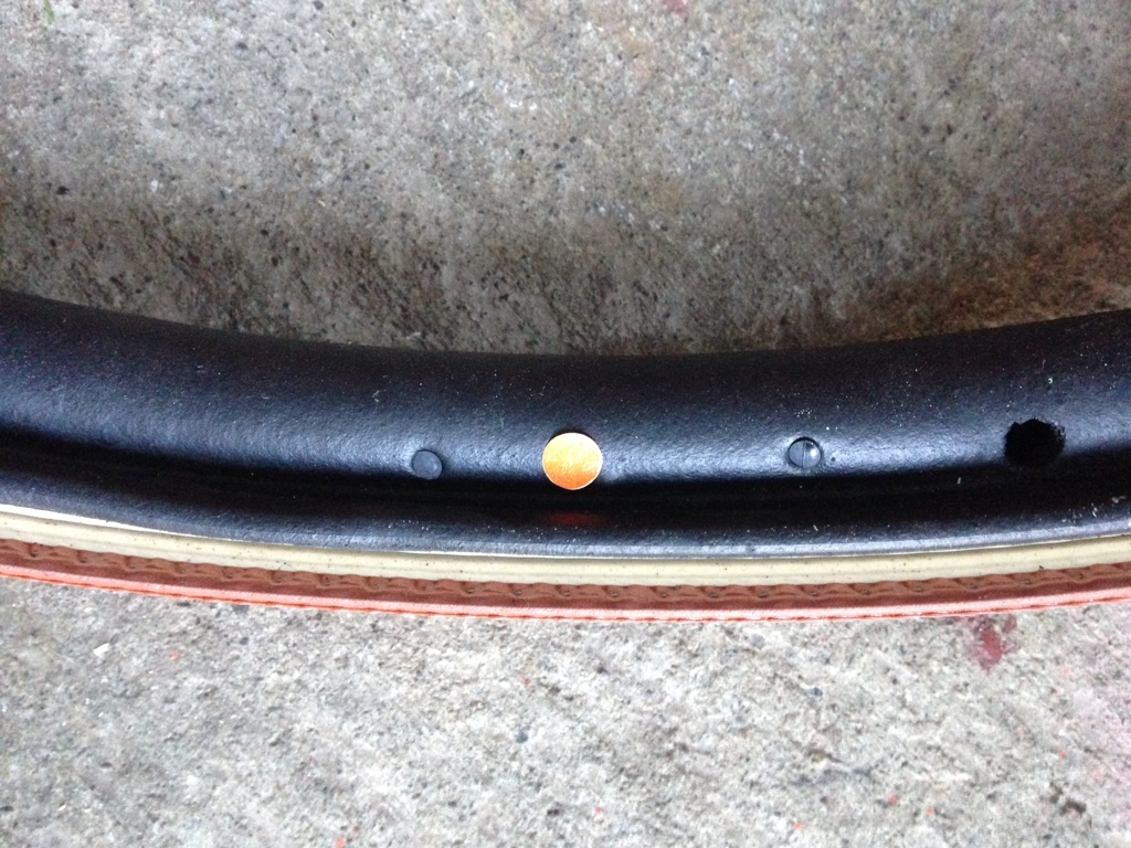

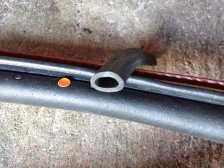

NZXD 2,328 Posted September 6, 2014 So I went out and had a good look at the old seals that are on the car and then measured to see if I could modify the rears to suit the front. I found that at the top to corners there is an extra inserted piece of rubber for support to the top window frame. Therefore to make the rears once cut to fit would need the inserts at these locations. I did take photos but at this stage unsure how to get them into this post on tapatalk. Share this post Link to post Share on other sites

NZXD 2,328 Posted September 6, 2014 Ok so this is the insert from the factory seal out of an XF. Share this post Link to post Share on other sites
BigCav 464 Posted September 6, 2014 is that right up near the b pillar corners where they tend to pinch up? Share this post Link to post Share on other sites
NZXD 2,328 Posted September 6, 2014 Yes and at each top corner. So two per door. Share this post Link to post Share on other sites
NZXD 2,328 Posted September 6, 2014 is that right up near the b pillar corners where they tend to pinch up? Is the gear you sell part number 60-054 have any added strength for the top corners like I've described with the factory stuff? Share this post Link to post Share on other sites
