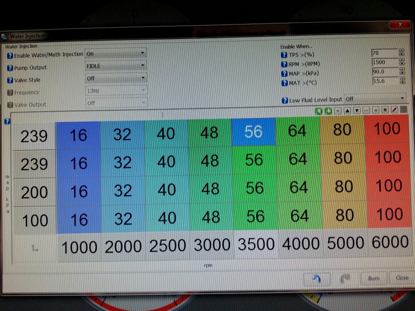

Butcha 111 Posted September 8, 2014 Hobbs switch old school... The numbers in the middle are pump duty cycle 1 XPT reacted to this Share this post Link to post Share on other sites
