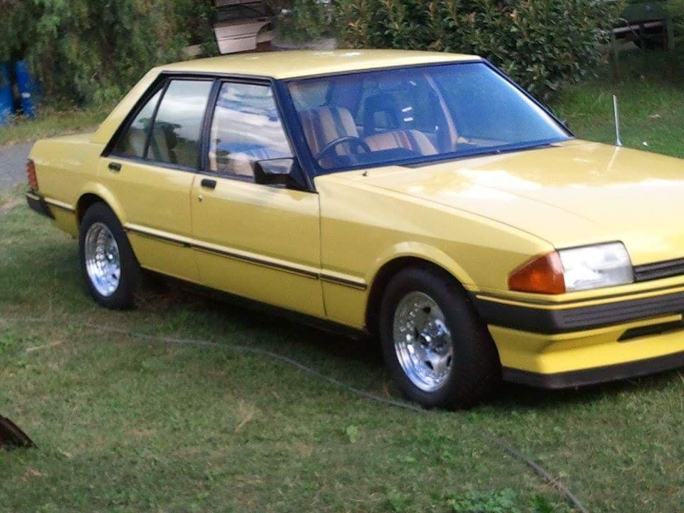

Neil Armstrong 92 Posted March 14, 2022 Hi guys, bit of a dig up, have not been active in a very long time... anyway was thinking of dragging the old s pack out of the shed and dumping 351 into it for a bit of fun... Just wondering, originally a efi six, What would be the dramas id have, I know ill need new springs, shocks bushes yatta yatta. and breaks, Fuel line no idea there or pump. maybe a holley blue or something, to paint the picture i have a reasonable 351 thats been sitting forawhile, its 30 thou over flat top pistons, from memory its got a 850 holley on it, 2v close chambers etc. maybe mild 300 hp maybe less. i suspect the rego would be a nightmare so before i commit to blowing some money just want some good opinions, and this would be a better option then the old facebook ha! Cheers. heres a 10y old picture of the spack. 1 Glenroy reacted to this Share this post Link to post Share on other sites
