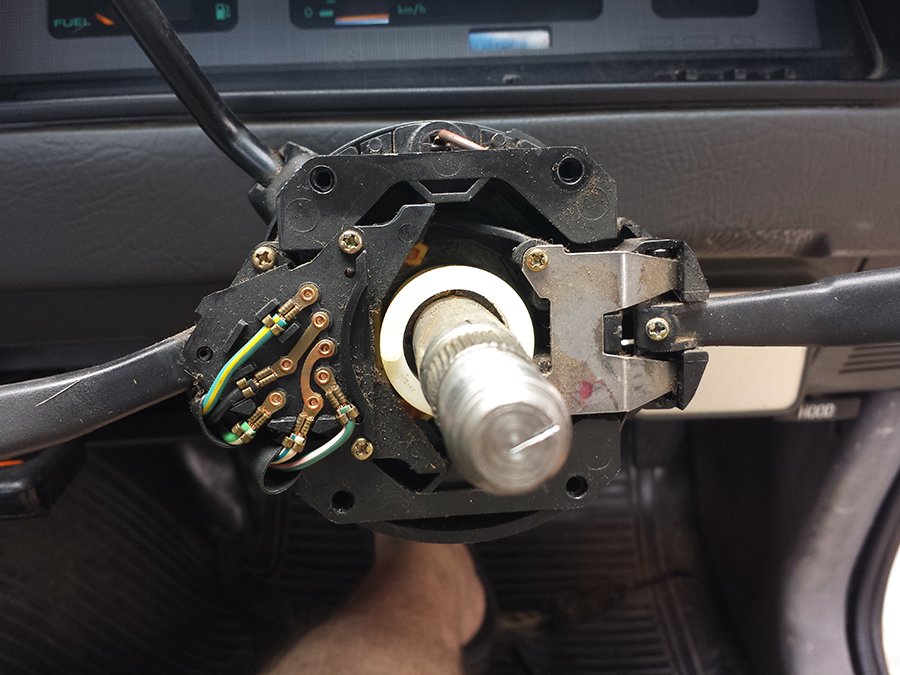

Mick.G 39 Posted March 20, 2021 G'Day gent's Thought i would ask if there is any thing i should look out for , before pulling apart the high beam / Indicator switch. Hoping it is a easy task to clean the contact points. 1 Outback Jack reacted to this Share this post Link to post Share on other sites
Outback Jack 6,352 Posted March 20, 2021 G'Day gent's Thought i would ask if there is any thing i should look out for , before pulling apart the high beam / Indicator switch. Hoping it is a easy task to clean the contact points.Hey Mick, try just cleaning it with contact cleaner from how far you have it stripped down now.Spray it in, flick it into all positions multiple times, spray again and do same. After a few goes should clean all the dust out.Sent from my S21 using Tapatalk 1 1 Mick.G and deankxf reacted to this Share this post Link to post Share on other sites

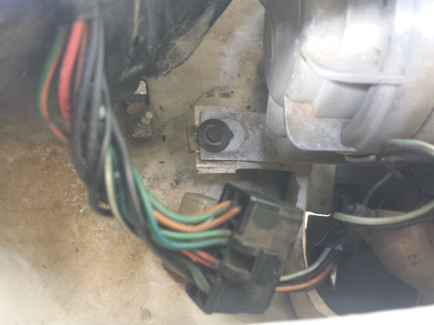

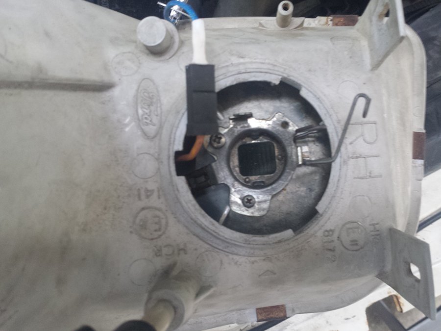

Mick.G 39 Posted March 20, 2021 Sprayed the the contact's, Jiggled the switch on/off for a good solid 3 minutes , High Beam came on on the Left headlight but not the right. took the right headlight out and checked the backing plate for the high beam globe , was dirty (pic Below) , gave it a quick clean with a wire brush , Presto , Hi beam now work's on both Headlight's. 2 Outback Jack and deankxf reacted to this Share this post Link to post Share on other sites
deankxf 21,128 Posted March 20, 2021 1 hour ago, Mick.G said: Sprayed the the contact's, Jiggled the switch on/off for a good solid 3 minutes , High Beam came on on the Left headlight but not the right. took the right headlight out and checked the backing plate for the high beam globe , was dirty (pic Below) , gave it a quick clean with a wire brush , Presto , Hi beam now work's on both Headlight's. high beam also works on the main globe, that is more of a spot light. . but good work, i've had those with RUST on the connectors before.. quick sand = fixed Share this post Link to post Share on other sites

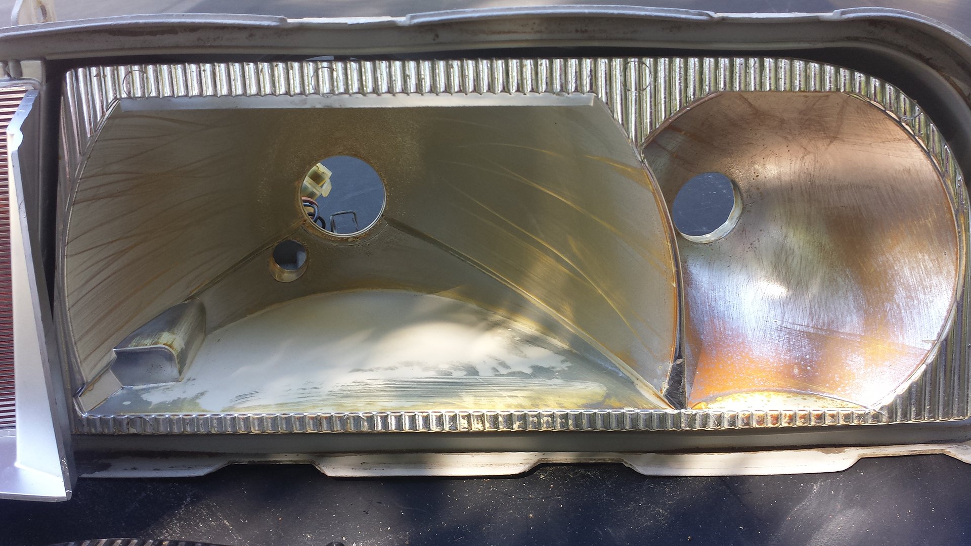

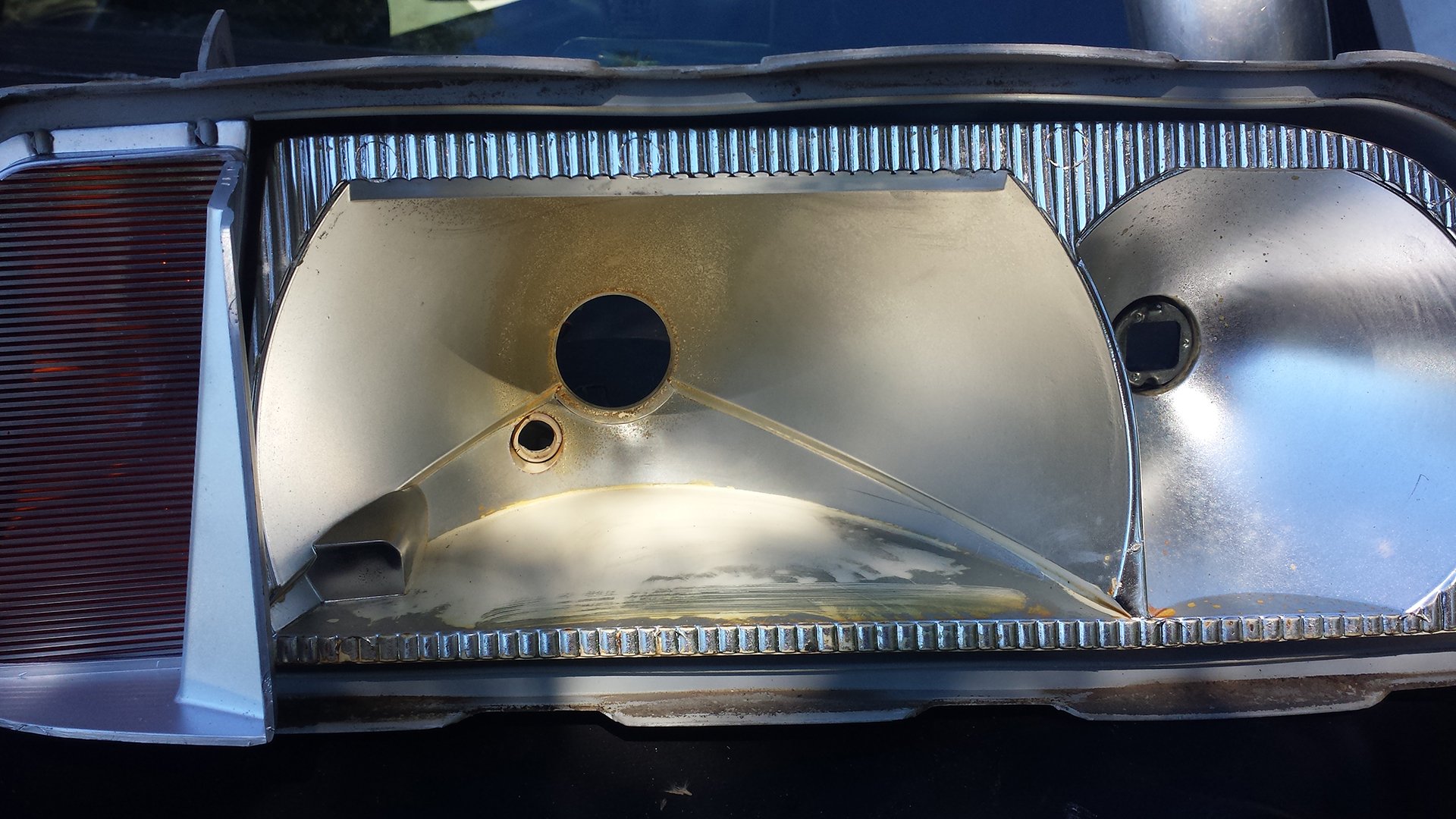

Mick.G 39 Posted March 20, 2021 they are genuine ford glass ....gave them a good clean , The silver reflective s*** is worn out on them. might paint them to see if that help's . But knowing me i will just end up buying genuine new one's. will post some pic's of them tomorrow. 1 deankxf reacted to this Share this post Link to post Share on other sites
deankxf 21,128 Posted March 20, 2021 10 minutes ago, Mick.G said: they are genuine ford glass ....gave them a good clean , The silver reflective s*** is worn out on them. might paint them to see if that help's . But knowing me i will just end up buying genuine new one's. will post some pic's of them tomorrow. chinese new ones are pretty crap, but they'll at least be bright. they are tricky to disassemble, i got it down to ... spray all the clips with CRC/WD40 makes the clip slide off the plastic(clips holding glass to the housing) gently pull the reflector on one ball joint mounting area at a time(starting at the indicator side from memory) do the same for the chinese one, and see if the ball socket is a snug fit(i've had to swap them over on some brands.. massive difference in size) clean the glass internally.. reassemble.. (obviously unplug all the wires/remove parker globe etc first) i did about 10 lights, i chipped one glass, chipped one reflector.. and broke one glass that had a slight crack or chip in it. that was doing fully refinished genuine ford reflectors mostly, but i made up a pair of chinese reflector ones out of the junk that remained. 1 Mick.G reacted to this Share this post Link to post Share on other sites
Mick.G 39 Posted March 20, 2021 I've had the headlight's apart already to clean and inspect , going to try and re chrome the reflective part first .If that fails then i may buy the aftermarket headlight and swap the reflector's. 1 deankxf reacted to this Share this post Link to post Share on other sites
deankxf 21,128 Posted March 20, 2021 6 hours ago, Mick.G said: I've had the headlight's apart already to clean and inspect , going to try and re chrome the reflective part first .If that fails then i may buy the aftermarket headlight and swap the reflector's. i had a headlight reco place redo the finish on the genuine reflectors, they were done to modern standards which is an interesting process. (painted super gloss black, flow coated super smooth, and then the silver(chome) painted on in some fancy fashion) was expensive, i think $150 each. .but the results were amazing. the person i dealt with was a bit unreliable because he focussed on bulk orders rather than my 10 or so i got done.. can't remember the details, was based in Seaford Vic from memory though. 1 gerg reacted to this Share this post Link to post Share on other sites
Mick.G 39 Posted March 21, 2021 3 hours ago, deankdx said: i had a headlight reco place redo the finish on the genuine reflectors, they were done to modern standards which is an interesting process. (painted super gloss black, flow coated super smooth, and then the silver(chome) painted on in some fancy fashion) was expensive, i think $150 each. .but the results were amazing. the person i dealt with was a bit unreliable because he focussed on bulk orders rather than my 10 or so i got done.. can't remember the details, was based in Seaford Vic from memory though. Sound's like that will be the way i go, realy want to keep as many genuine part's as possible . Watched a video on Utube last night about re chroming light reflectors . My left Reflective coating is very bad , Thee right still has a full coat but wont reflect any light. Left Headlight Right headlight 1 Outback Jack reacted to this Share this post Link to post Share on other sites
deankxf 21,128 Posted March 21, 2021 6 hours ago, Mick.G said: Sound's like that will be the way i go, realy want to keep as many genuine part's as possible . Watched a video on Utube last night about re chroming light reflectors . My left Reflective coating is very bad , Thee right still has a full coat but wont reflect any light. yeah seen plenty in that condition, they are better than a lot of the ones i took in.. the less work they need to get SMOOTH the better(some were burned by people trying higher wattage globes which is useless) Share this post Link to post Share on other sites

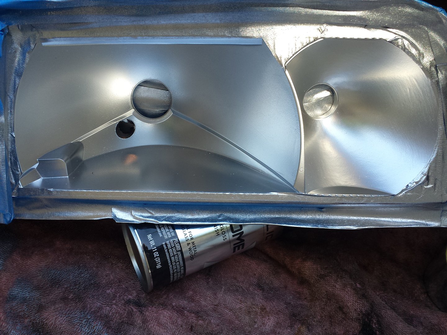

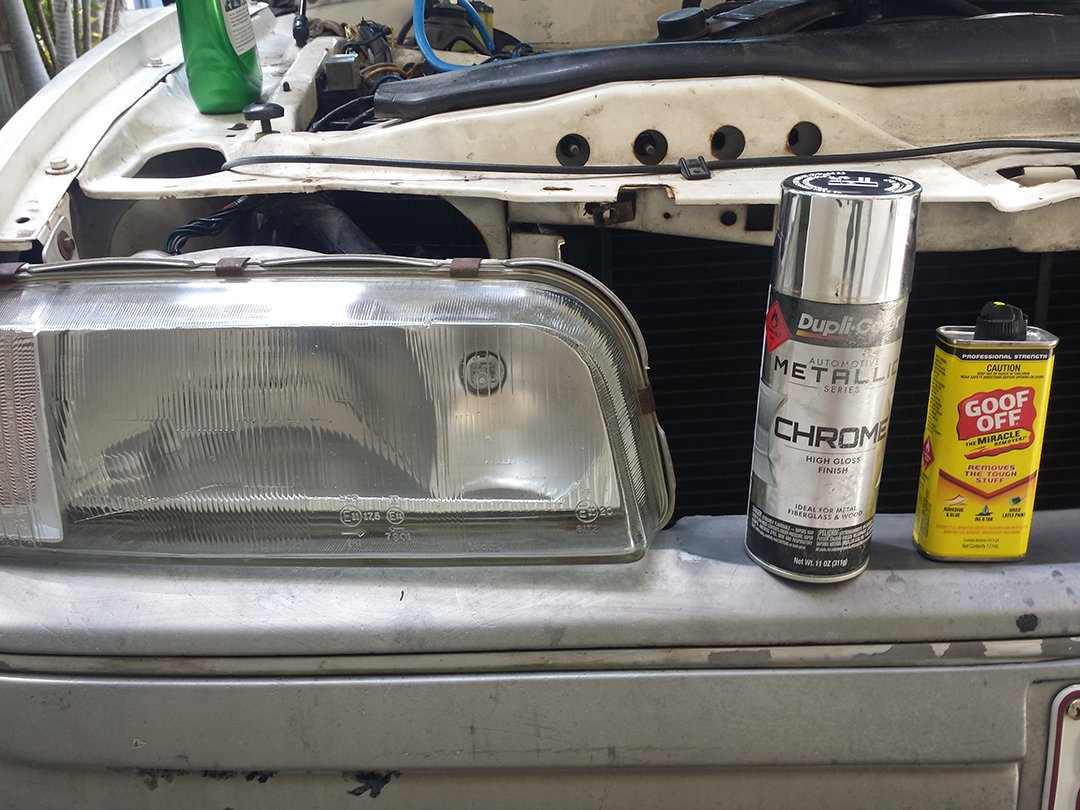

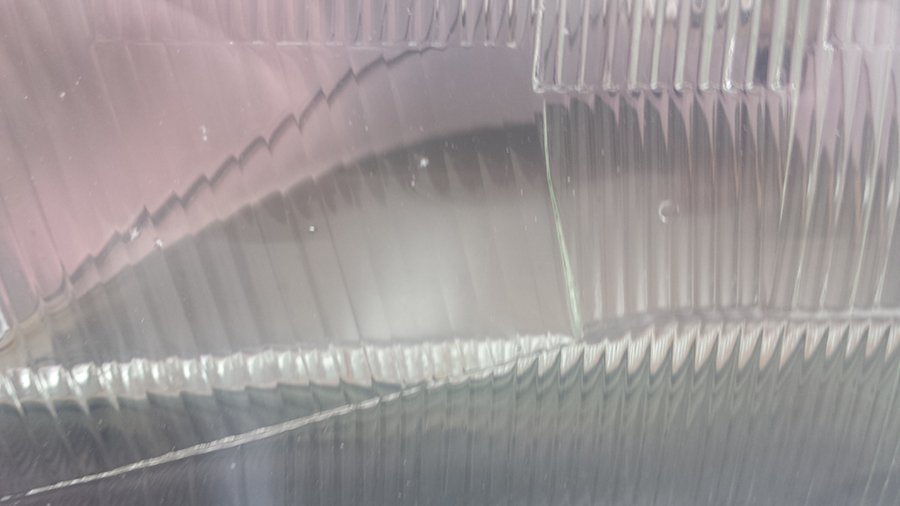

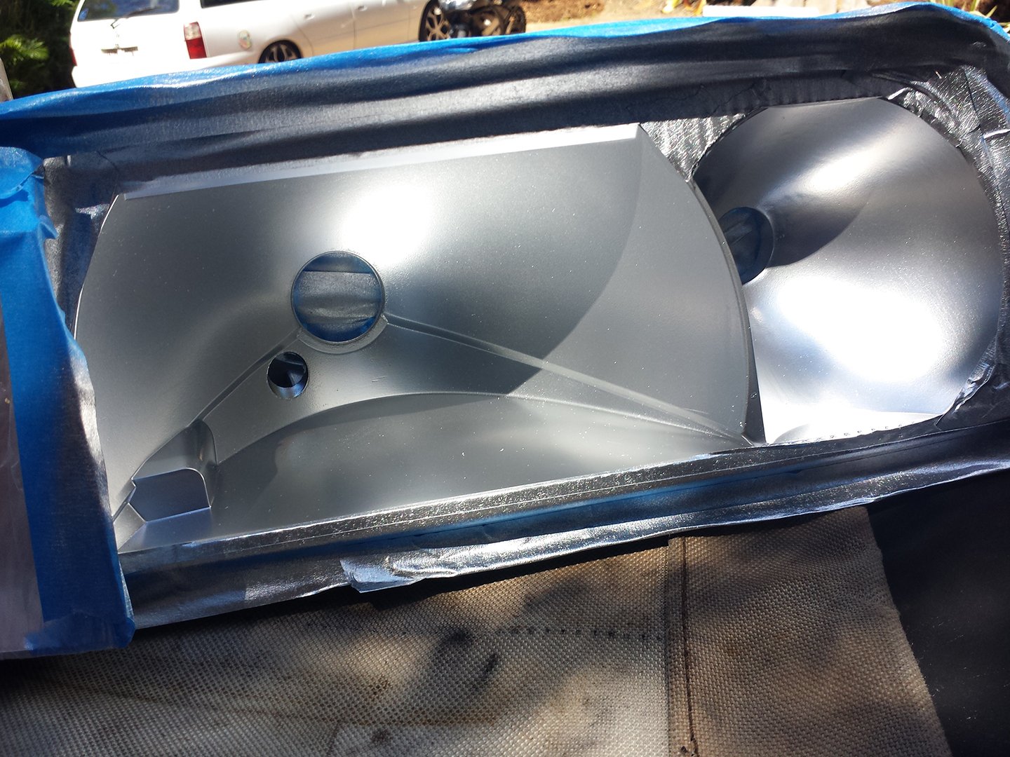

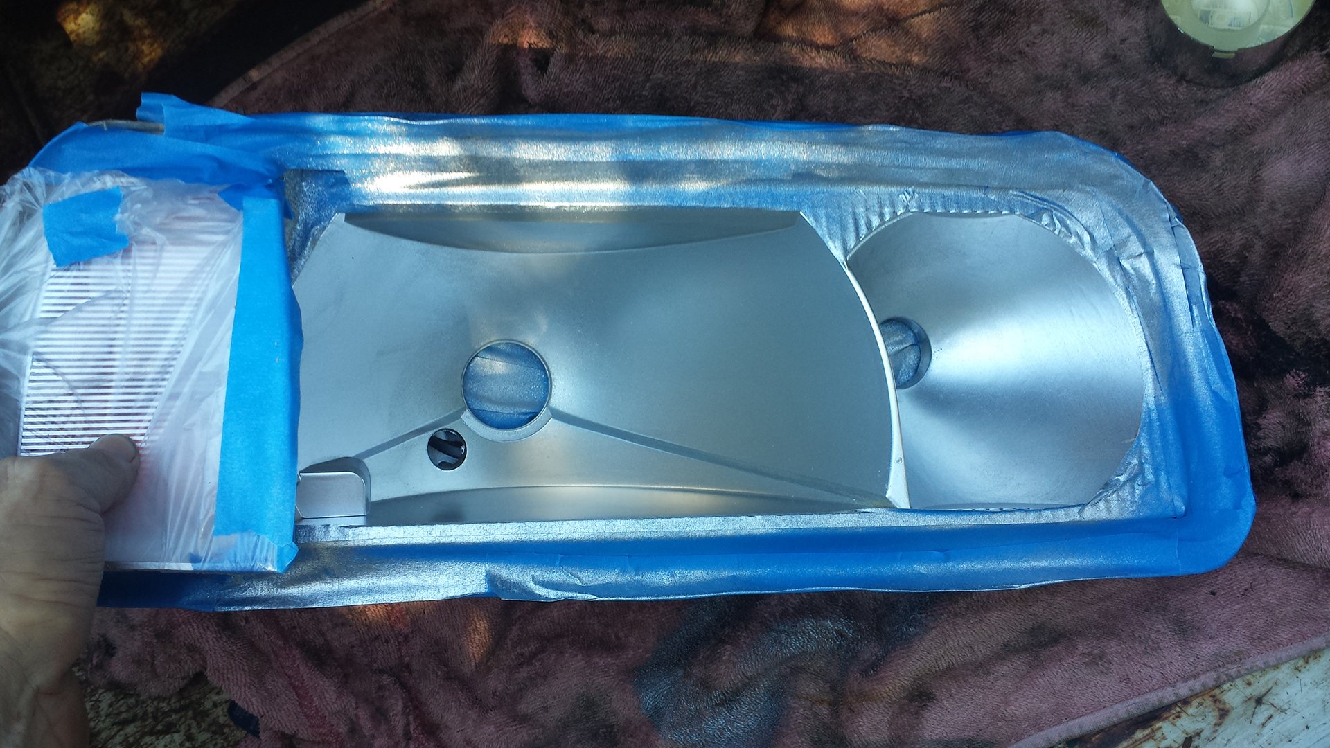

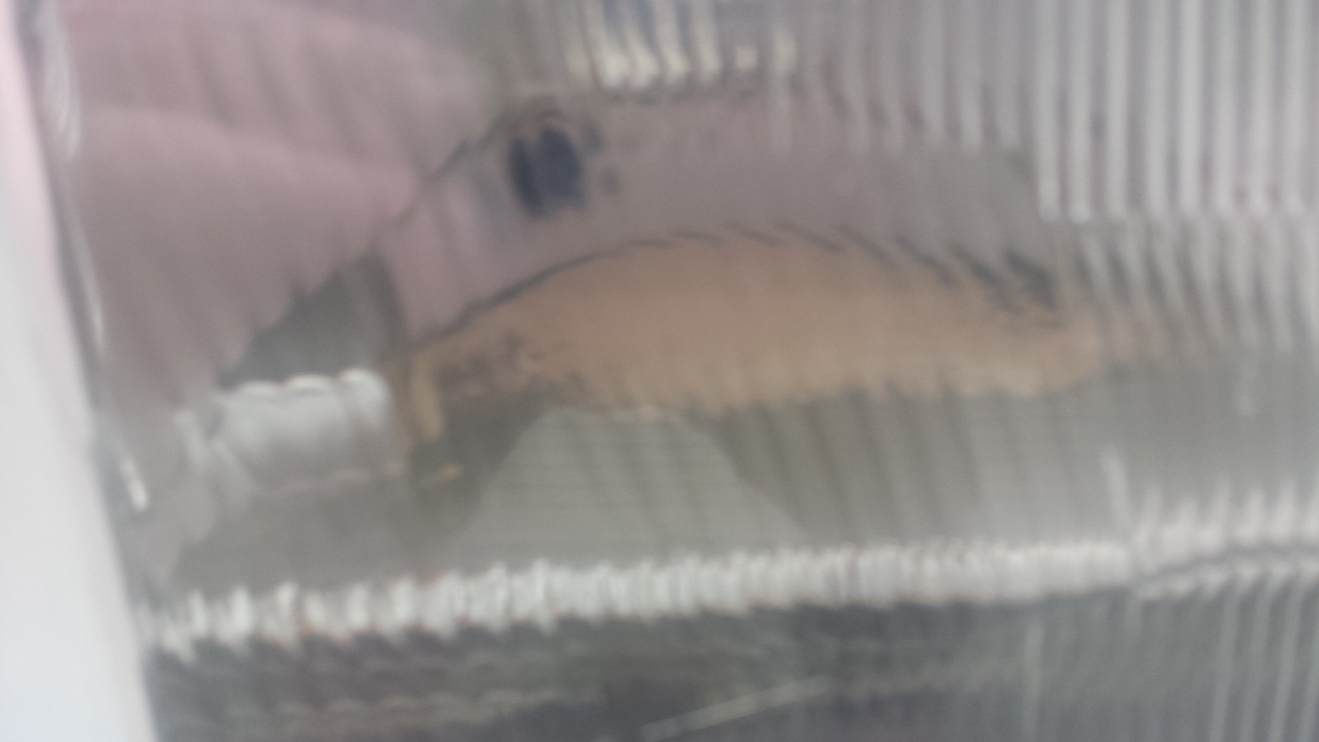

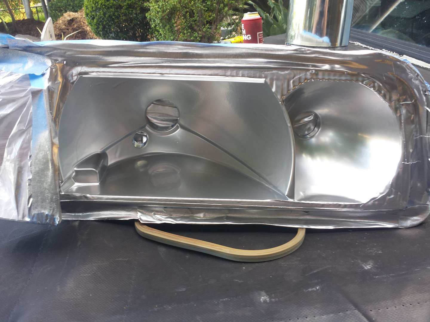

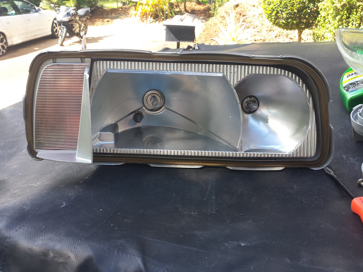

Mick.G 39 Posted March 27, 2021 FL/Headlight can see how much the silver has faded through the len's After Disassembly i noticed a little bit of moisture on the reflector at the front . gave it a wipe with my finger and it took more silver plating off. ( My fault for not drying out lens properly before i re assembled ) The a light scuff for the paint to apply too. Masked up and first dust coat applied. Second dust coat. Third Light coat. Fourth is a Wet coat Fifth and final wet Coat. Finished product with the paint and cleaner i used for prep. Will Get some Night pics, Was surprised to actually see the light beem on the garage wall during the day. Oh had a little problem getting light's to work after installation. Forgot to hook them back up to power. ( What a Dickhead ) But in all seriousness , i believe i will buy the aftermarket Light and put these Genuine ford lenses on them. Had to have a go as it would have eaten at me for not trying.No regret's. 1 deankxf reacted to this Share this post Link to post Share on other sites
deankxf 21,128 Posted March 27, 2021 before you swap the lenses.. try fitting the aftermarket lights..the brackets on some are so crap you might need to modify how they mount (better to not scratch up or drop/break with the good glass) you might prefer to try fit the aftermarket reflector in the ford housing Share this post Link to post Share on other sites
deankxf 21,128 Posted March 27, 2021 25 minutes ago, Mick.G said: Will Get some Night pics, Was surprised to actually see the light beem on the garage wall during the day. Oh had a little problem getting light's to work after installation. at least it LOOKS road worthy.. see what they work like? i saw someone put mirror finish tape/wrap on some once.. not sure how it lasted Share this post Link to post Share on other sites
Mr Polson 10,214 Posted March 27, 2021 at least it LOOKS road worthy.. see what they work like? i saw someone put mirror finish tape/wrap on some once.. not sure how it lastedMy wagon has aluminium foil on one of the headlights it's been there since I got it registered.Wouldn't recommend it - beam is definitely not as good as the other side which has one of the reco reflectors I got off you in it. 1 deankxf reacted to this Share this post Link to post Share on other sites
Mr Polson 10,214 Posted March 27, 2021 FL/Headlight can see how much the silver has faded through the len's After Disassembly i noticed a little bit of moisture on the reflector at the front . gave it a wipe with my finger and it took more silver plating off. ( My fault for not drying out lens properly before i re assembled ) The a light scuff for the paint to apply too. Masked up and first dust coat applied. Second dust coat. Third Light coat. Fourth is a Wet coat Fifth and final wet Coat. Finished product with the paint and cleaner i used for prep. Will Get some Night pics, Was surprised to actually see the light beem on the garage wall during the day. Oh had a little problem getting light's to work after installation. Forgot to hook them back up to power. ( What a Dickhead ) But in all seriousness , i believe i will buy the aftermarket Light and put these Genuine ford lenses on them. Had to have a go as it would have eaten at me for not trying.No regret's.Did you apply the MetalCast base coat first?https://www.repco.com.au/en/car-care-panel/paint/specialty-paints/dupli-color-metal-cast-anodised-base-coat-311g-mc100/p/A9302375If not then you're only getting half the result, the DupliColor MetalCast range needs the ground coat first then the colour coat to get the proper metal/anodized finish Share this post Link to post Share on other sites
Mick.G 39 Posted March 27, 2021 1 hour ago, Mr Polson said: Did you apply the MetalCast base coat first?https://www.repco.com.au/en/car-care-panel/paint/specialty-paints/dupli-color-metal-cast-anodised-base-coat-311g-mc100/p/A9302375 If not then you're only getting half the result, the DupliColor MetalCast range needs the ground coat first then the colour coat to get the proper metal/anodized finish WHAT !! Share this post Link to post Share on other sites
Mick.G 39 Posted March 27, 2021 Na...I am not sponsored by REPCO Share this post Link to post Share on other sites
Mr Polson 10,214 Posted March 27, 2021 WHAT !! Na...I am not sponsored by REPCOWas the easiest website to find it on, you can buy it at other shops.But I guarantee you'll have a much better colour if you used the base coat underneath.The rocker cover on my BarraCruiser has the blue MetalCast, without the base coat it would've just been a light blue paint with no metallic appearance 1 deankxf reacted to this Share this post Link to post Share on other sites
