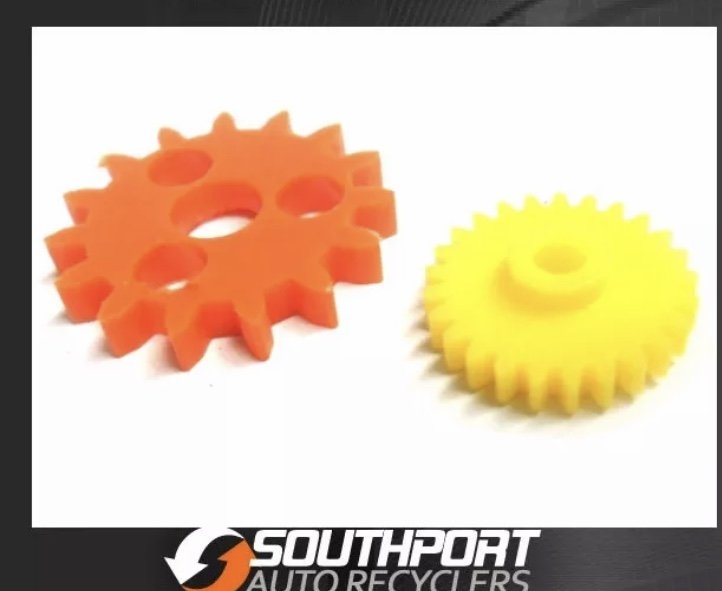

Jay Baby 21 Posted January 5, 2020 16 hours ago, deankdx said: welcome aboard, probably should buy a gregorys book for XF (don't think there's an XG one, so if you need the electronic stuff you'll need an EA EB book also) to remove the speedo cluster, its a bit of fun in the XG.. remove the light switches on the surround is what i did(but have seen them left mounted and unplugged later) take note of where they were and what wires they were plugged into. one screw holds them on. 2 screws on top for the surround, 2 under the light switch areas, and 2 hidden under the dash that most people don't put back in.. need to remove the fuse panel for this(pull the hand brake lever out a few clicks to manouver it out the cluster mounts with 4 screws, 2 on top, 2 on the bottom. can't remember, but you might need to remove the steering wheel on XG to get the cluster out. there's no speedo cable, but there are 2 wiring plugs on the back. if you were keen.. and had a spare to play with.. the odo gear is $5 ish on ebay.. on the XG you need to remove the speedo, and remove the needle and the face plate to get access to the gear.. that's after undoing lots of screws on the cluster housing etc.. i haven't got time to google pics for you but there'll probably be a tutorial on fordmods if it still exists and may be on here also if the photos still work just out of interest if I was to replace the gears myself am I looking at the correct ones? And is there two in there so you replace both or just one? Share this post Link to post Share on other sites
deankxf 21,128 Posted January 5, 2020 27 minutes ago, Jay Baby said: just out of interest if I was to replace the gears myself am I looking at the correct ones? And is there two in there so you replace both or just one? it's 99.9% only the small (yellow in this photo) gear that goes.. i have once had to change the bigger gear. here's a link for a $10 one for eg on ebay with 2000 odd sold https://www.ebay.com.au/itm/Odometer-Speedo-Gear-Cog-Suit-VN-VP-VR-VS-Commodore-XF-EA-EB-ED-Falcon-/271733080319?_trksid=p2385738.m4383.l4275.c10 Share this post Link to post Share on other sites

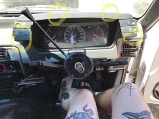

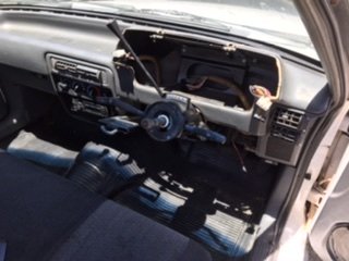

Jay Baby 21 Posted January 11, 2020 Ok,so off to a good start with the cluster removal but I can’t find the last 2 screws iv found the tops and the sides as pictured. Iv removed bottom of dash to get access to hidden ones but can’t find them I have also left the light, haz switches ect in as I’ll just unplug them after. Also pulled wheel. Please give me a heads up where to find these 2 last screws Share this post Link to post Share on other sites
Jay Baby 21 Posted January 11, 2020 Ok,so off to a good start with the cluster removal but I can’t find the last 2 screws iv found the tops and the sides as pictured. Iv removed bottom of dash to get access to hidden ones but can’t find them I have also left the light, haz switches ect in as I’ll just unplug them after. Also pulled wheel. Please give me a heads up where to find these 2 last screws just found em.... after some acrobatics Share this post Link to post Share on other sites
