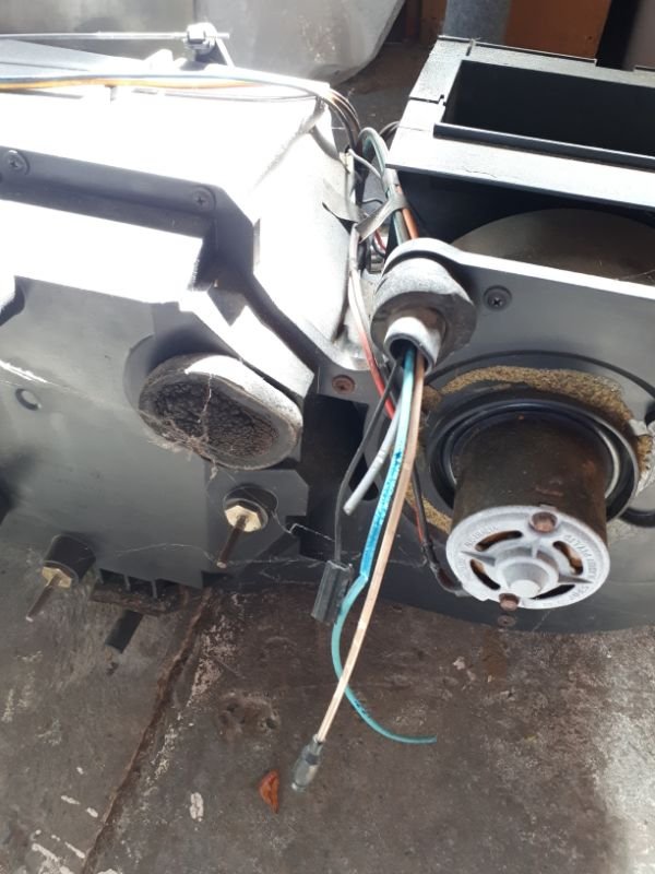

waderobertson 111 Posted September 1, 2019 On 8/26/2019 at 10:21 PM, deankdx said: are you sure it's an XF? XFs had plastic vac lines, (don't perish... well, not that' i've seen yet.) the XD and XE were rubber, and they are shit.. (were perished 20yrs ago.) i don't think the diameter will be an issue other than taking up more space if they are bigger, or just being a pain to make them seal otherwise. @SPArKy_Dave might be the only one who's got a clue if they can be sourced still These are the ones I'm talking about within the engine bay Share this post Link to post Share on other sites
deankxf 21,128 Posted September 1, 2019 i haven't ever seen cracked ones .. guess if the heater box was in the sun it might(from a wreck?) slip other vac hose over those ones and carry on.. bit of superglue to seal/keep them on Share this post Link to post Share on other sites
