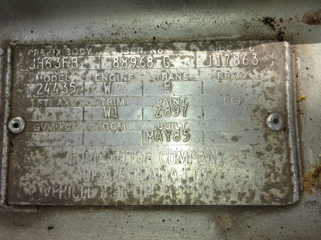

guerin92 2 Posted April 25, 2013 hey all im trying to decode my chassis number I have the xf, zl and ltd manual (wm23) and all its told me so far is the car was built in broad Meadows with a three speed floor mounted auto. ohh and built in may 1985 lol everything else doesnt match up at all?? Share this post Link to post Share on other sites
revhead 1,392 Posted April 25, 2013 the jh63fb88968c number on the tag ,must match the chassis number if it doesnt you got problems Share this post Link to post Share on other sites
Gav 616 Posted April 25, 2013 Engine code "W" I think is a 4.1 carburetor engine for use outside NSW - There were different emission requirements for NSW. See the emission schematics for unleaded XFs and you'll see a slightly different layout for NSW delivered vehicles. The paint code may be a variation of "Z" - stark white - probably for flet vehicles of a particular company. Certain companies operating a large number of vehicles with a particular colour or colour scheme had their own code. One I know of, for example is Boral. Their vans were green and yellow and this had its own Ford colour code - not in the factory manual. I think trim code W is "Wedgewood" Found this link on the other site that has some fairly good info on codes etc - check it out: http://www.xfalcon.com/forums/index.php?/topic/135-vehicle-identification-plate-codes/ It's got some useful stuff.... Share this post Link to post Share on other sites
Gav 616 Posted April 25, 2013 the jh63fb88968c number on the tag ,must match the chassis number if it doesnt you got problems What he said!!!!! Look on the spring tower - left hand side i think for a stamped version of what should be on the ID plate.... Share this post Link to post Share on other sites
ILIED 316 Posted April 25, 2013 JH is not broadmeadows.JG is Broadmeadows, as I've known Share this post Link to post Share on other sites
guerin92 2 Posted April 25, 2013 yes whats stamped in the shock tower is the same lol. So you think it was a company car? and it wasn't made in broad Meadows bugger more confusion... wedgewood would be brown wouldnt it?? Share this post Link to post Share on other sites
Gav 616 Posted April 25, 2013 JH is J = Australia H = Brisbane. Share this post Link to post Share on other sites
revhead 1,392 Posted April 25, 2013 have you got an overall picci of the car and some interior shots,a lot of guys can tell from the options and modds which company owned ordered your car ,isnt JH brisbane Share this post Link to post Share on other sites
ILIED 316 Posted April 25, 2013 I'm sure H was from NSW. G is Broadmeadows. Been a while.I know they had another asembly code for Broady, but it was for industrial vehicles like trucks, and some utes. I cant remember what that was. Share this post Link to post Share on other sites
ILIED 316 Posted April 25, 2013 There we go, QLD, not NSW Share this post Link to post Share on other sites
Gav 616 Posted April 25, 2013 yes whats stamped in the shock tower is the same lol. So you think it was a company car? and it wasn't made in broad Meadows bugger more confusion... wedgewood would be brown wouldnt it?? Wedgewood, the Ford colour may be borowed from "Wedgewood" - a well known pottery colour/brand which is a kind of blue - Google it...my mum loved the stuff.... Share this post Link to post Share on other sites
revhead 1,392 Posted April 25, 2013 check this All Falcons up to January 1971 had a dual numbering system, consisting of both the Body Prefix Number and VIN (Vehicle Identification Number). The VIN was stamped on the passenger side support panel, and this should match the number stamped on the I.D. plate (which was attached to the drivers side pre January 1970, and on the bulkhead for the remainder of 1970). As of January 1971 Ford switched to using a 3 way identification system, the body prefix and serial number as located on the ID plate should be the same as on the engine and shock tower. The body prefix number should be 6 characters in length, consisting of 2 letters, then 2 numbers, followed by another 2 letters. Letter 1: The first letter in the body prefix identifies the country, with "J" identifying Australia Letter 2: The next letter in the body prefix identifies the assembly plant, with "G" identifying Broadmeadows Numbers 3 and 4: The following 2 numbers identify the model COUNTRY ASSEMBLY PLANT MODEL ID MODEL J G 11 Futura Sedan J G 12 Futura Taxi J G 21 Falcon Sedan J G 22 Falcon Taxi J G 23 Falcon 500 Sedan J G 24 Falcon 500 Taxi J G 30 Falcon Wagon J G 31 Falcon 500 Wagon J G 32 Fairmont GXL J G 33 Falcon GT Sedan J G 34 Fairmont Sedan J G 35 Fairmont Wagon J G 36 Fairlane Custom J G 37 Fairlane 500 J G 38 Fairlane Custom Taxi J G 39 Fairlane 500 Taxi J G 40 Falcon Utility J G 41 Falcon 500 Utility J G 42 Falcon Van J G 43 Falcon 4WD Utility J G 45 Falcon 500 Van J G 47 Falcon Sundowner Van J G 62 Galaxie Sedan J G 63 Fairlane Marquis J G 64 Fairlane Ghia J G 65 Falcon 500 Coupe J G 66 Falcon GT Coupe J G 67 Fairmont Coupe J G 70 Landau Hardtop J G 71 LTD Letters 5 and 6: The next letters in the body prefix identify the year and month of manufacture, as per the table below: YEAR CODE JAN FEB MAR APR MAY JUN JUL AUG SEP OCT NOV DEC 1965 E J U M P B R A G C K D E 1966 F L Y S T J U M P B R A G 1967 G C K D E L Y S T J U M P 1968 H B R A G C K D E L Y S T 1969 J J U M P B R A G C K D E 1970 K L Y S T J U M P B R A G 1971 L C K D E L Y S T J U M P 1972 M B R A G C K D E L Y S T 1973 N J U M P B R A G C K D E 1974 P L Y S T J U M P B R A G 1975 R C K D E L Y S T J U M P 1976 S B R A G C K D E L Y S T 1977 T J U M P B R A G C K D E 1978 U L Y S T J U M P B R A G 1979 W C K D E L Y S T J U M P 1980 X B R A G C K D E L Y S T 1981 Y J U M P B R A G C K D E 1982 A L Y S T J U M P B R A G 1983 B C K D E L Y S T J U M P 1984 C B R A G C K D E L Y S T 1985 F J U M P B R A G C K D E 1986 G L Y S T J U M P B R A G 1987 H C K D E L Y S T J U M P 1988 J B R A G C K D E L Y S T 1989 K J U M P B R A G C K D E 1990 L L Y S T J U M P B R A G 1991 M C K D E L Y S T J U M P 1992 N B R A G C K D E L Y S T 1993 P J U M P B R A G C K D E 1994 R L Y S T J U M P B R A G 1995 S C K D E L Y S T J U M P 1996 T B R A G C K D E L Y S T 1997 V J U M P B R A G C K D E 1998 W L Y S T J U M P B R A G 1999 X C K D E L Y S T J U M P 2000 Y B R A G C K D E L Y S T 2001 1 J U M P B R A G C K D E 2002 2 L Y S T J U M P B R A G 2003 3 C K D E L Y S T J U M P 2004 4 B R A G C K D E L Y S T TRANSMISSION CODES B 3 Speed Cruisomatic J 3 Speed Manual, Column Shift, Partial Synchro L 4 Speed Manual, Floor Shirt, All Synchro N 3 Speed Manual, Column Shift, All Synchro O 3 Speed Cruisomatic, T-Bar Floor Shift (XT GT Only) P 3 Speed Fordomatic, Column Shift R 3 Speed Cruisomatic, Column Shift MODEL ENGINE CODE ENGINE XR Falcon C 170ci Six (Low Compression) E 170ci Pursuit Six G 200ci Super Pursuit Six I 289ci Windsor V8 2V K 289ci Windsor V8 4V XT Falcon B 188ci Six Q 188ci Six (Low Compression) S 221ci Six U 221ci Six (Low Compression) W 302ci Mustang 5 Litre V8 4V Y 302ci Mustang 5 Litre V8 2V XW Falcon B 188ci Six H 351ci V8 4V HO Q 188ci Six (Low Compression) S 221ci Six T 351ci V8 4V U 221ci Six (Low Compression) Y 302ci V8 2V XY Falcon E 200ci Six (Low Compression) G 200ci Six H 351ci V8 4V HO J 250ci Six (Low Compression) K 351ci V8 2V L 250ci Six 1V M 250ci Six 2V T 351ci V8 4V Y 302ci V8 2V XA - Falcon & XB Falcon E 200ci Six 1V (Low Compression) G 200ci Six 1V (High Compression) H 351ci V8 4V HO J 250ci Six 1V (Low Compression) K 351ci V8 2V L 250ci Six 1V (High Compression) M 250ci Six 2V T 351ci V8 4V Y 302ci V8 2V XC Falcon E 200ci Six (Low Compression) J 250ci Six (Low Compression) N 250ci Six (High Compression) P 302ci V8 4V T 351ci V8 4V GT FALCON MODEL CODES 18638 XR GT Falcon XR GT Falcon Specifications XR GT Falcon Identification 18838 XT GT Falcon XT GT Falcon Specifications XT GT Falcon Identification 18938 XW GT Falcon XW GT Falcon Specifications XW GT Falcon Identification 18939 XW GTHO Falcon XW GTHO Falcon Specifications XW GTHO Falcon Identification 18939 XW GTHO II Falcon XW GTHO II Falcon Specifications XW GTHO Phase II Falcon Identification 18038 XY GT Falcon (1970) XY GT Falcon Specifications XY GT Falcon Identification 18138 XY GT Falcon (1971) XY GTHO III Falcon Specifications XY GTHO Phase III Falcon Identification 18238 XA GT Falcon Sedan XA GT Falcon Specifications XA GT Falcon Identification 18218 XA GT Falcon Hardtop XA GT Falcon Hardtop Specifications XA GT Falcon Hardtop Identification 18338 XB GT Falcon Sedan XB GT Falcon Specifications XB GT Falcon Identification 18318 XB GT Falcon Hardtop XB GT Falcon Hardtop Specifications XB GT Falcon Hardtop Identification 4 steve mcqueen, Scott0568, Dok and 1 other reacted to this Share this post Link to post Share on other sites

guerin92 2 Posted April 25, 2013 thanks but ive already been something similat to that and it didn't help the car is a 1985 zl fairlane its a silver greyish with blue pinstripes and the interior is Grey ill try put pics up Share this post Link to post Share on other sites
guerin92 2 Posted April 25, 2013 http://s1297.photobucket.com/user/guerin922/library/ I can't upload here pictures to big i have none of the interior though Share this post Link to post Share on other sites
LTD083 282 Posted April 25, 2013 All the X Series LWB cars were built at Eagle Farm in Brisbane. Hence the JH. Sent from my GT-I9100T using Tapatalk 2 Share this post Link to post Share on other sites
guerin92 2 Posted April 25, 2013 ok so it was definitely built in qld than is it possible to figure out the dealer using the dealer code or "sidc" ?? Share this post Link to post Share on other sites
