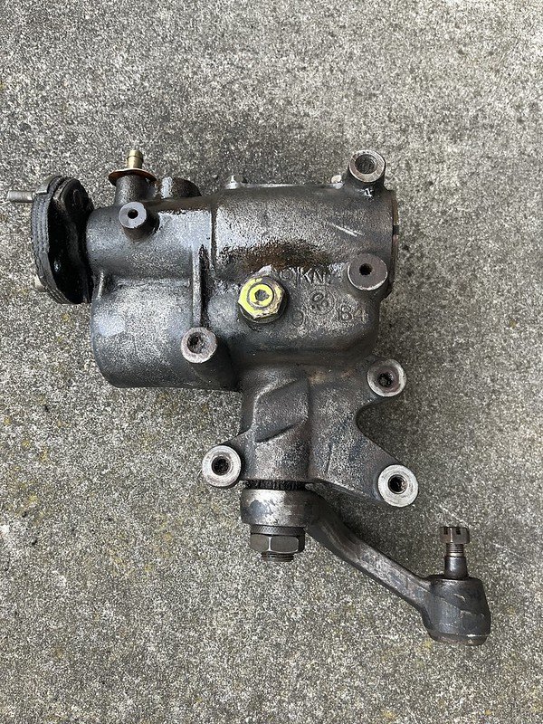

Adrian853 78 Posted January 26, 2024 I missed out on the XG steering box but instead picked up a steering box from a 1985 XF Fairmont that had done 340,000km for less money. If I understand correctly, it was just the XG that was roller bearing but any used steering box is likely going to need re-conditioning and it seems most shops include the roller bearing swap as part of the reco process. So, I need to get it reco'd and would welcome any recommendations in Auckland, NZ - so far I just know of PG Hydraulics. This is the box I've got, more photos at this link: XF Steering Box Share this post Link to post Share on other sites
