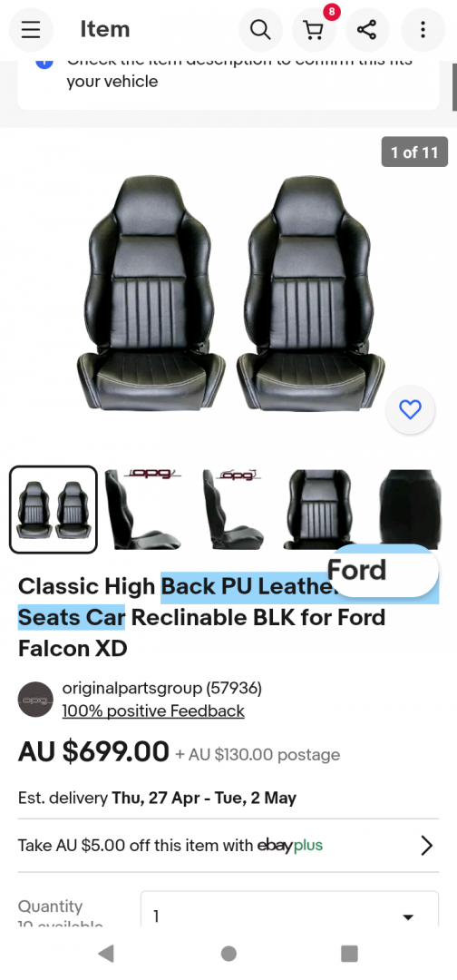

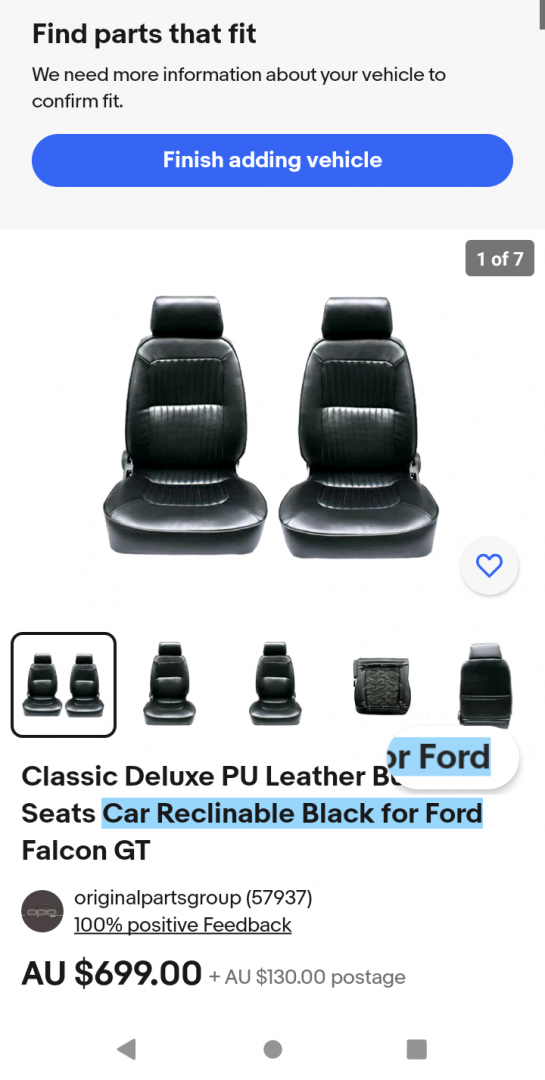

Nath 1,975 Posted April 23, 2023 Nah they're just the regular povo pack seats. There's a place based in Victoria selling these which will fit. Only problem is they don't do back ones so my interior would be mismatched and I don't know how comfy they are, they look a bit thin. Share this post Link to post Share on other sites
deankxf 21,560 Posted April 23, 2023 6 minutes ago, Nath said: Only problem is they don't do back ones so my interior would be mismatched and I don't know how comfy they are, they look a bit thin. that curve shape in the top pic looks wrong (might be good if you spilled your coffee though) @CHESTNUTXE shared fake ESP seats on ebay last week (autotechnica brand) they may do them in different material that matches what you already have?https://www.ebay.com.au/itm/204311294271?hash=item2f91e6f13f:g:UiIAAOSwvCdkQa9-:sc:AU_StandardDelivery!3153!AU!-1&amdata=enc%3AAQAIAAAA0Pje9Y6DSe36asz7ccFPa6xlORaw59wKQVPH6K53iMfyRhjlzcfP6gBdYZJi49T7VS0qEoMvbTVQI7egOVQUtxvFAJSdouNoGKC6%2FwyOvQ3x7CRP9FqHzFrqhEza8v2mLfBVu5JieeD4HrmsHxFzPFMbKuZQM1R5PwJ35d%2FLqqlhjX5pk2Krh3NiIUTveMFT%2BpBAfjTGp2wp6JOKtKpHBzxZwL9k0edtBR%2FYJaokgBkCMtsWEw0niBJKp1GJgvNzo6owPzPFYF6MhqqZcIaT1lI%3D|tkp%3ABk9SR67y97f1YQ 1 CHESTNUTXE reacted to this Share this post Link to post Share on other sites

BTS666 15 Posted April 24, 2023 I like the 2nd pics of the black ones. The screen style seats look nice, but are they 638 buckaroos for one or a pair? Share this post Link to post Share on other sites
Nath 1,975 Posted April 24, 2023 Yeah that's the price for the pair, delivery is like 100 extra. I like the second ones too. 1 BTS666 reacted to this Share this post Link to post Share on other sites
BTS666 15 Posted April 24, 2023 I have the grey interior on my fairmont, so will be putting black carpet, black door accents, and black seats in.i would dobthe whole interior in black, but for the moment I'm doing a budget build. (LOL). I think those 2nd seats look era worthy. Share this post Link to post Share on other sites

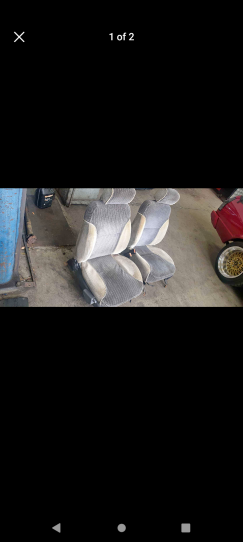

Nath 1,975 Posted April 30, 2023 EB seats will bolt straight in apparently, these are you for 250 near me. Won't look out of place either. Share this post Link to post Share on other sites
deankxf 21,560 Posted April 30, 2023 8 minutes ago, Nath said: EB seats will bolt straight in apparently, these are you for 250 near me. Won't look out of place either. EA to ED seats bolt directly in 1988 onwards XF van and ute. if you mean the rails. not sure if the seat parts swap to the older rails or not though. the tilt mechanism might be the exception to EA to ED seats, base model ones might be swappable. definitely check before committing. (take a seat rail with you perhaps 1 BTS666 reacted to this Share this post Link to post Share on other sites
Nath 1,975 Posted April 30, 2023 Ah okay, those are Fairmont ones apparently. Not really fussed what I put in there as long as it passes blueslip. People are taking the piss with seat prices though, 1200+ bucks for a reasonable set of XD ones. 1 deankxf reacted to this Share this post Link to post Share on other sites

Mr Polson 10,214 Posted April 30, 2023 EB seats will bolt straight in apparently, these are you for 250 near me. Won't look out of place either.No they won't.As Dean said they'd fit 88 onwards XF ute or van, which bolt in from inside the car.Anything 87 or earlier, has nuts that go on the sealt bolts, from under the car.And no, the seats won't bolt directly to the early rails and work - without modification.From memory (been a long time) you can enlarge the holes in the seat rails and bolt the seats to it, but they'll have a lot less range of back/forward movement because they'll end up slightly angled inwards/outwards. 1 Nath reacted to this Share this post Link to post Share on other sites
Nath 1,975 Posted April 30, 2023 Ah okay, thanks Chris. I'll give that a miss then. Just have to find something suitable so I don't have to butcher anything. Share this post Link to post Share on other sites
