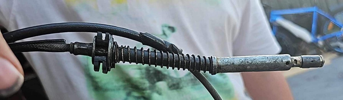

deankxf 21,128 Posted May 12, 2024 2 hours ago, fotz said: AU XR8 end looks like this. mate of mine said get the late XF or XG pedal (basically 1988 ute onwards) and an AU V8 cable should fit it. (if you can find one) as Sparkydave said above, i'd consider a custom cable, they are reasonably priced from memory. and could make An AU V8 cable complete if it's broken, (just get a late pedal and find a way to mount it (think i tek screwed one to the floor once if they mount different) Share this post Link to post Share on other sites
deankxf 21,128 Posted May 12, 2024 5 hours ago, fotz said: also any ideas for an accelerator cable, impossible to find an e series or au v8 cable anywhere… this is marked as used, but it looks pretty good in the packet, https://www.ebay.com.au/itm/235559411647?itmmeta=01HXPAC30PDXG0VH3944PKT6PY&hash=item36d86f5fbf:g:phEAAOSwVKBmPzj~&itmprp=enc%3AAQAJAAAA8LaeB87bETlBzaMvWuhdX254PraVwnCPF4iKvKDUoMLQda40sL3kSGdqiynumLBPmyV6G7IsXo5P3W8nnnXOXbIviS%2Bs6EJ49OeXAdGuigfNn5LIvcYPBTmXC3wrr8Fz2kyYDkjDyGkvhShzx9KFtG75wBLdQDA2vAUemgvpPc7fsPG%2BtQM%2Br9rrc2k18HWzTkkPLu0rp6A%2Bt5gHd7HGQLlXHp8DdtIRy9OjjmFECfPMEB7gxFHQpHiEcf%2BBu2a87%2FRj4xoGIRMhLFUcBD2UqzAcbIoamBIgF5jdQuQmSGLPa1u9VEUFgxOUB87HEDLWDg%3D%3D|tkp%3ABk9SR7awsMrtYw 1 fotz reacted to this Share this post Link to post Share on other sites
fotz 25 Posted May 12, 2024 thanks @deankxf will go for that one! 1 deankxf reacted to this Share this post Link to post Share on other sites

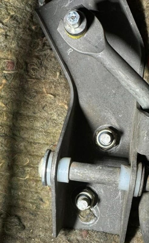

fotz 25 Posted June 6, 2024 @deankxf @Thom has anyone put an an xg pedal in an xf. I got my hands on an xg pedal and an AU v8 cable. Pretty sure the cable will just click in. I thought the XG pedal would bolt straight in as XF and XG are very similar. But the mounting bolts in the firewall are slightly off. Has anyone done this before and what’s the best way to achieve this? Share this post Link to post Share on other sites
Thom 6,710 Posted June 6, 2024 [mention=291]deankxf[/mention] [mention=43]Thom[/mention] has anyone put an an xg pedal in an xf. I got my hands on an xg pedal and an AU v8 cable. Pretty sure the cable will just click in. I thought the XG pedal would bolt straight in as XF and XG are very similar. But the mounting bolts in the firewall are slightly off. Has anyone done this before and what’s the best way to achieve this?It's not the "correct way" to do it but I've fitted one with self tappers before, if you wanted to do it a bit better than that I've used nutserts and then bolted it in Share this post Link to post Share on other sites
deankxf 21,128 Posted June 6, 2024 55 minutes ago, fotz said: @deankxf @Thom has anyone put an an xg pedal in an xf. I got my hands on an xg pedal and an AU v8 cable. Pretty sure the cable will just click in. I thought the XG pedal would bolt straight in as XF and XG are very similar. But the mounting bolts in the firewall are slightly off. Has anyone done this before and what’s the best way to achieve this? Yeah I did as Thom did and used tek screws. Nut sert or riv nuts would be preferable if you can get access to them Share this post Link to post Share on other sites
SPArKy_Dave 9,344 Posted June 7, 2024 There must be a slight difference, between the early XF mounting points, and the later XF commercials, which ran an e-series accelerator pedal? Share this post Link to post Share on other sites
fotz 25 Posted June 7, 2024 @SPArKy_Dave - yes that’s what I was thinking too. @Thom @deankxf did you use any of the existing Mounting bolts? I was thinking if redrilling or drilling a bigger whole on the pedal. Share this post Link to post Share on other sites
deankxf 21,128 Posted June 7, 2024 17 hours ago, fotz said: @SPArKy_Dave - yes that’s what I was thinking too. @Thom @deankxf did you use any of the existing Mounting bolts? I was thinking if redrilling or drilling a bigger whole on the pedal. I don't remember. Possibly one but I basically put the new one in the correct spot and sent it. It was likely a need to drive it to work the next day after the original cable kinked and I wasn't buying another if I already had one that could work Share this post Link to post Share on other sites
fotz 25 Posted June 8, 2024 I just drilled a hole out, on the bottom slightly ontop of the other one and to the left. Worked fine 1 1 deankxf and SPArKy_Dave reacted to this Share this post Link to post Share on other sites
