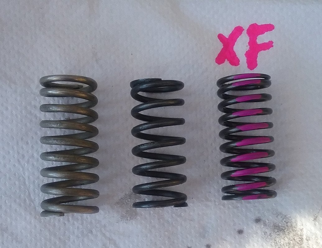

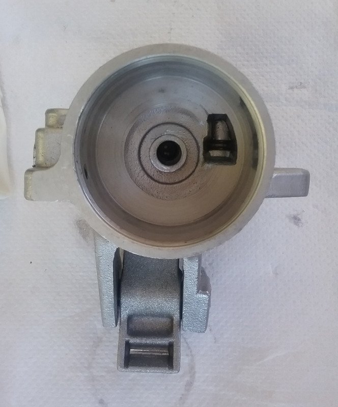

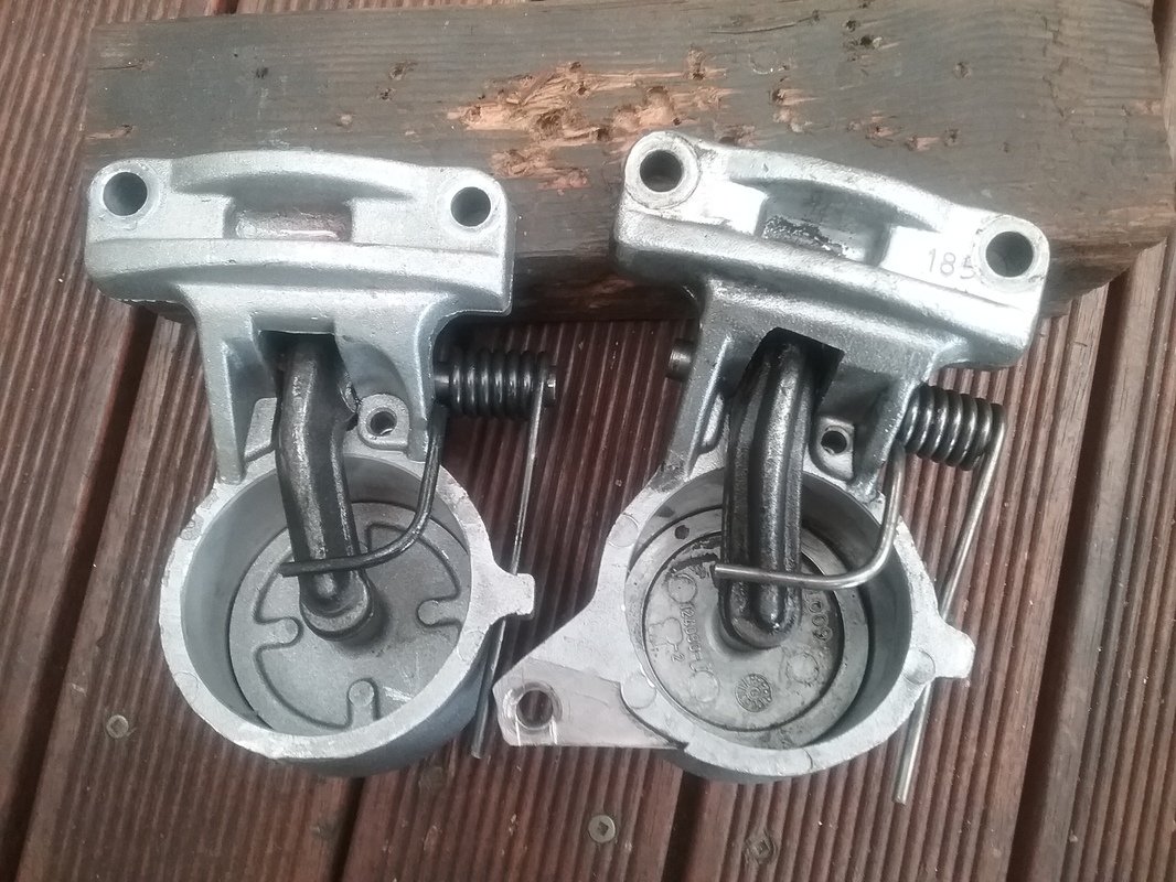

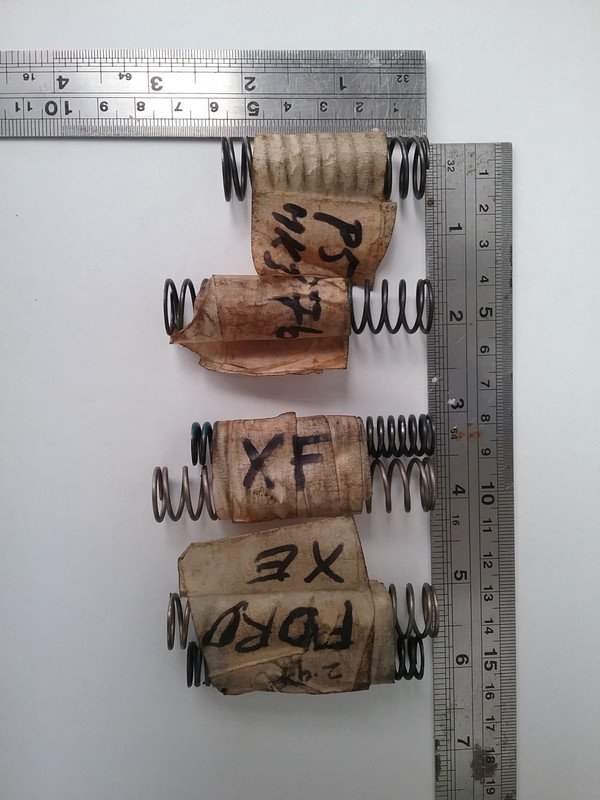

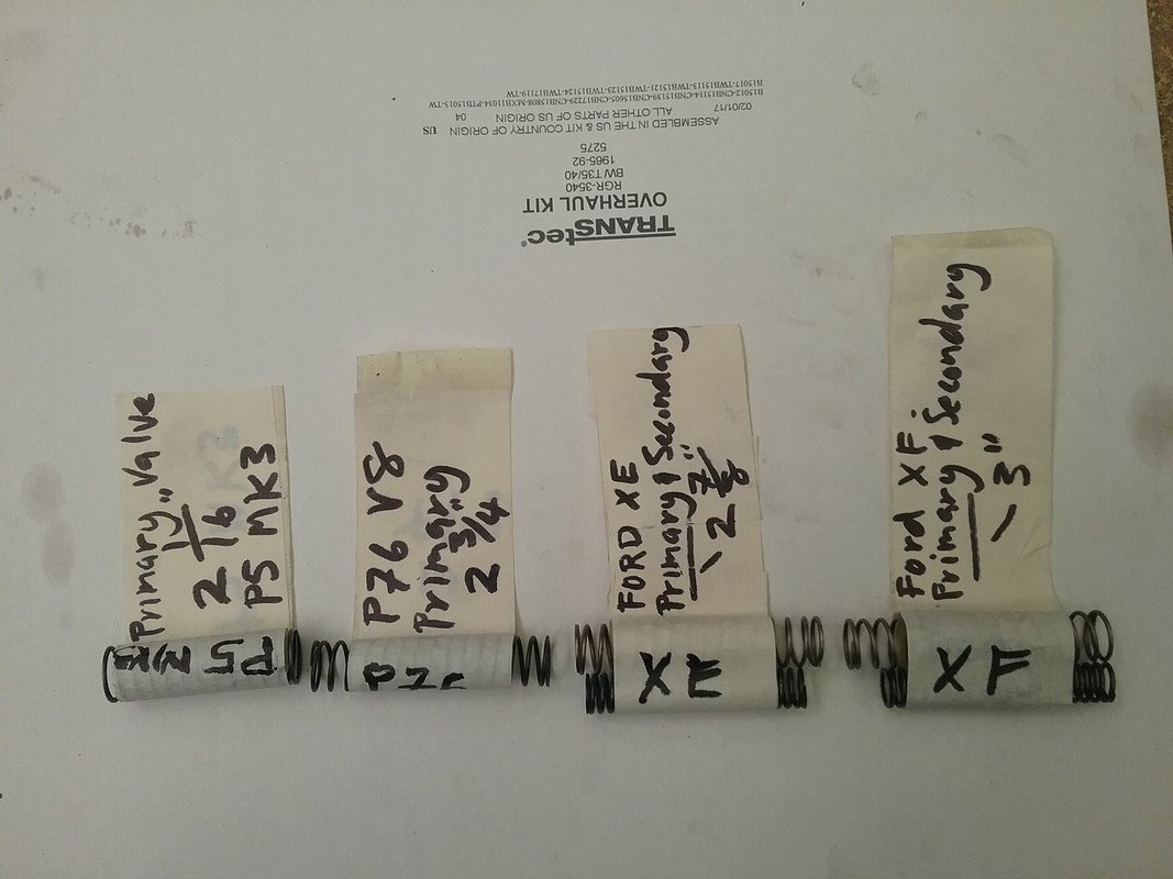

SPArKy_Dave 9,344 Posted February 15, 2021 14 hours ago, deankdx said: would have been interesting for My Dads Leyland V8 in transit van.. but he never would have spent $4000 odd. (modified his bell housing to accept a $150 used C10) The clutch-pack size/diameter will always be the limiting factor, but... among other things, to up their power handling - use the BW51 3bolt rear servo assy, (either in a BW51 case, or modify an earlier case) fit the wider bands, Fit a lighter check valve spring to the front servo, to allow faster apply/release, fit heavier springs in the primary/secondary regulator valves to up the line/clamping pressure, and if you're really keen, reinforce the case around the bell-housing attachment area. Plus use the earlier Ford F-type fluid, as it should increase the friction/clamping ability of the clutches. Merry Christmas Rear servo Front servo spring Front Servo Primary/Secondary Regulator Valve (line pressure) springs Share this post Link to post Share on other sites
