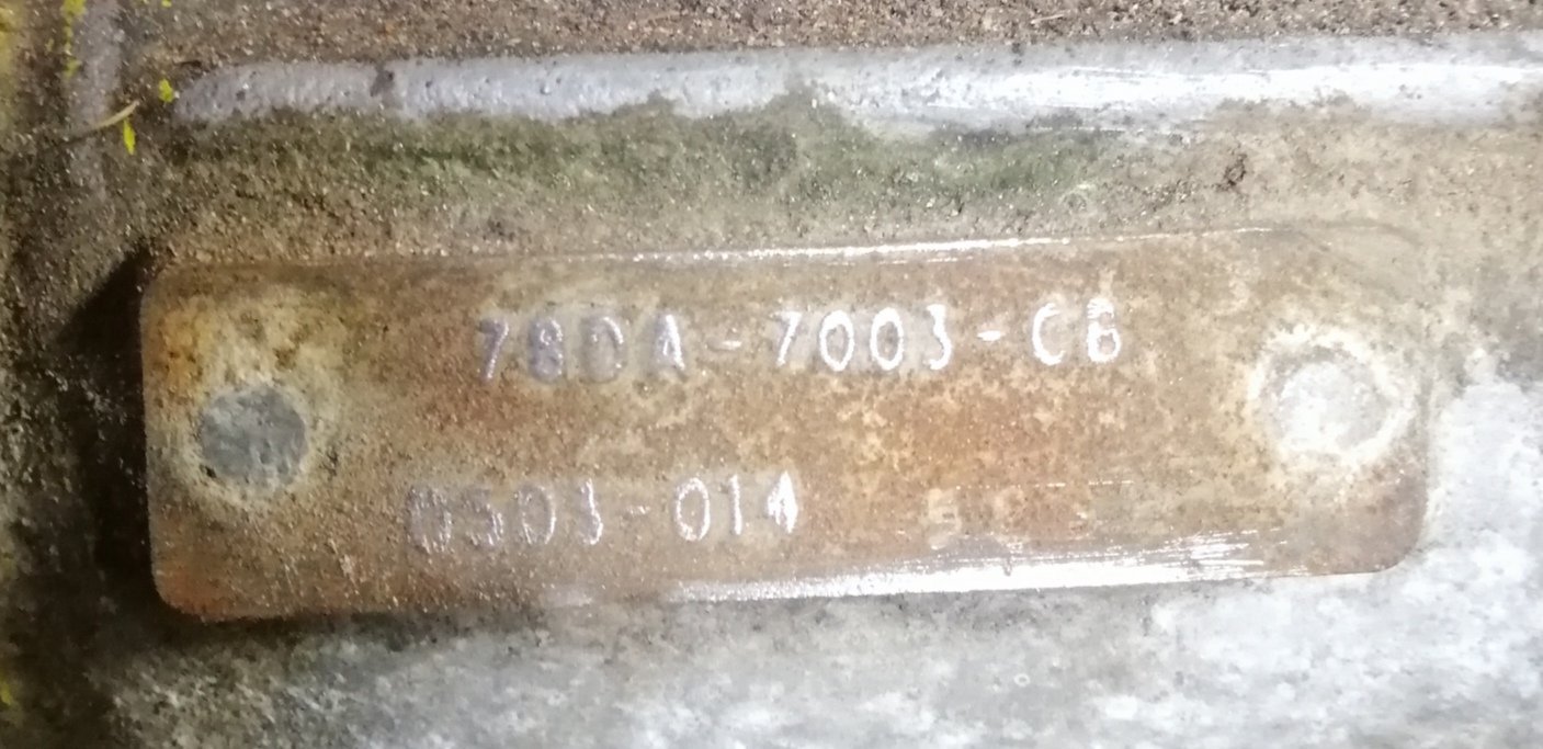

MACKAZ 26 Posted November 15, 2020 0503-014 XD single rail. I have no idea about this "shifter mod" looks standard to me Share this post Link to post Share on other sites
