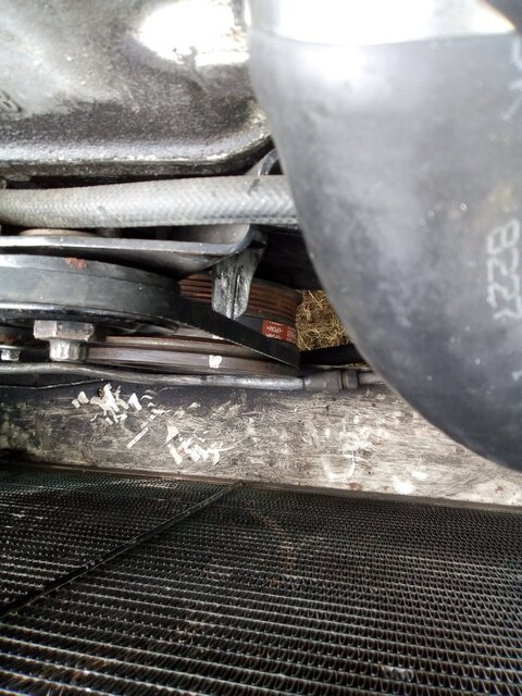

wokko 21 Report post Posted October 3, 2020 Cheers for the help and pics, this is my motor I think that timing case looks like a ef/el one ? 1 Outback Jack reacted to this Share this post Link to post Share on other sites
Outback Jack 4,813 Report post Posted October 3, 2020 Yeah, thought the timing marker was wrong. Take off the passenger side kick panel off, the ecu is there. There's a code on the back of the ecu, you have to take the mounting bracket off and turn it around. Then there's a short code starts with a number then three letters.Look up catch codes for ford 4L ecus or ask me here.If its an ED/XG ecu and an EL timing cover you may have to do a lil improvising but I can help. It could be a later motor as the code on the front is 95DA which sounds like EF/EL, hence the single timing mark which would be TDC.Also I see your PCV valve hose is not connected, it should be on a hose running to the throttle body.Let me know how you go, I'm in my shed fixing my window winder. Sent from my S21 using Tapatalk Share this post Link to post Share on other sites

Outback Jack 4,813 Report post Posted October 3, 2020 OK your ecu is for a 93 XG auto ute.That's OK. Now we know. The base timing for EF/EL is 0 degrees or TDC. On XG base timing is 10 degrees BTDC which you have no timing mark for because some Muppet forgot to change the timing covers over.What you need really is a timing light that can advance degrees, if you got one or got a mate who's got one, grab it.Then all you do is get the timing marks lined up, then wind in 10 degrees advance on the timing light, and move the dizzy till the timing marks match up again. With a normal timing light its a bit harder, but not impossible. The XG's 10 degree advanced mark is 15mm to the left of TDC as you look at the motor.Now assuming the crank pulleys are the same, make a mark 15mm to the left of your timing marker on the cover and that should be 10 degrees BTDC. Later you could look for an EL auto ecu and just time it straight up from the normal marker but because your ute has no smartlock it would need a j3 chip to run it. I would just stick with what you have and make a new timing mark on the timing cover with a white marker. That should get you running. Sent from my S21 using Tapatalk Share this post Link to post Share on other sites

wokko 21 Report post Posted October 3, 2020 It doesn't want to run probably I think I will pull timing cover /harmonic balancer off and realign and remark the balancer as I don't think that mark is correct ? that pcv valve is no good and waiting for one to come in the mail this week 1 Outback Jack reacted to this Share this post Link to post Share on other sites
Outback Jack 4,813 Report post Posted October 3, 2020 Just check your not 180 degrees out mate, its easy to accidently set it up on the exhaust stroke.I would pop the rocker cover off, make sure No1 is on compression stroke and both rockers should be up. If its on exhaust stroke the exhaust rocker on the left will be down.Then check your dizzy is the right spot and see if the timing marks line up, bet they don't. I bet the proper timing mark on the balancer will be pointing at about 5minutes past 12. Which is where top dead centre is on an XG. Actually, I think I know what they have done, the front pulley is XG as it runs V belts not serpentine belts like EF/EL. Try this before you do anything, and I bet it works. Put the timing with the timing light at 12 o'clock which is roughly on an XG where 10 degrees advanced is. Just make sure you look on that lower pulley for a slot that is on the inside edge, that's where an XG timing mark on the balancer is. maybe not the one they marked white. I'm on the right track now. Sent from my S21 using Tapatalk 1 Thom reacted to this Share this post Link to post Share on other sites
