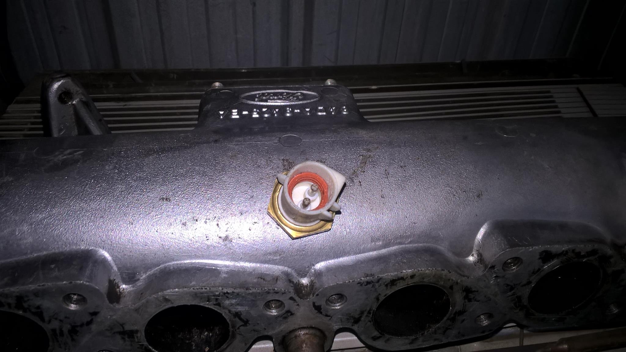

Panko 2,502 Posted June 10, 2020 Hi guys, converting my injected crossflow to run EL injection. Where should I install the Intake Air Temp sensor? In the plenum like the EL's have them, or in the intake tube before the throttle body like the XFs have (in the vane meter) Thanks Panko Share this post Link to post Share on other sites
STARK 9 Posted February 28, 2021 I went middle of plenum opposite throttle body figured air temp there would be most accurate and ea series 1 engine wiring used (engine loom separate from main ) puts plug in the right spot. 3 Panko, deankxf and Outback Jack reacted to this Share this post Link to post Share on other sites
Panko 2,502 Posted February 28, 2021 1 hour ago, STARK said: I went middle of plenum opposite throttle body figured air temp there would be most accurate and ea series 1 engine wiring used (engine loom separate from main ) puts plug in the right spot. yeah thats what I tried to do, but Fed up and did it on the top side...course didn't measure before hand, the bonnet wouldn't close with it there. when the engine comes out for the new engine to go in, ill re do it like you have. 1 deankxf reacted to this Share this post Link to post Share on other sites
STARK 9 Posted February 28, 2021 I just took it to local engineering mob with a spare sensor n mark where wanted it. Share this post Link to post Share on other sites
