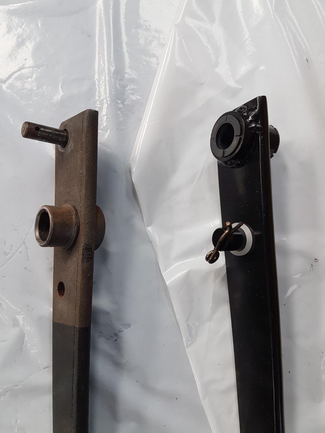

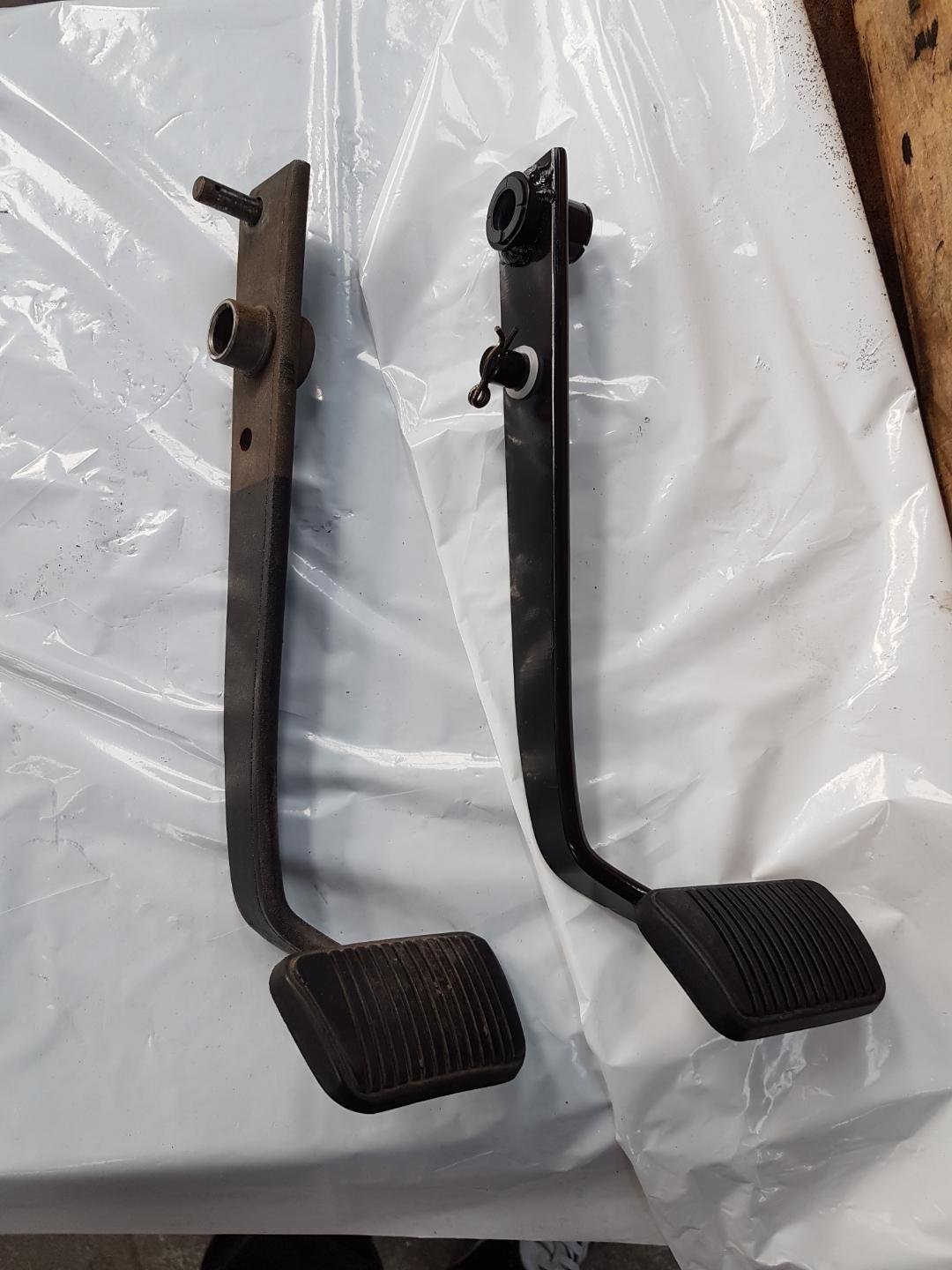

SteveXE 0 Posted August 16, 2019 14 minutes ago, CHESTNUTXE said: pictures please Share this post Link to post Share on other sites

SteveXE 0 Posted August 16, 2019 Just can't mount the pedal on. I'm not at the shop atm. But i have someone who has over 30 years experience doing it and he can't seem to get it to fit. I will see if i can ask him and get back to you. Share this post Link to post Share on other sites

deankxf 21,128 Posted August 16, 2019 5 minutes ago, SteveXE said: So what would I be doing wrong? Have you done your one? if you start with an auto pedal box it would fit easier.. i have a feeling the shaft won't fit due to the others having a flat on the shaft and you'd need to file it (the hole in the pedal box) out to round. not sure if the cable manual pedal box has the pivot in the way? might need to cut it off?(if so, i'd find an auto one, and sell the manual cable one, as they are getting rarer now due to cracking) Share this post Link to post Share on other sites
CHESTNUTXE 7,694 Posted August 16, 2019 if you start with an auto pedal box it would fit easier.. i have a feeling the shaft won't fit due to the others having a flat on the shaft and you'd need to file it (the hole in the pedal box) out to round. not sure if the cable manual pedal box has the pivot in the way? might need to cut it off?(if so, i'd find an auto one, and sell the manual cable one, as they are getting rarer now due to cracking) Yes dean this was my manual xe one you must cut and grind to fit Sent from my SM-G570Y using Tapatalk 1 deankxf reacted to this Share this post Link to post Share on other sites
