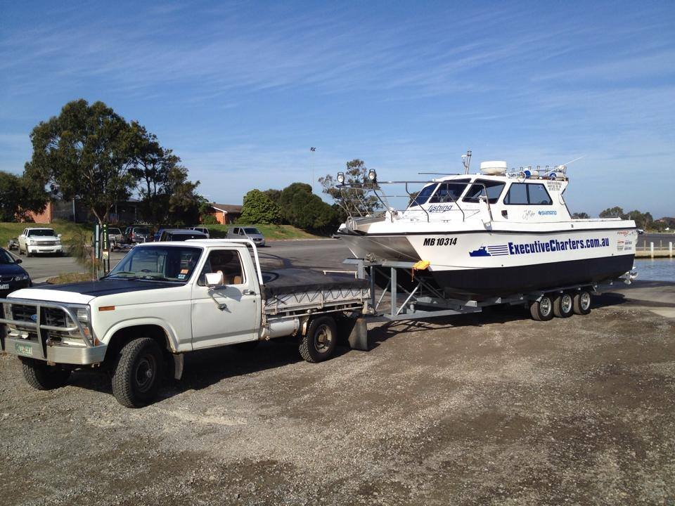

SPArKy_Dave 9,344 Posted July 28, 2024 4 hours ago, XF EDDIE said: It's geared for hauling and doesn't like going harder than 90. Honestly I'm more thinking it would be fun I think the 6cyl F-trucks had 4.56 or 5.13 gears from factory? A fellow ozfalcon member, once owned a 86' F350 4x4 351W carby, which topped out around 80km/h at 3500/4,000rpm in 4th. (see boat pic) I'd guess it had either the 4.56, 4.63 or 5.13 diff ratio in it? I remember 1st gear, did virtually nix. Any pics of your F-truck? I have a 1975 F350 dually (project), 302C 4spd and an 1986 F250 ex-ambo converted to tray, with 302W C6 auto, 3.55 diff ratio. Share this post Link to post Share on other sites
XF EDDIE 207 Posted July 28, 2024 35 minutes ago, SPArKy_Dave said: I think the 6cyl F-trucks had 4.56 or 5.13 gears from factory? A fellow ozfalcon member, once owned a 86' F350 4x4 351W carby, which topped out around 80km/h at 3500/4,000rpm in 4th. (see boat pic) I'd guess it had either the 4.56, 4.63 or 5.13 diff ratio in it? I remember 1st gear, did virtually nix. Any pics of your F-truck? I have a 1975 F350 dually (project), 302C 4spd and an 1986 F250 ex-ambo converted to tray, with 302W C6 auto, 3.55 diff ratio. I got a before pic. Ill just upload it real quick, It's a white 81 custom, looks identical to the first picture. It's a really nice ute with it not having any rust, but after side swiping a car at 80 it's a little worse for wear. I hear ya about first though, I usually started it in second. Couldn't go faster than 10kmh in first but it was neat being able to walk with it. 1 SPArKy_Dave reacted to this Share this post Link to post Share on other sites
