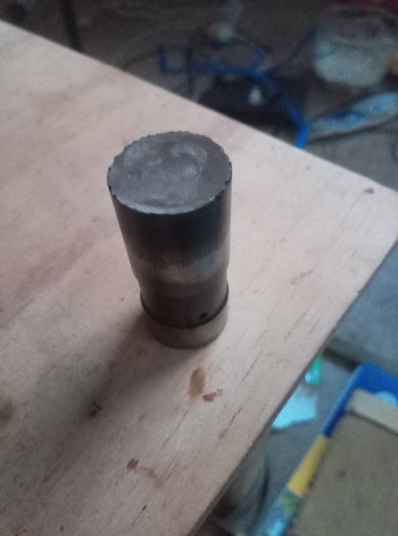

XF EDDIE 206 Posted June 13, 2024 https://cdn.discordapp.com/attachments/917722616108843009/1250710327625125888/IMG_20240613_170906_7.jpg?ex=666bee43&is=666a9cc3&hm=232b66304c5220c65780560a2aa96ec59f1f98088d784fca6f530957ac0dbef8& I think it might be cam time 1 deankxf reacted to this Share this post Link to post Share on other sites
deankxf 21,117 Posted June 13, 2024 2 hours ago, XF EDDIE said: https://cdn.discordapp.com/attachments/917722616108843009/1250710327625125888/IMG_20240613_170906_7.jpg?ex=666bee43&is=666a9cc3&hm=232b66304c5220c65780560a2aa96ec59f1f98088d784fca6f530957ac0dbef8& I think it might be cam time Yeah that looks pretty hammered Share this post Link to post Share on other sites
SPArKy_Dave 9,344 Posted June 14, 2024 How dished out is it? Grab a pic with a straight edge ruler on it? I've had worn lifters where the cam was still ok, (and actually still ran good too, but clattery). Share this post Link to post Share on other sites
XF EDDIE 206 Posted June 14, 2024 1 hour ago, SPArKy_Dave said: How dished out is it? Grab a pic with a straight edge ruler on it? I've had worn lifters where the cam was still ok, (and actually still ran good too, but clattery). It is proper fucked. The surface is about 1 mm concave and has deep scratches all going in one direction. It has a band of putting on the bottom so I'm wondering if the lifter was stuck when I first got it running and it just fucked it. I've decided to put a new (used) cam in it as I can get one for $50 and the cheapest engine near me is $300. Any pointers on how to actually do the swap? 1 SPArKy_Dave reacted to this Share this post Link to post Share on other sites
deankxf 21,117 Posted June 14, 2024 1 hour ago, XF EDDIE said: It is proper fucked. The surface is about 1 mm concave and has deep scratches all going in one direction. It has a band of putting on the bottom so I'm wondering if the lifter was stuck when I first got it running and it just fucked it. I've decided to put a new (used) cam in it as I can get one for $50 and the cheapest engine near me is $300. Any pointers on how to actually do the swap? probably find a new timing chain also, it will be sloppy most likely, a stock one will be fine. i haven't done one before, but to get the cam out with the engine in the car, you'd need to pull all the lifters out, remove the distributor, remove the air con condenser, radiator and harmonic balancer (need a puller) timing cover should come off with sump on, but might be annoying when refitting with new crank seal advised and possibly a gear puller for the timing gear on the crank(although i've got these off without a puller several times with some gentle levering with prybar/screw driver etc) cam should come out 1 SPArKy_Dave reacted to this Share this post Link to post Share on other sites
