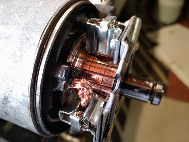

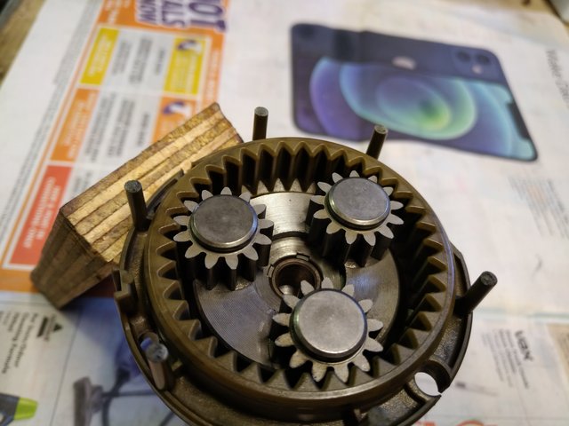

Tazvan 123 Posted May 8, 2024 This is the Xg starter that I gave a freshen up, was difficult to find brushes, but got some eventually... I had a spare, so I haven't fitted this back in yet... My Xf big starter has to be forced in because of extractor clearance, so the smaller ones are better in that respect 1 1 SPArKy_Dave and deankxf reacted to this Share this post Link to post Share on other sites

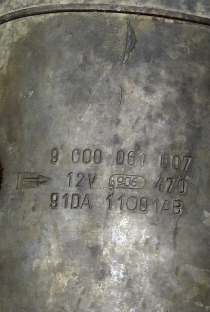

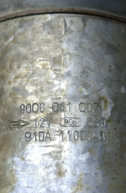

SPArKy_Dave 9,344 Posted May 9, 2024 3 hours ago, Tazvan said: This is the Xg starter that I gave a freshen up, was difficult to find brushes, but got some eventually... Where did u find new brushes? I need some for my late grandma's ED Fairmont starter. Fun fact! XG starters changed internally, from 93-95 I have one of each XG (ute/pvan), and they always had a different starter sound. I just assumed one had a non-original starter, but looked up the date-codes one day, and they're both the original bosch units. There must be a gear-reduction difference, between EB/ED (early XG) and EF (late XG) bosch starters? Share this post Link to post Share on other sites
Tazvan 123 Posted May 9, 2024 I can't be sure the XG (95 model) one was original to the car, but is definitely a Bosch one... I have 1&1/2 spare 4.0L motors here, so the spare starter is currently in the XG (also Bosch, but different number)... NAPA is where I got the brushes from...$23 1 SPArKy_Dave reacted to this Share this post Link to post Share on other sites
SPArKy_Dave 9,344 Posted May 9, 2024 41 minutes ago, Tazvan said: I can't be sure the XG (95 model) one was original to the car, but is definitely a Bosch one... Grab the 3 digit stamped date code off the body of the starters, and I can tell u when each one was made. 1 Tazvan reacted to this Share this post Link to post Share on other sites
SPArKy_Dave 9,344 Posted May 9, 2024 470 = October 1994 569 = September 1995 906 = Manufacturing Plant - Clayton, Melbourne, Australia Share this post Link to post Share on other sites
Tazvan 123 Posted May 9, 2024 49 minutes ago, SPArKy_Dave said: 470 = October 1994 569 = September 1995 906 = Manufacturing Plant - Clayton, Melbourne, Australia Thanks Dave That tells me one thing, the spare starter most likely come from the EL/EF spare, not the EA... How do you get the month's out of the number? 1 SPArKy_Dave reacted to this Share this post Link to post Share on other sites
SPArKy_Dave 9,344 Posted May 9, 2024 2 minutes ago, Tazvan said: How do you get the month's out of the number? I have a copy of the Bosch date-code schedule, going back to the 70's 1 Tazvan reacted to this Share this post Link to post Share on other sites
