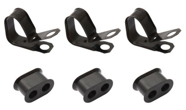

Mick.G 39 Posted September 22, 2021 Got it of a online store through E-Bay Power Steering Hose Fixed it...Thread wasn't finished properly, ran me thumbnail down the thread and it cleaned up the starting thread...installed with ease. Just waiting on these now and all done for the drive train. Share this post Link to post Share on other sites
