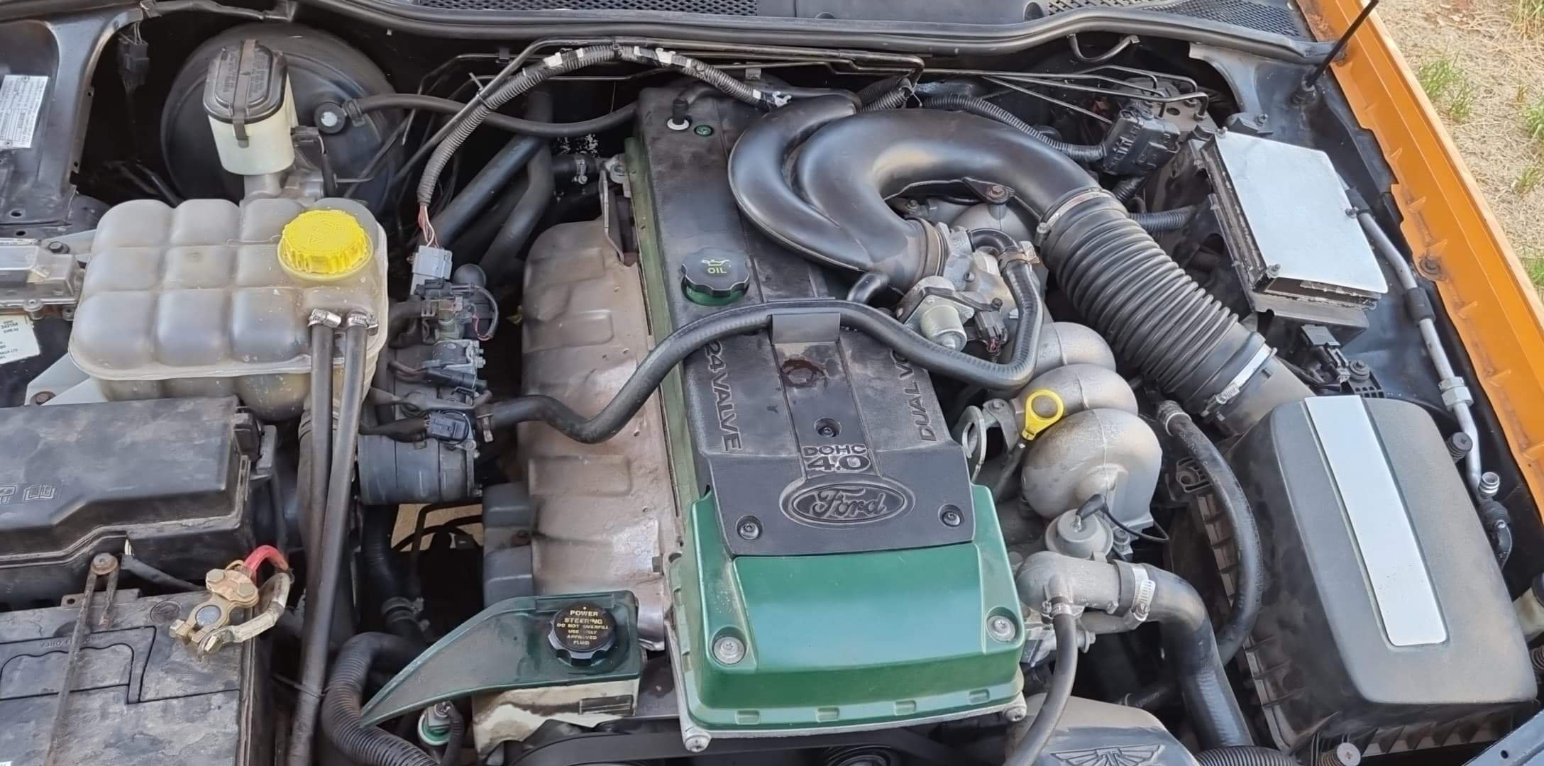

Elmakko 2 Posted February 23, 2021 not too sure what happened was driving fine put 30 in her Saturday and she died Sunday night kicks over but won't stay on there's no idle and nothing happens when I accelerate its a ba na, think it might be the converter I've got one limed up am I able to do this myself or will I need to take it to someone? Share this post Link to post Share on other sites

Elmakko 2 Posted February 28, 2021 Got the new converter in and she's doing the same thing anyone got any ideas? Share this post Link to post Share on other sites
2redrovers 21,929 Posted March 1, 2021 Other than check all connections, relays, fuses and solenoids are working properly.. I don't know enough to suggest anything specific. Share this post Link to post Share on other sites
