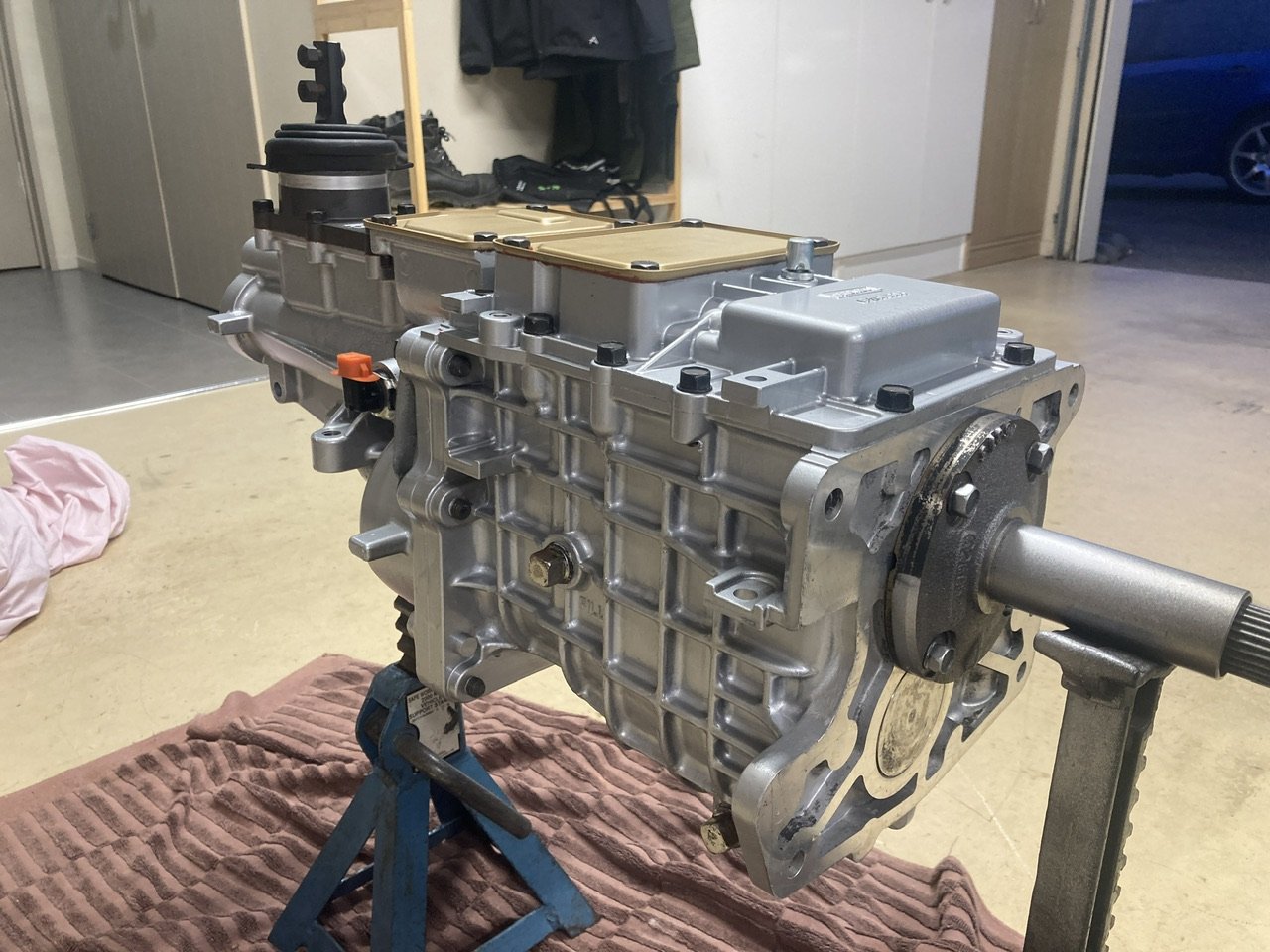

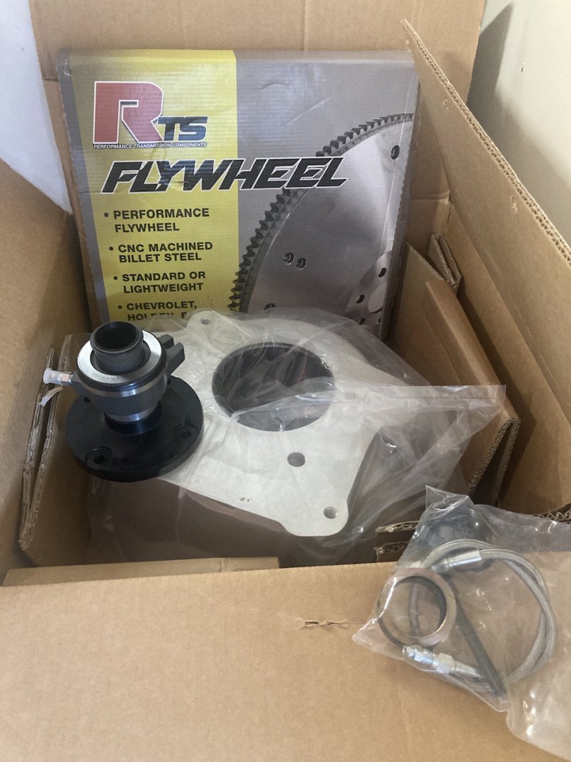

MattB5.8 0 Posted February 7, 2024 Hey falc-a-holics I’m about to convert my XE running Clevo and C4 to Clevo and Tremec TKO600 I have an RTS flywheel, Lakewood (LLK9000K) bell. Just need to know if I can use the C4 crossmember and mount as I’ve been told it should fit Appreciate your help cheers Matt Share this post Link to post Share on other sites
BGDAV 1,892 Posted February 7, 2024 im runing a t56 magnum, big case one and i had to custom make one as it sits alot further back then even the T5 mount - might just have to mock it up 1 MattB5.8 reacted to this Share this post Link to post Share on other sites
Thom 6,710 Posted February 10, 2024 I know its not in a falcon, but the TKO 600 in my dads model a uses the same trans mount as it did with a T5 the holes did have to be slotted to get the trans mount in the right spot, using a McLeod scattershield and stock length input shaft the shifter came out in the same location as the t5 shifter did 1 MattB5.8 reacted to this Share this post Link to post Share on other sites
