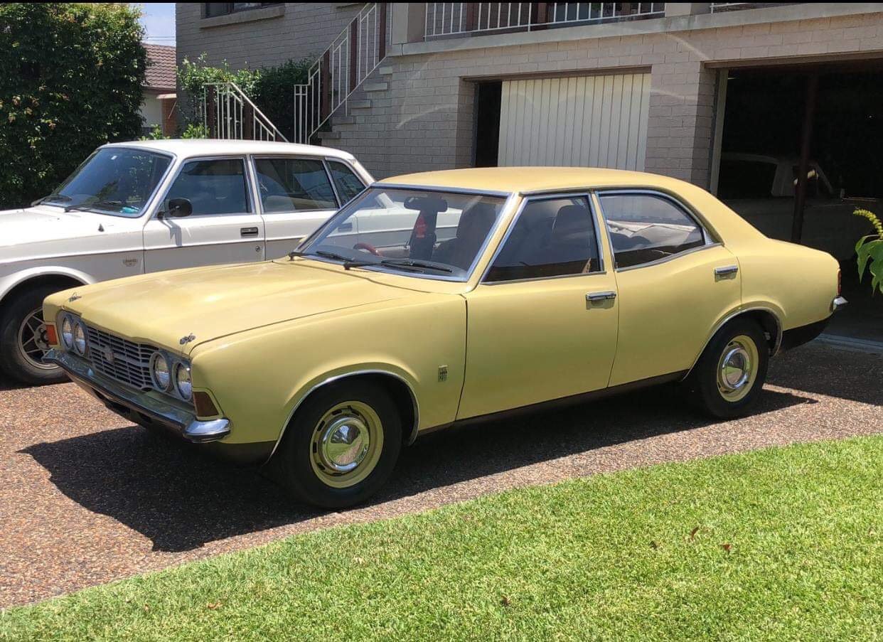

Corty74 5 Posted November 26, 2018 I have both engines or of the car so I think I’ll pull the sumps of the both of them and try the precrossflow on the 250. Will have to see if the pick ups can interchange as well I will try to find the dipstick poisition is it still on the same side of the block? It’s XL but was in reasonable shape when we found it, this is the day we brought her home. We are painting her this weekend went with the new Ford Mustang Yellow to stay with a Ford colour. 👍 2 bear351c and 351XD_Fairmont reacted to this Share this post Link to post Share on other sites
bear351c 10,602 Posted November 27, 2018 Sweet ride. Share this post Link to post Share on other sites
