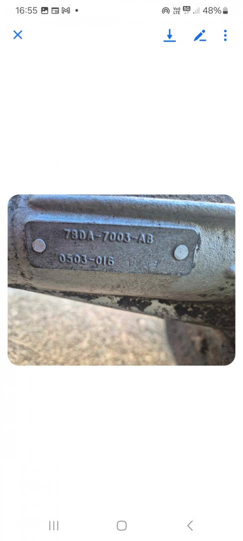

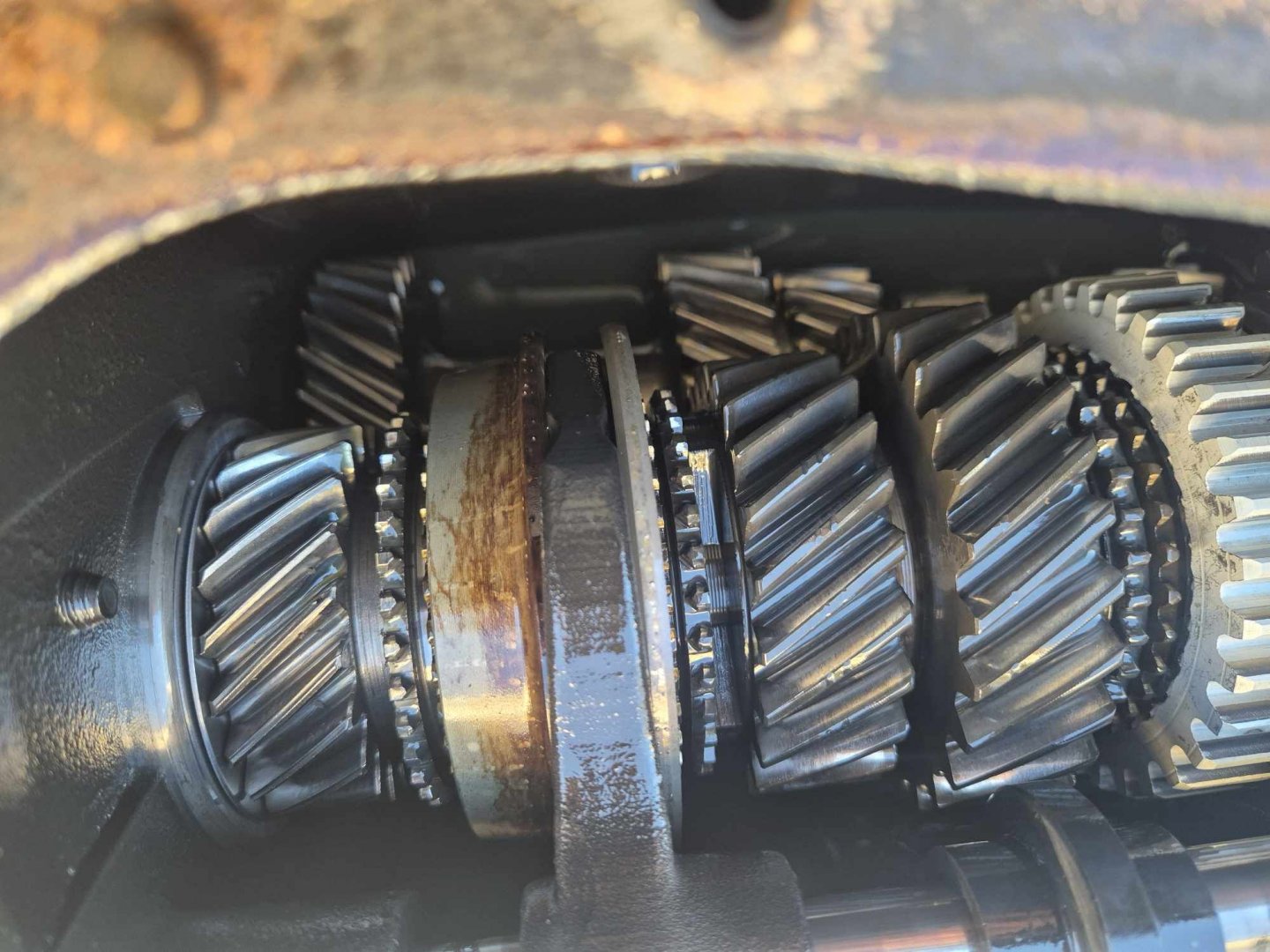

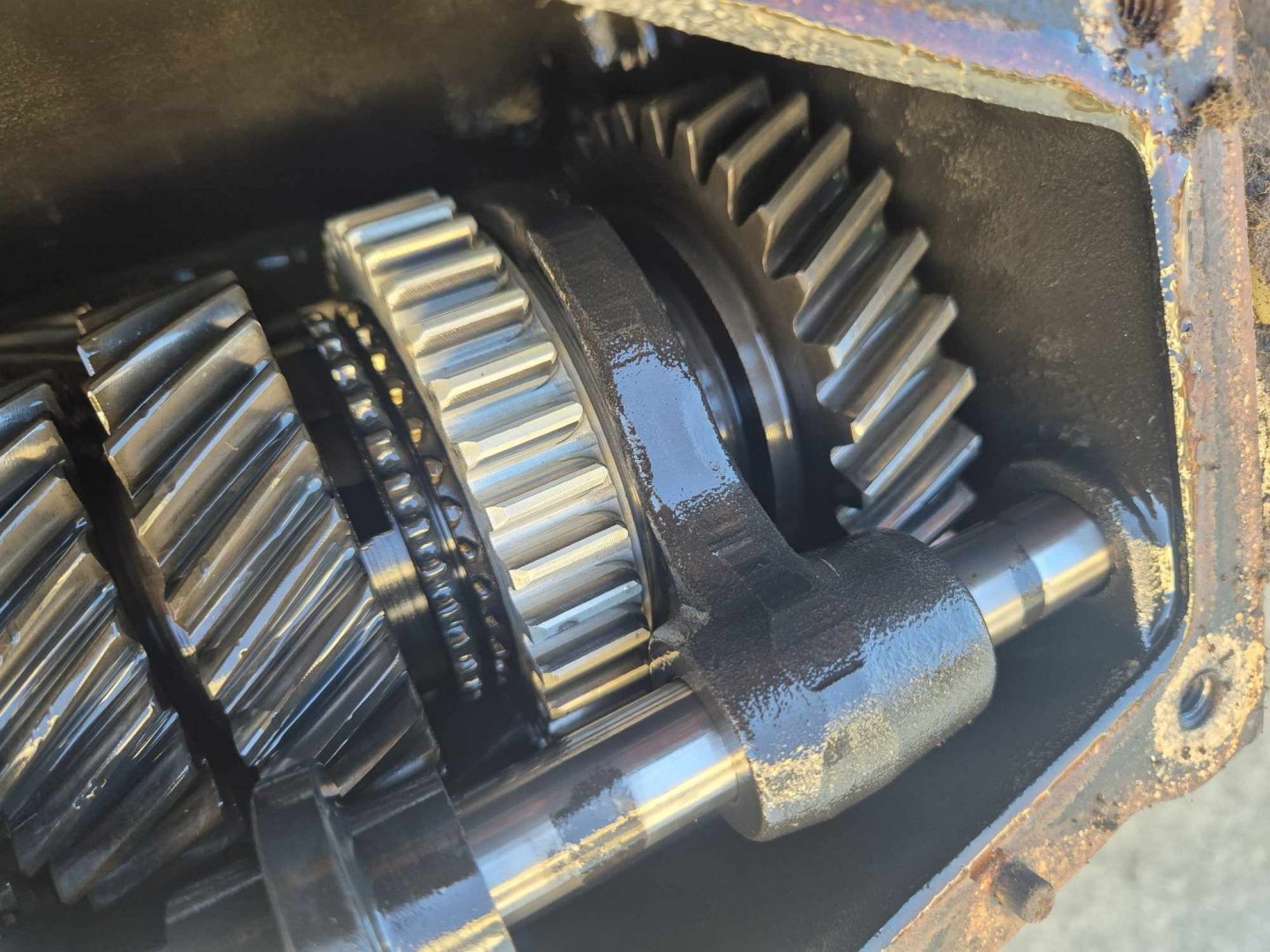

Would you mind trying to decipher my tag.
Judging by all the research I'm doing I'm hopeful the first gear ratio isn't to high as I have plans for it getting bolted behind a 351c
Seen Chestnut comments saying he had a 015 but 016 could be different all again
