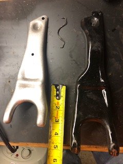

hucklburry 25 Posted November 1, 2018 Well the 65 Mustang 6cylinder clutch fork is 3" crease to end of forks. The 66 Bronco with 170 six clutch fork is 4-1/2" crease to end of forks I was told the Crossflow is 3-5/8" crease to end of forks So I think this mustang one is too short. The search continues, pic of the mustang on left, Bronco is black on the right. 1 CHESTNUTXE reacted to this Share this post Link to post Share on other sites
CHESTNUTXE 7,299 Posted November 1, 2018 those forks dont look like the one im using ,but the one i am using is very short like the gold one and has no clip in the bell to hold it in,it just pivots ,i thought it would just brake the first time i used it but nope its fine,i will try and find my other forks to check and put picture. Share this post Link to post Share on other sites
hucklburry 25 Posted November 1, 2018 I am under the impression I need this one you posted earlier like page 1: I would love a Ford part #??? 1 CHESTNUTXE reacted to this Share this post Link to post Share on other sites
CHESTNUTXE 7,299 Posted November 1, 2018 yes thats the one,out of 1973 ford xb falcon but that only suits top loader or borg warner single rail 4 speed,the 3 speed is different again,cause the bearing is different Share this post Link to post Share on other sites
