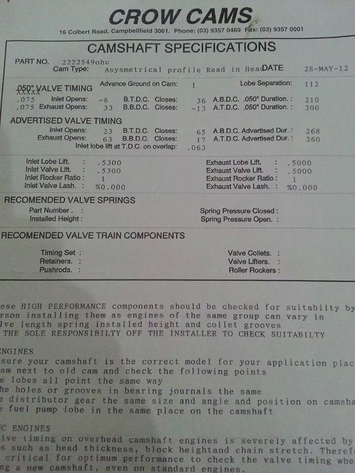

Menice 331 Posted July 10, 2014 This is the cam and it came with a vernier gear so I need to change it over as well, seems easy enough to do otherwise Share this post Link to post Share on other sites
gerg 10,871 Posted July 11, 2014 That's a pretty mild cam by the looks of it, lift seems to be the only major difference from a stock one. Kind of like a towing cam, should be a good streeter with a decent exhaust. Just don't expect it to be a screamer that's all Share this post Link to post Share on other sites
Menice 331 Posted July 11, 2014 Yeah its not over the top, I may try a bigger one down the track Share this post Link to post Share on other sites

FORD_MAN 1,026 Posted July 12, 2014 I have the same 549 grind cam for my AU sitting in my room, I'll get around to fitting it one day. can't wait to hear how yours goes. Share this post Link to post Share on other sites
Menice 331 Posted July 12, 2014 I was looking earlier at the crowcam website and the 549 for the au seems the same except total lift and rpm range, I'm still learning cams but would there be a noticeable difference in them? Share this post Link to post Share on other sites
FORD_MAN 1,026 Posted July 12, 2014 only just saw power range differance listed, but would be close to e series. lift differance is e series have 2:1 rocker ratio & AU is 1.8:1, the rest not sure Share this post Link to post Share on other sites
