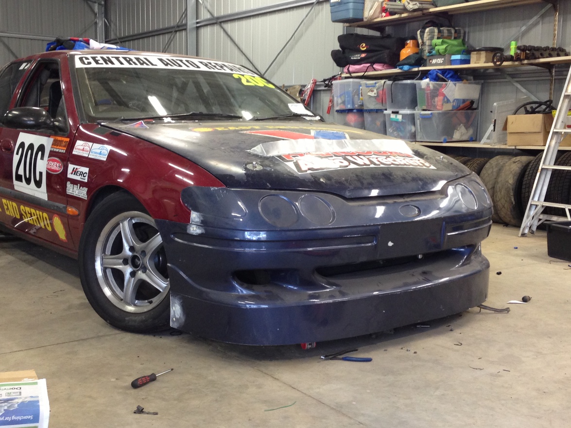

Stevemack 122 Posted August 14, 2013 Ok so i finally worked it out (Thanks Trev) hopefully This is what it looks like now. Share this post Link to post Share on other sites

Stevemack 122 Posted August 15, 2013 It's bigger when you click Trev......the picture i mean! lol Share this post Link to post Share on other sites
