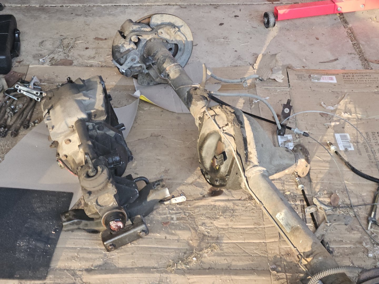

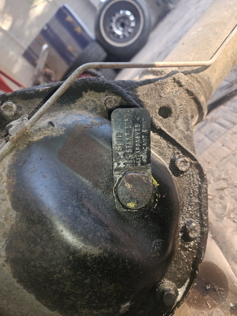

Stumps 345 Posted June 29 Pulled these out of the ute over the weekend got a nice surprize found the diff is an LSD which is handy....also discovered that I'm way too fat and old to be climbing under cars in the cold.. 1 CHESTNUTXE reacted to this Share this post Link to post Share on other sites
CHESTNUTXE 7,694 Posted June 30 disc and lsd 28 spline is choice,what ratio is it,and looks like a xg diff Share this post Link to post Share on other sites
Stumps 345 Posted June 30 8 minutes ago, CHESTNUTXE said: disc and lsd 28 spline is choice,what ratio is it,and looks like a xg diff it's a 3.27 and yes it's out of an XG. I'm trying to figure out what the T5 was from as the ute originally had a 4spd auto in it and was converted to a T5 about 10 years ago by Dellow's. The number that I have found indicated that the box is from an EB2 V8, but thats just from a google search, gunna have to drown the poor thing in degreaser to find the rest of the id numbers on it. 1 CHESTNUTXE reacted to this Share this post Link to post Share on other sites
