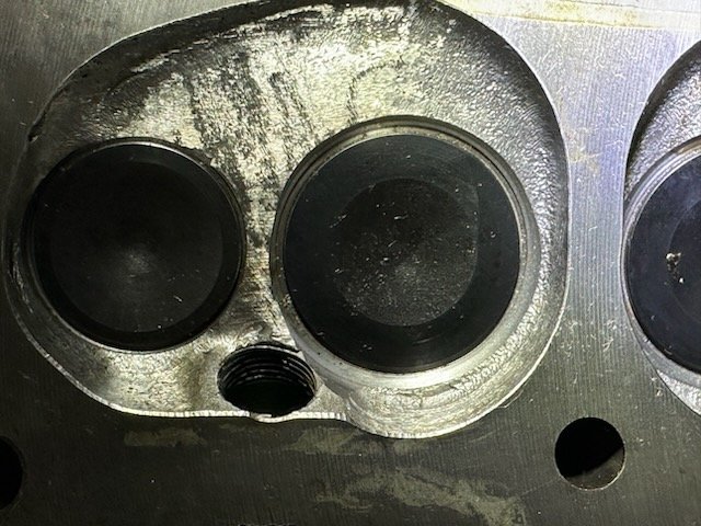

The compression is a bit mystery side of things, no real markings on the pistons other than indicating that they are 0.030 over, but they are dished. the Head itself looks like it might of had a small amount of material removed from the surface, the combustion chamber look huge and factory like. I'd imaging the compression to be between the factory 9.5:1 and 10:1.
