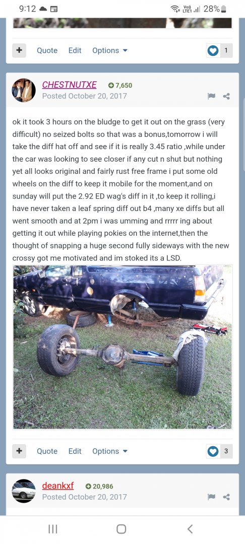

CHESTNUTXE 7,694 Posted May 27 This has been bugging me for years i always thought the 0575 gears suited older falcons but once i had a 1996 xg ute that had a lsd 3.45 diff and after i inspected it ,it had 0575 on the gearset,is it because it was a leaf spring fittment ? a EF sedan of the same year would have had the 0578 gears n housing,gets confusing,i started to notice this in xe model where the sedan diff cover says 0578 but it runs 0575 gears ? i have pulled about 20 b/w diffs apart and always get a surprise somewhere,ATM im pulling apart a 1989 xf ute diff original to the car as far as i no and first surprise is the 82da tag on it ? i thought it should have had a 88da tag as its in the EA era ,i also have another late 91 xf ute 2.92 diff and it has a 88da tag but all have the 0575 gearset ,maybe the changeover to 0578 was in EB2 ? Share this post Link to post Share on other sites
SPArKy_Dave 9,344 Posted May 27 82DA, sounds like the diff has been swapped maybe? Suss out the drum brake wheel cylinders If they're original PBR or Girlock, they have date codes on them 1 CHESTNUTXE reacted to this Share this post Link to post Share on other sites
deankxf 21,125 Posted May 27 82 DA diff would have the old style straps on the yoke i would think but these can be changed to the round EB style also.. what's it got there? i thought all 25 spline diffs would be 075 guts and 28 spline 078. but been many many years since i was quizzing diff joints 1 CHESTNUTXE reacted to this Share this post Link to post Share on other sites
Rod Racer 404 Posted May 27 075 / M75 gears sets have a 7.5" ring gear diameter, 078/M78 is 7 3/4" dia. They are NOT interchangeable and have different carriers to match. I have seen M75/075 carriers with 28 spline axles, however, these are rare. 2 deankxf and CHESTNUTXE reacted to this Share this post Link to post Share on other sites
CHESTNUTXE 7,694 Posted May 27 4 minutes ago, Rod Racer said: 075 / M75 gears sets have a 7.5" ring gear diameter, 078/M78 is 7 3/4" dia. They are NOT interchangeable and have different carriers to match. I have seen M75/075 carriers with 28 spline axles, however, these are rare. Yes that 3.45 xg diff was 28 spline and 075,when I traded the gears in at the diff shop he was quite eager to give good money for them. 1 Rod Racer reacted to this Share this post Link to post Share on other sites
CHESTNUTXE 7,694 Posted May 27 34 minutes ago, deankxf said: 82 DA diff would have the old style straps on the yoke i would think but these can be changed to the round EB style also.. what's it got there? i thought all 25 spline diffs would be 075 guts and 28 spline 078. but been many many years since i was quizzing diff joints Yep strap n bolt,89 model,my old 92 ute had round flange 2.92 drum . 1 deankxf reacted to this Share this post Link to post Share on other sites
