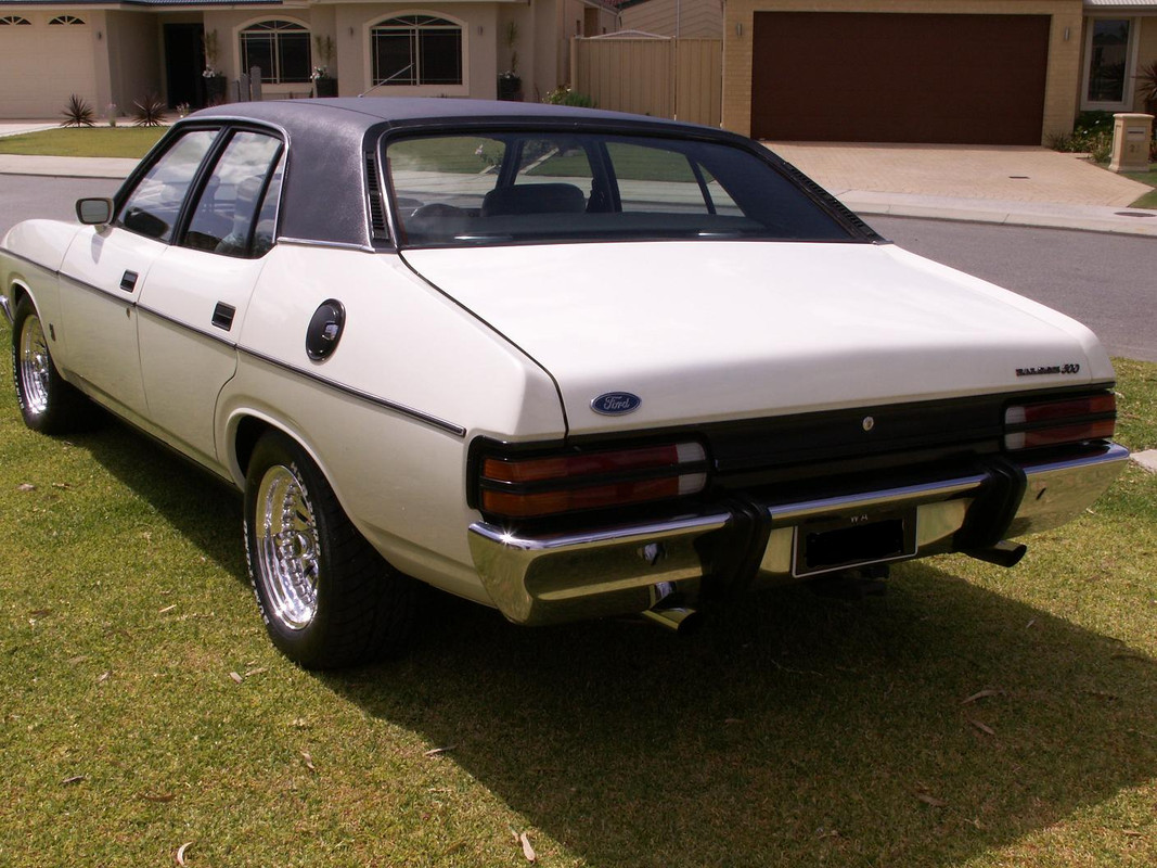

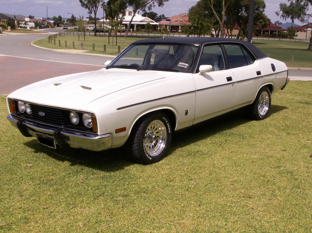

JG33 38 Posted May 21, 2025 The XC GS I owned years ago has 15x9.5 Centerlines with a 5in backspace and 265 tryres, no issues with guard rubbing. 1 2 deankxf, bear351c and Loonar reacted to this Share this post Link to post Share on other sites

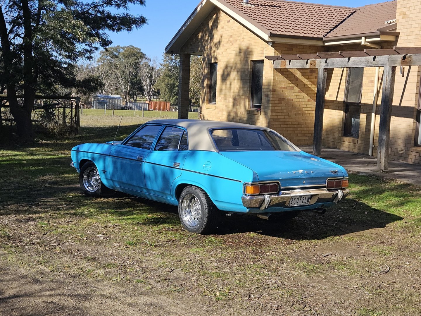

Stumps 384 Posted June 29, 2025 Just thought I'd give an update on this one, went for 15x8 and 15x9 12 slotters with 225/60 and 265/60 rubber, came out looking better than I expected. 1 2 deankxf, JG33 and bear351c reacted to this Share this post Link to post Share on other sites
bear351c 10,565 Posted June 29, 2025 Bloody beautiful car... 1 Stumps reacted to this Share this post Link to post Share on other sites
Stumps 384 Posted June 30, 2025 1 hour ago, bear351c said: Bloody beautiful car... Thanks, been looking for a colour code 5 deep aqua XB for 28 years...after I crashed the v8 futura that I had as a stoopid stoopid teenager. Wife finally let me get one, she's only a 250, but as we all know they can be made to go real hard. the Vinyl roof has slight damage on the driver side near the chrome trim, so I'm weighing up wether to remove it and get the turret cleaned up or fork over and redo the vinyl. 1 1 deankxf and bear351c reacted to this Share this post Link to post Share on other sites
