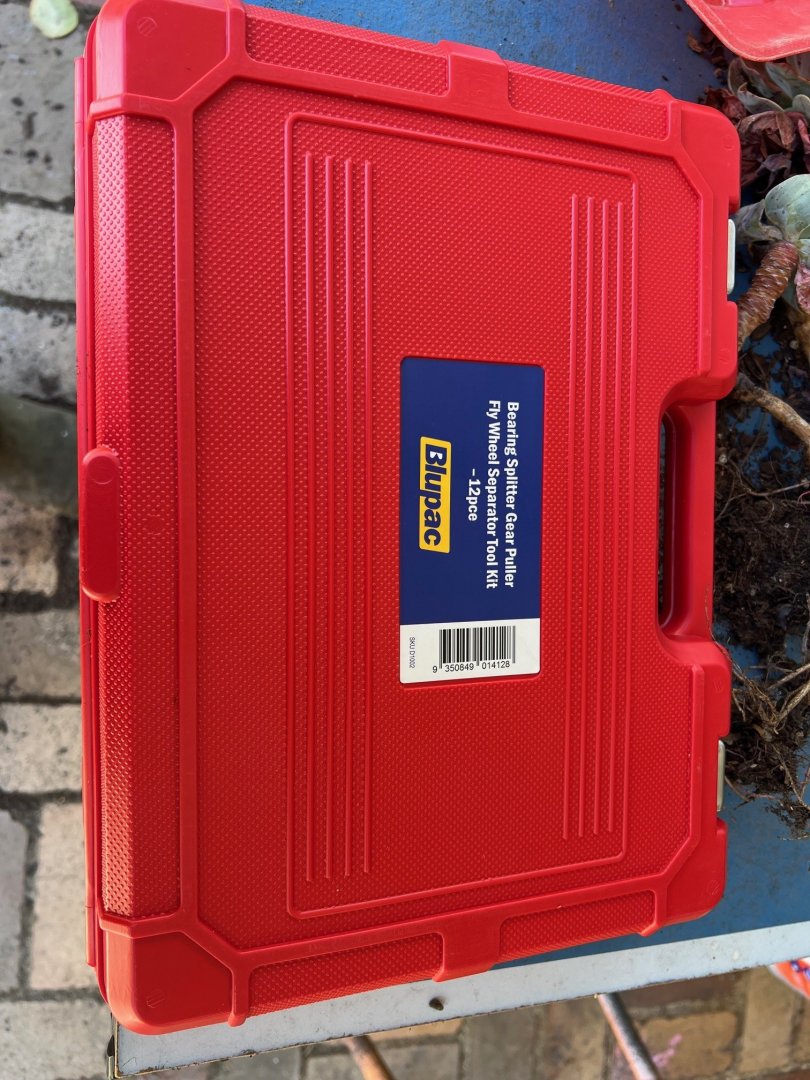

Moorabinda 168 Posted December 19, 2024 Step 8 I had one of these kits - Bearing Separator - bought from Online Auto Parts - around $45 from memory. Can't imagine having the patience to pull off that inner race without one of these kits. Made it quite easy. 1 deankxf reacted to this Share this post Link to post Share on other sites

bear351c 10,701 Posted December 19, 2024 Well explained for those who haven't done it on AU's. If you're gunna work on cars for the rest of your life, (like most of us), those bearing pullers are a worthwhile investment. I'm sure there's a torque setting for the axle nut, once you've driven it 100kays or so, might want to check its seated the bearings properly. I always plop a spoonful of grease in the cap, just to keep the stud/axle nut/threads lubed up. Nice photos. Mate had an XR6 ute years ago, flogged the sh!t out of it, wouldn't die..!! His was red, Vixen.?? anyways, nice car. 2 Moorabinda and deankxf reacted to this Share this post Link to post Share on other sites
